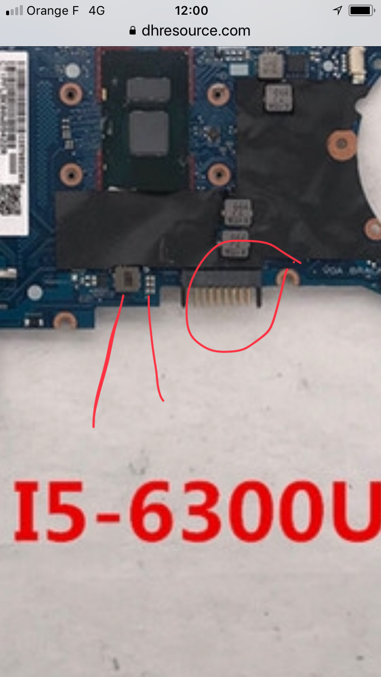

    i have problem with two same 820 g3 laptops - mobo 6050A2892301-MB-A01.
    Both have same symptom - Battery is detected,system shows charging, but wont charge nothing. Maybe it was smashed with cheap charger but i dont know.
    Interesting is, that battery is in bios/diagnostic detected...BUT is detected disconnected too.
    Have anyone idea what can be wrong?...or have anyone schematics for this mobo?
    Thank you

    Voltage on the Coil and the 3caps + the Voltage on the Battery connector 8 pins Except the ground once

      coil 5.3V, caps 5.28, connector from left 1=G, 2=G, 3=nothing, 4=nothing, 5/6=3.35V, 7/8=11.9V.
      Laptop indicates with orange led battery charging with disconnected battery too

        that Gary coil with 5.3V is not connected to the pin 7/8 of the find out which coil is connected to the pin 7/8 and test Diode mode that coil without power for the Mob, test pin 7/8 to GND +/- multimeter buzzer mode without power , pin 3/4 is DATA , CLK you should millivolts with multimeter, What is you SIO IC number and charger IC number ,test voltage in your dc jack middle pin connected with the Mob
