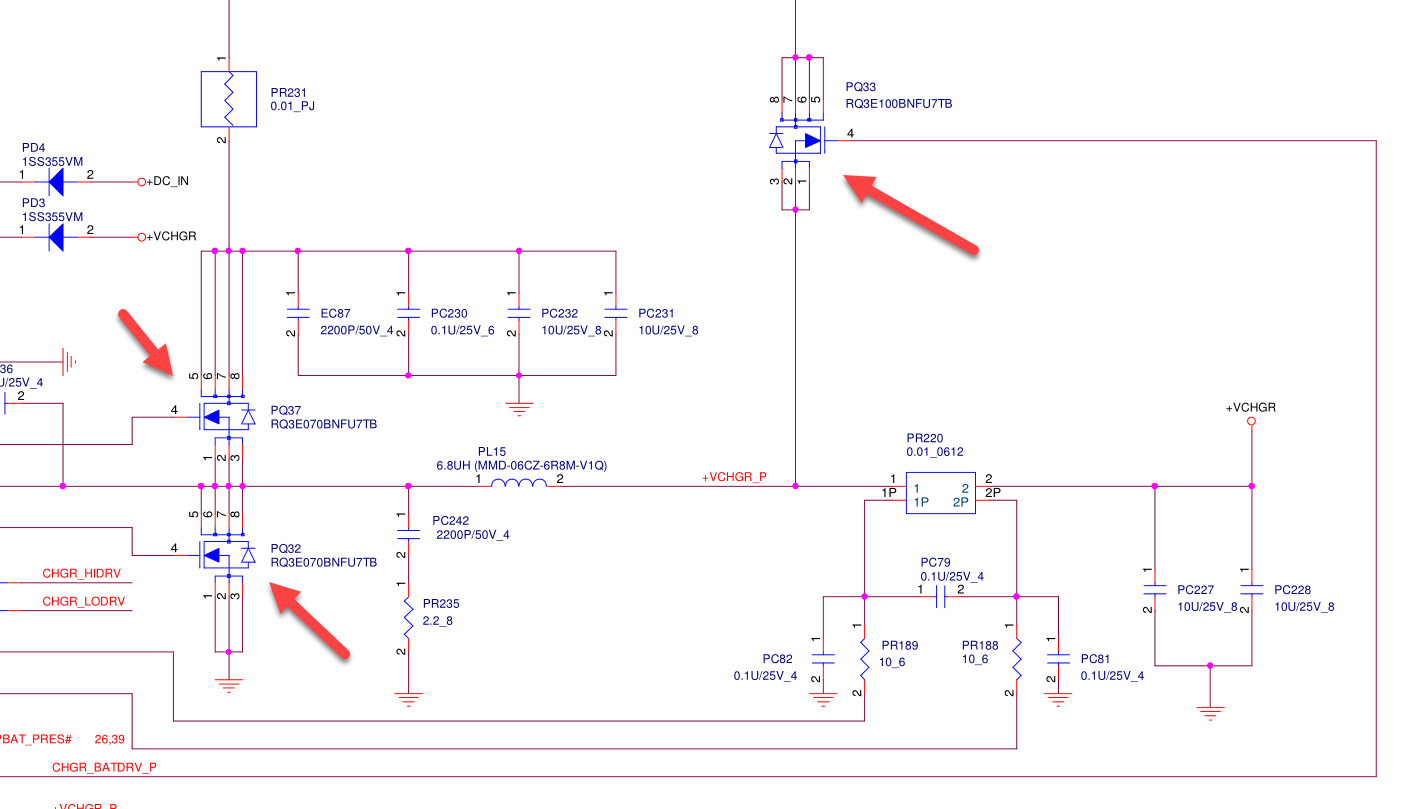

    I have a Dell 15-7559 motherboard Daam9amb8d0 which does not charge the battery.
    1. Battery is confirmed good on 2nd identical laptop
    2. Dell Charger identified in bios as 130w (Original)
    3. Battery recognized in bios Battery is performing normally
    4. Bios was updated.
    Reading on battery connector
    9 -11 = 11.12v
    8 =3.3v Checked on scope signal good
    7 = 3.3v Checked on scope signal good
    6 = 0v with battery 3v without battery. so good
    Reading on PU15 charging IC
    1-4 = 19v
    5=3.3
    6=2.7
    7-10 = 0v
    11-3.3v
    12=3.3v
    13=1.3v
    14=1.19v
    15=.32
    16=1.05v
    17-20 = 11.1v
    21=1.02v
    22=0v
    23=0v
    24=6v
    25=10.8v
    26=11v
    27=11v
    28=18v
    Any ideas

    Schematics
    • piernov
      • Jan 2016
      • 4439
      • France
      Re: Dell 15-7559 not charging, good battery
      Shorted DC in MOSFET
        Hi u mean Pq32/37?, they seem to be reading ok but |I will change them and see
          Pq40/pq41
                  Same voltage on gate (connected to ACDRV) and source (connected to CMSRC) of PQ40

                        Hello, I am having this same issue but I know the issue is the chip position labelled PQ32 literally has nothing there. Where can I source a replacement. Laptop is fell Inspiron 15 5577

                          I am facing the same problem receiving only 19v on 1-4 pn on batter done evrything replacing mosfet and resistor main charging ic not seems to working anythinng need help
                          • mon2
                            • Dec 2019
                            • 14664
                            receiving only 19v on 1-4 pn on battery
                            This is very high for the battery charge voltage.
                            Remove all power & with no battery. Meter in resistance mode (2k scale is ok).
                            Check each linked mosfet for possible damage as follows:
                            Source (1-2-3) & Drain (5-6-7-8)
                            Source (1-2-3) & Gate (4)
                            Gate (4) & Drain (5-6-7-8)
                            of mosfet @ PQ37; PQ32; PQ33.
                            Post each resistance check.
