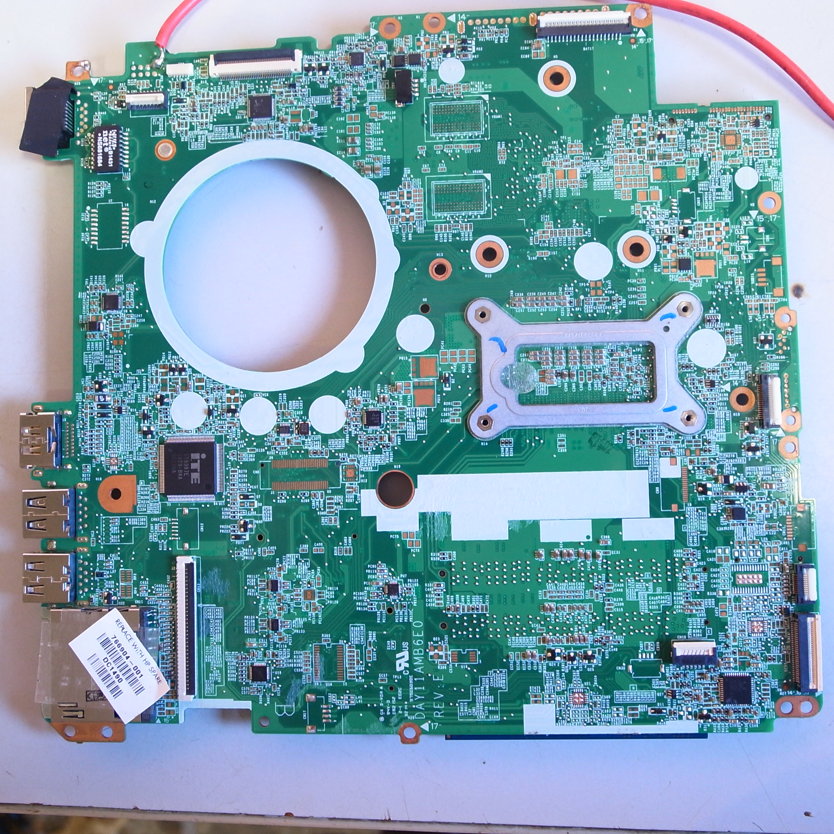

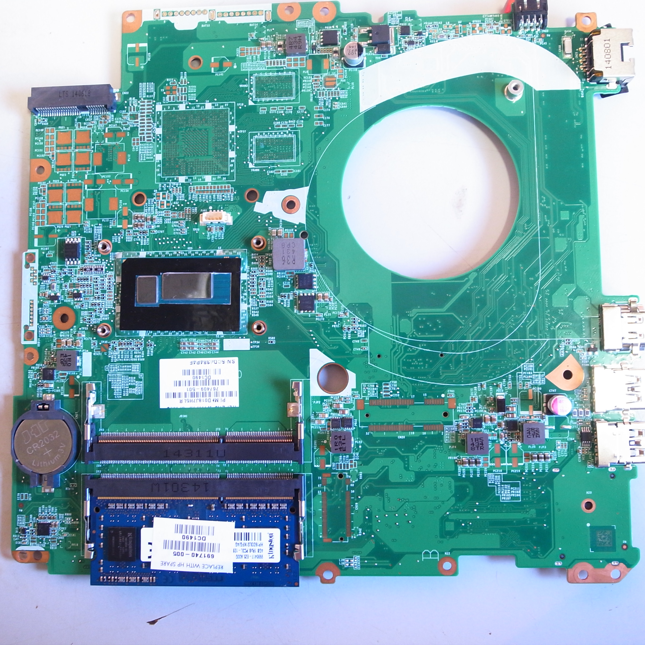

Dead no response. No lights at all. Got 3v at pwr button, But 0v at bios pin 1,8

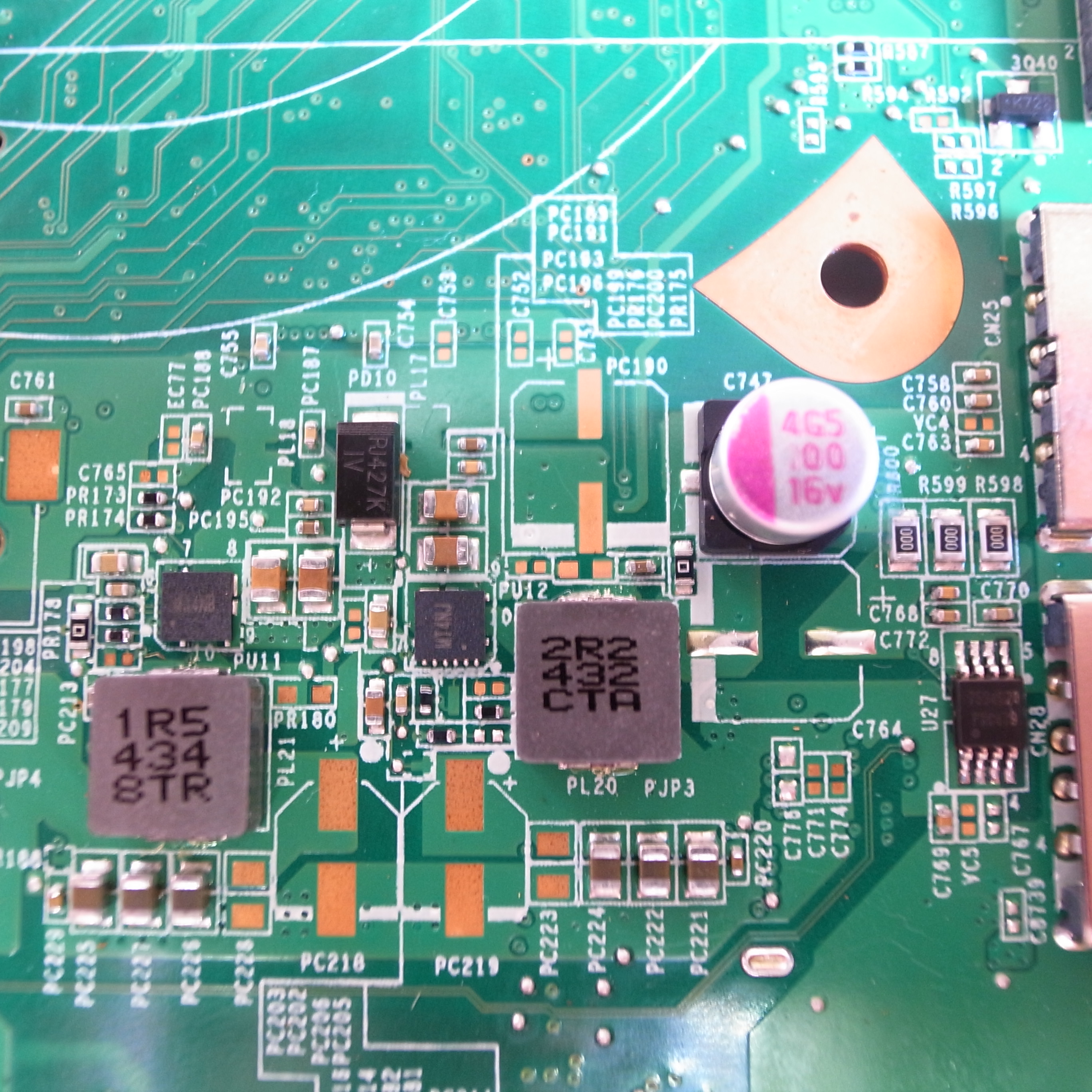

      Re: Dead no response. No lights at all. Got 3v at pwr button, But 0v at bios pin 1,8
      Check PL20 PL21 +5VS5 +3VS3 , PU11 pin 5 PU12 pin7 LDO 3/5 output Voltage & your RTC 3.3V section
        PL20 and PL21 are both 0V
        PU11 pin5 is 3.3V
        PU12 pin7 is 5V

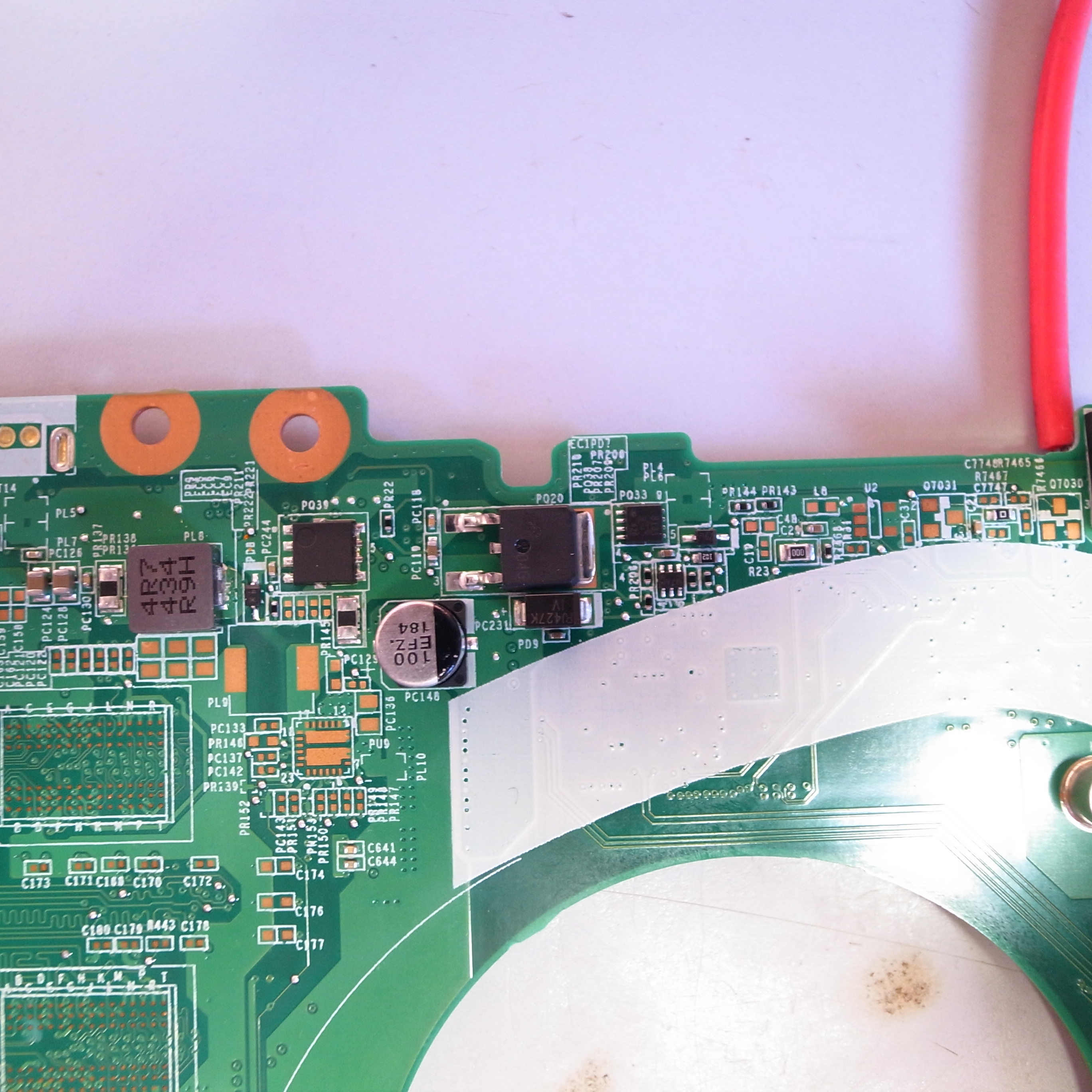

            Regarding PL20, PL21. When power is initially applied to 19v connector, they both get a quick blip of voltage for a split second, then down to 0v, almost too fast for the multimeter to show. I was able to read 2.1v at the aluminum capacitor c747 as it slowly discharges. Also, pin 8 on bios chip shows this quick blip of voltage as well.
              I checked (pu1) (bq24738H)
              pin10 looks low, but I don't know if it's supposed to be 1v when board is at idle, then 3v when board is powered on?
              pin1,2,3,20= 19.5v
              pin4= 25v
              pin5= 3v
              pin6= 2.6v
              pin8,9= 3.3v
              pin10= 1v
              pin11,12,13,18,19= 2.8v
              pin14= ground
              pin15= 0v
              pin16,17= 6v
                      PU11 pin 1 7 8 Voltage PL21 ohm ?
                      PU12 pin 1 5 8 Voltage PL20 ohm?
                            Hi techtiger, PL16 is 150ohm with or without RAM.
                            PL21 3k ohm
                            PL20 70k ohm (takes a few seconds to settle fom 130K-70Kohm)
                            PU11 Pin1 7 8
                            0V 4.5V 19.5V
                            PU12 Pin1 7 8
                            0V 5V 19.5V
                            PL20,21 are 13ohm when I accidentally checked for ohms while power supply is still on board and supplying power. And of course, there is no voltage at PL20,21. But I guess that means there is a gate to ground?

                              Pressing power button brings NBSWON1# from 3V to low state?
                              After that IT8987 should bring DNBSWON# high and give a short low pulse to cpu.
                              Cpu should respond with susb# and susc# going high.
                              IT8987 might need to be reprogrammed.

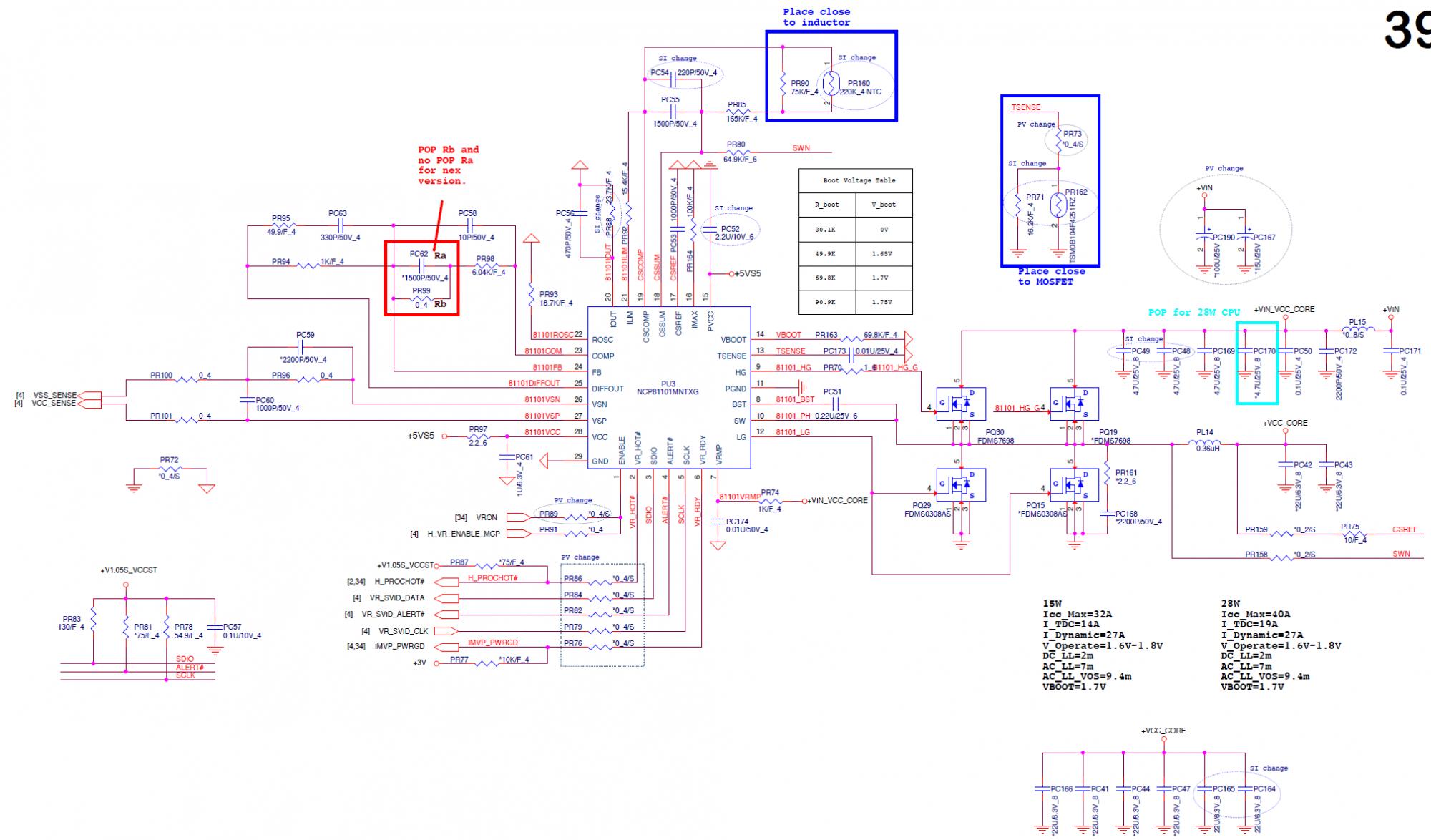

                                  PU3 (NCP81101MNTXG)
                                  PIN8 Rising and Falling Voltage. What's BST?
                                    PL14 is 110 ohms to ground.
