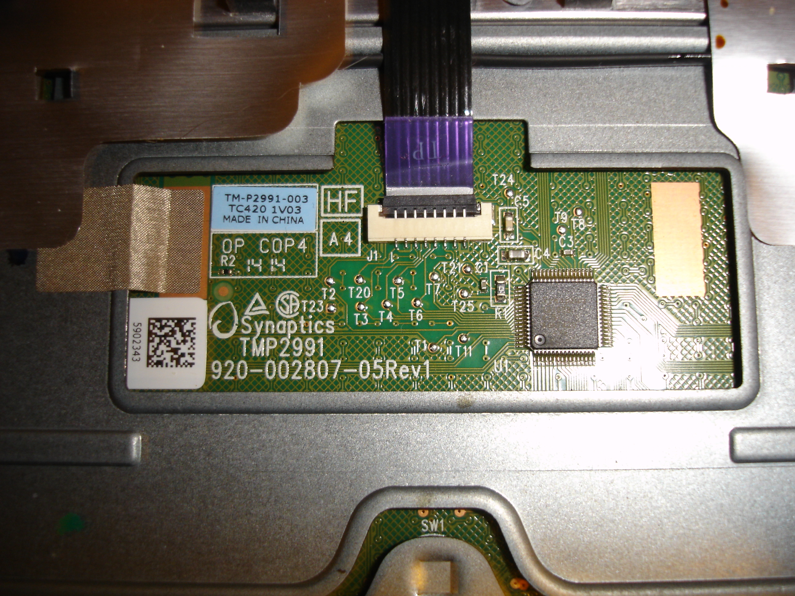

              Re: Asus x555LD touchpad not working
              The grounding tape thats used can break down over time.Solder some jumper wires
                        Originally posted by ktmmotocross
                        have spare flex. little longer but same wide.
                        grounding tape?
                        Well, i call it grounding tape.Its the fabric conductive tape in the picture above the white sticker on the left (its an acer netbook).Without that tape or a jumper wire its erratic or doesn`t work at all .Theres another large GND pad on the right where i can run a jumper wire to the surrounding metal bracket .
                          solder a wire from big ground pad to gnd of board but nothing changed
                            • 21936
                            Ok, it was worth a try .
