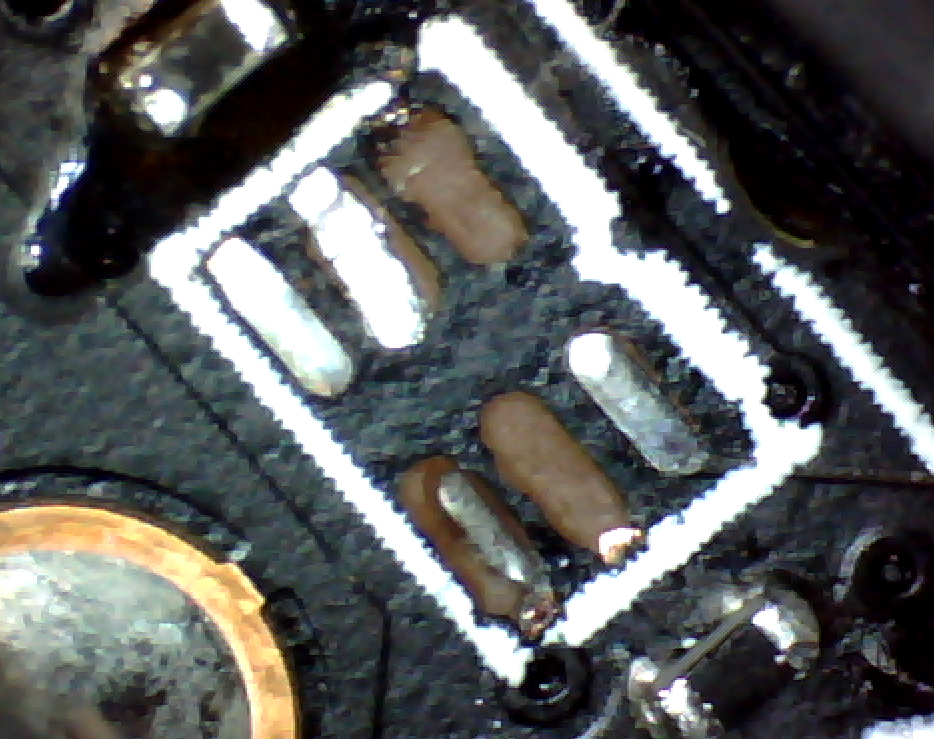

    Hello.
    Have this MSI X99A SLI PLUS gamer pc motherboard, that have ripped IC near USB 3.0 port and now its tripping usb overcurrent signal which stop board from working.
    ripped ic is 6pin package with marking
    702 4
    N
    i think it is usb controller or something because it is near every usb 3.0 port
    how to get rid of this overcurrent signal?

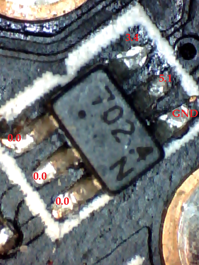

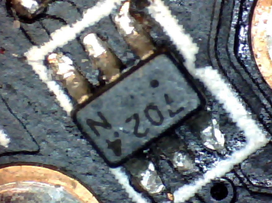

        Re: ripped IC tripping USB OVERCURRENT
        Originally posted by R_J
        Post a picture of the ic if you can, It could be a SPN7002D or MTDN7002ZHS6R dual mosfet or maybe ADG702dual cmos low voltage spdt switch
        Here is picture of another ic and picture of ripped ic
          I think this is it? 2N7002DW check the circuit to see if it makes sense.
          Here is a pdf I found, check page 25, see if this helps?

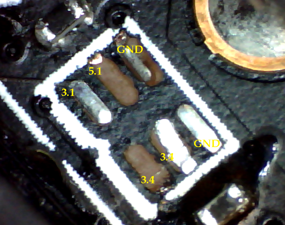

            i make some measurements on pins with and without chip
                yes it is 2N7002D but traces are gone and dont think i can remake it. anybody know what is good jumper combination between pins?
                  You need to trace the ripped trace to the closest component on that line and add a small wire from the new ic's pin to that component. It won't be easy but can be done, there are still a couple traces to secure the ic to the board
                    there are only two good pins and there are really small space around it. i must removeclr cmos switch to get on it
