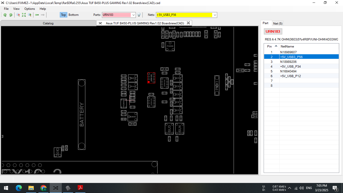

    Hello, so I got this ASUS TUF B450M-PLUS-PRO GAMING come in the shop with an issue of USB Overcurrent Issue. I already disconnect the USB connector going to the front USB port, and Check all port in the back and all are working and no short is detected,. Maybe someone can guide me how this USB Overcurrent Works because I got to boards with the same issue

      I already tried removing ESD Chip same issue, maybe this is the last option we can do, can you edit mine? I will read the back up

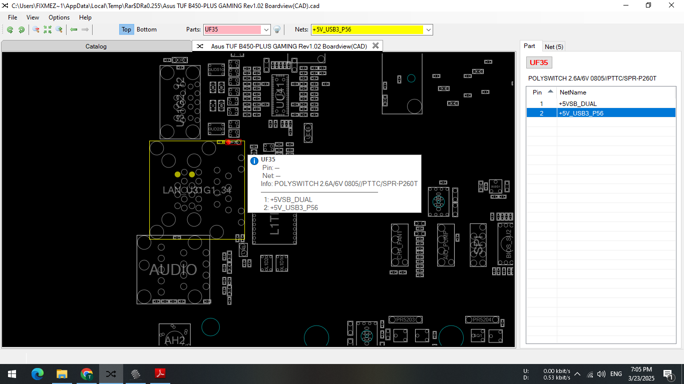

        Removing ESD diodes don't really help. The same with checking the USB OC voltage sense resistor divider network. Mine are even still on point.
        I found this problem to be specific only on Asus mobos with PCH chip that is going very hot all the time. It somehow messes up the USB OC detector inside the chip.
        ​​​​​I don't know why they keep implementing this useless feature because it simply doesn't work at all, and there are already PTC fuses installed on board that can do the protection job much better.

          there are resistors connected to the OC pin, you should check those resistor values or maybe if any of them is open.
          Last time I have this issue and found one resistor was off.
          Should be easy to fix if you have the boardview file.

            Problem Solved, just a Leak 5 pin IC causing the overcurrent to activate

              thanks for the idea I solved mine 1 of the OC measures below 3v which caused the problem, I solved the 2 units with the same IC Issue

                Mine is the 5 pin IC is leak which pull down the reading

                    Each usb port on a good design will feature a usb current limit load switch. These sot23-5 or sot23-6 parts act like solid state relays that pass through to the usb connector, VBUS pin the +5V. If the current draw by the usb device is higher than the usb load switch peak current, the switch will kill the vbus rail to this connector. A fault is reported to the usb host controller by a status pin. Often, the usb load switch dies in the process and needs to be replaced.

                              what is the ic brother .... can you show boadview

                                      this is the 5 pins IC of the board ASUS PRIME A320M-K which I used to replace the 5 pins of the 2 gaming boards I have repaired with USB Overcurrent Issue
