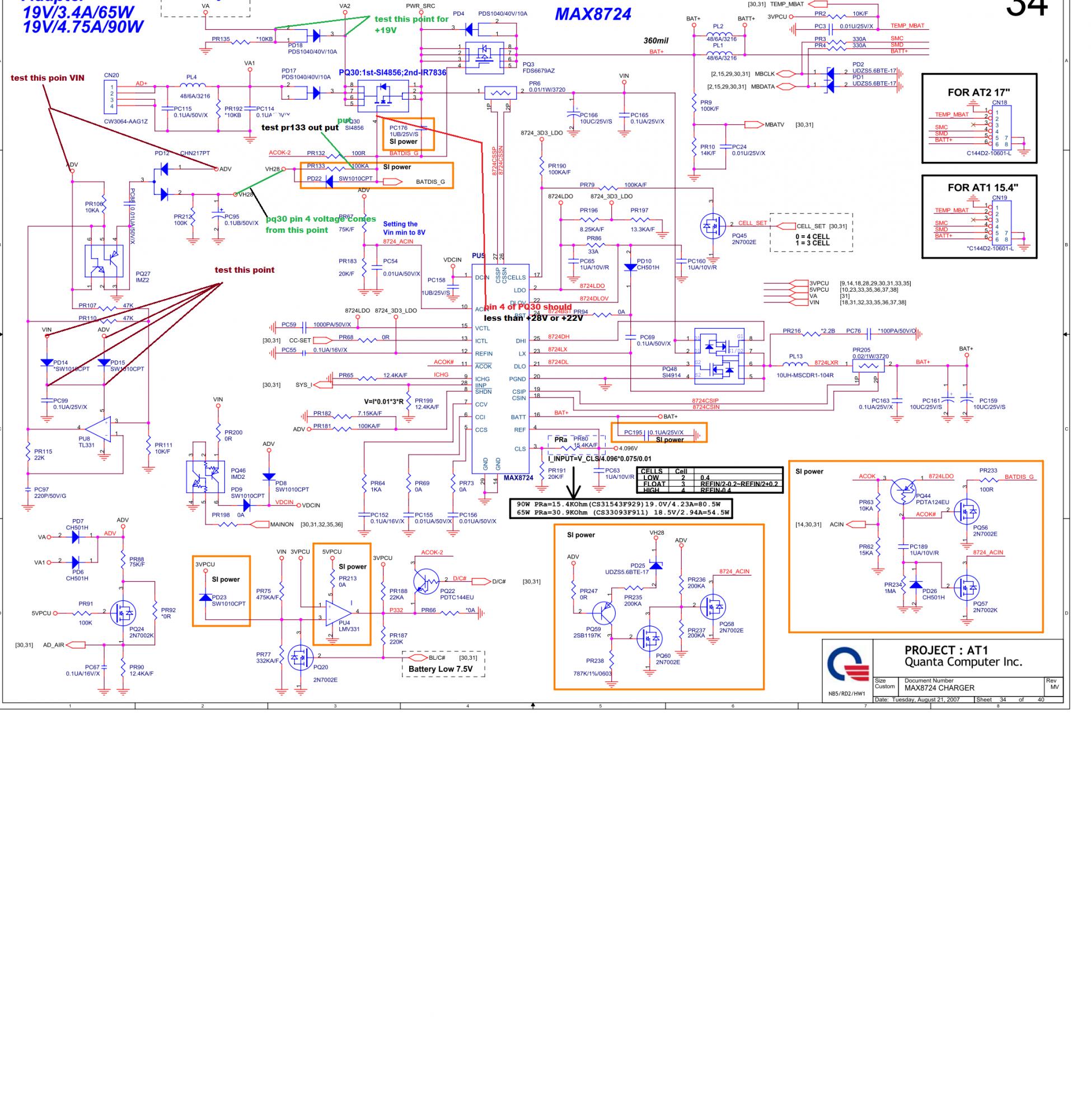

    Hello, DV6700 , dead but when i plug the adopter the light come on only, i checked mosfet pq30 pin 5.6.7.8 19v pin 1.2.3. 0v pin 4 0v, but mosfet is ok
  • Techtiger
    • Oct 2014
    • 1601
    • france
    Re: Dv6700 dead, only adopter light in on
    Check PU1 pin 1.10 for Voltage ? PQ31 pin3 ?
    May be the Fet number is not correct upload the Schematic

      • hispeck
        • Aug 2015
        • 258
        • nigeria
        Here is schematic, thanks for your help
            test all this voltages

                  yes, max8724 is the chargilng ic for this laptop, meanwhile on this board i found this components short ..[ pu8 TL331 ] and pq27 IMZ2, i dont have exact numbers , which one can i use as replacement ? IMZ2 is shoted all the legs
                    i test pr133 one end is 17v and 0.05v same with PD22 17v and 0.05v
                      PU8 is the Operational Amplifier remove PQ27 with out power test shot to GND all legs if still short you’re have 5 resistance & 3 caps to test in this circuit may be one of the caps bad
                        Test PR133 May be its bad but the 17V is not enough to the Gate of PQ30
                            PU8 is the Operational Amplifier remove PQ27 with out power test shot to GND all legs if still short you're have 5 resistance & 3 caps to test in this circuit may be one of the caps bad
                            I already removed pq27 there was no short on board, when i tested outside circuits still shorting
                              pr133 value is 100k, with my DM i get 99.89k
                                ok then the out put side is short that's why no out put for PQ30 pin 4 , test pc176 pr132 & PQ56 PR233(BATDIS G)
                                VH28 = 28V only 17V at this point
                                  So what should i do?
                                  may be some one else can help i cannot find out in Schematic from where that 28V come in

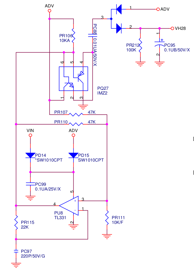

                                  • piernov
                                    • Jan 2016
                                    • 4435
                                    • France
                                    I think it's this section that's acting as a charge pump.
                                    Not exactly sure how it works but I think the opamp circuitry around PU8 is an astable multivibrator and PQ27 is some sort of "buffer" to charge/discharge the capacitor PC88 and not affect the characteristics of the astable multivibrator.
                                    This just creates an oscillator for the charge pump (centered around PD12, the dual diode on top right, I cut the markings in the screenshot…) to work
                                    • Techtiger
                                      • Oct 2014
                                      • 1601
                                      • france
                                      Thanks piernov for the explanation i thought PU8 was a Operational Amplifier.
                                      HISPECK the curcit you must get rid of the short
                                        Remove PQ22 and then check pq30 gate (pin#4) voltage?
                                        And also check voltage on PD8 on both side..
