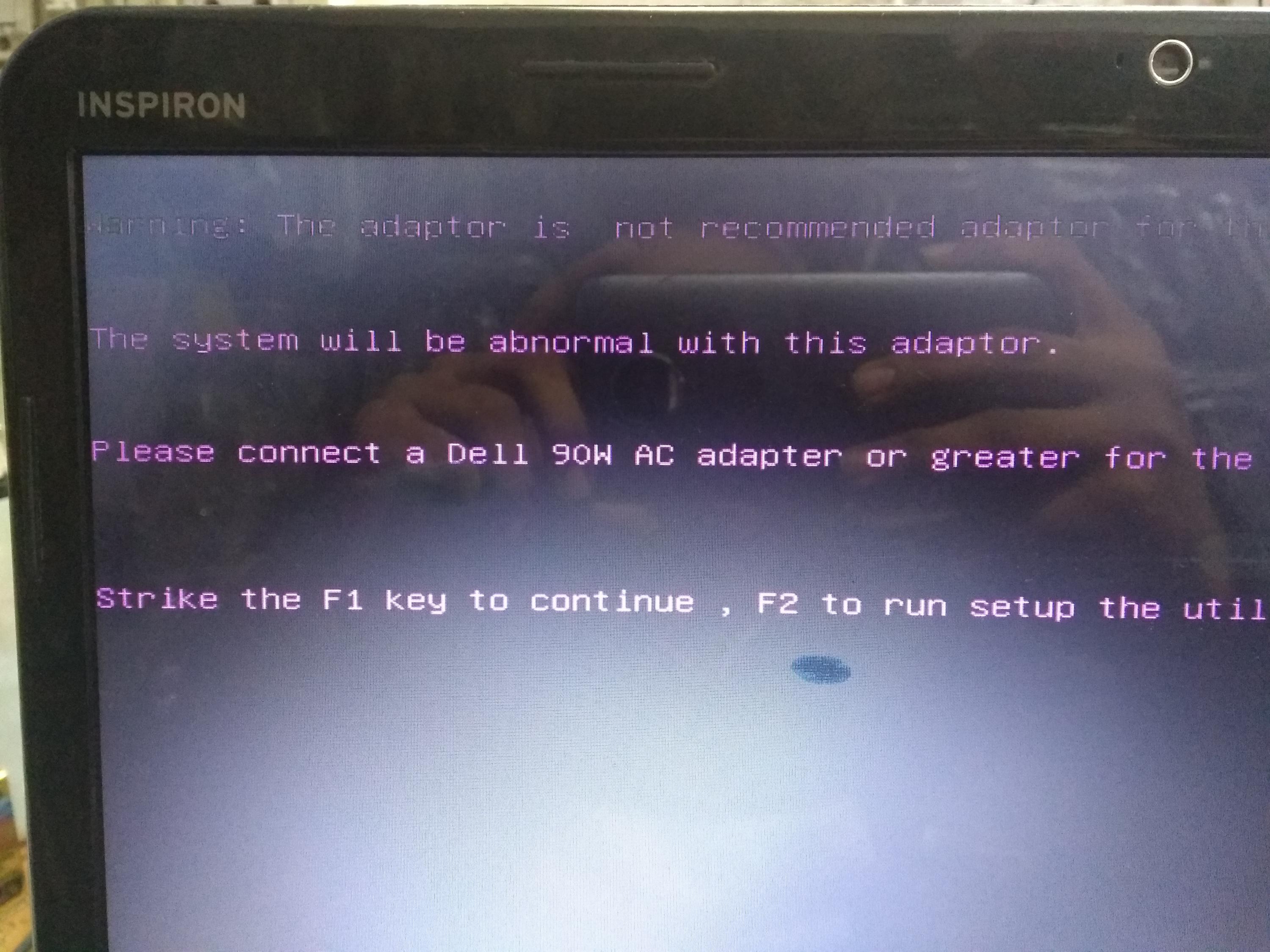

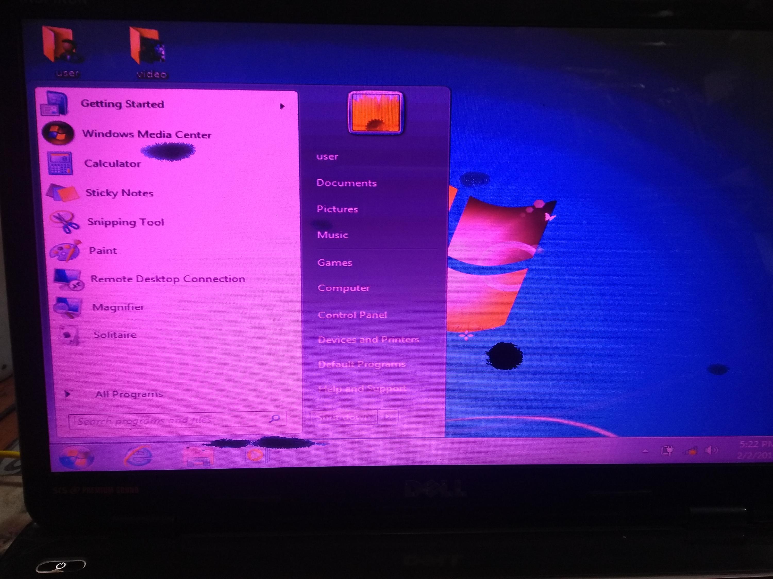

N5010 colour issue after conversion
  • pratyush
    • Sep 2018
    • 69
    • India
    Facing orange colour issue on screen after conversion discrete to uma..what will be possible solution..

    Re: N5010 colour issue after conversion
    very likely PCH faulty if those RN connected to lvds connectors are ok and connector itself is not damaged.
    • ktmmotocross
      Boardkiller
      • Feb 2014
      • 3628
      • slovakia
      do u know that display is 100% ok? looks like there are many issues on it
        • 22021
        Pressure marks on screen,replace it. test on hdmi .
          Screen nd display cable already checked...
          • pratyush
            • Sep 2018
            • 69
            • India
            I checked for RN connector rn7701 which seems to be for colour that is okk...
            Plzz mention other rn connector that should be checked...if possible
            • ktmmotocross
              Boardkiller
              • Feb 2014
              • 3628
              • slovakia
              try to heat up UMA to 130c to check broken ball
