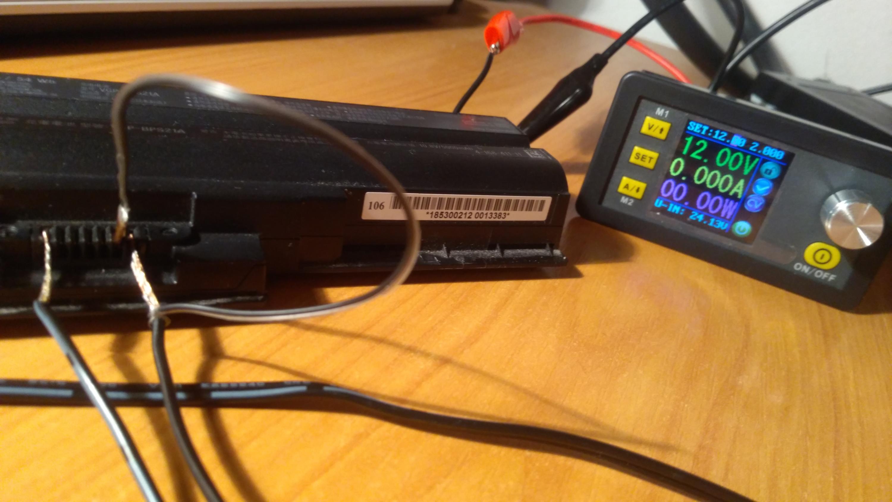

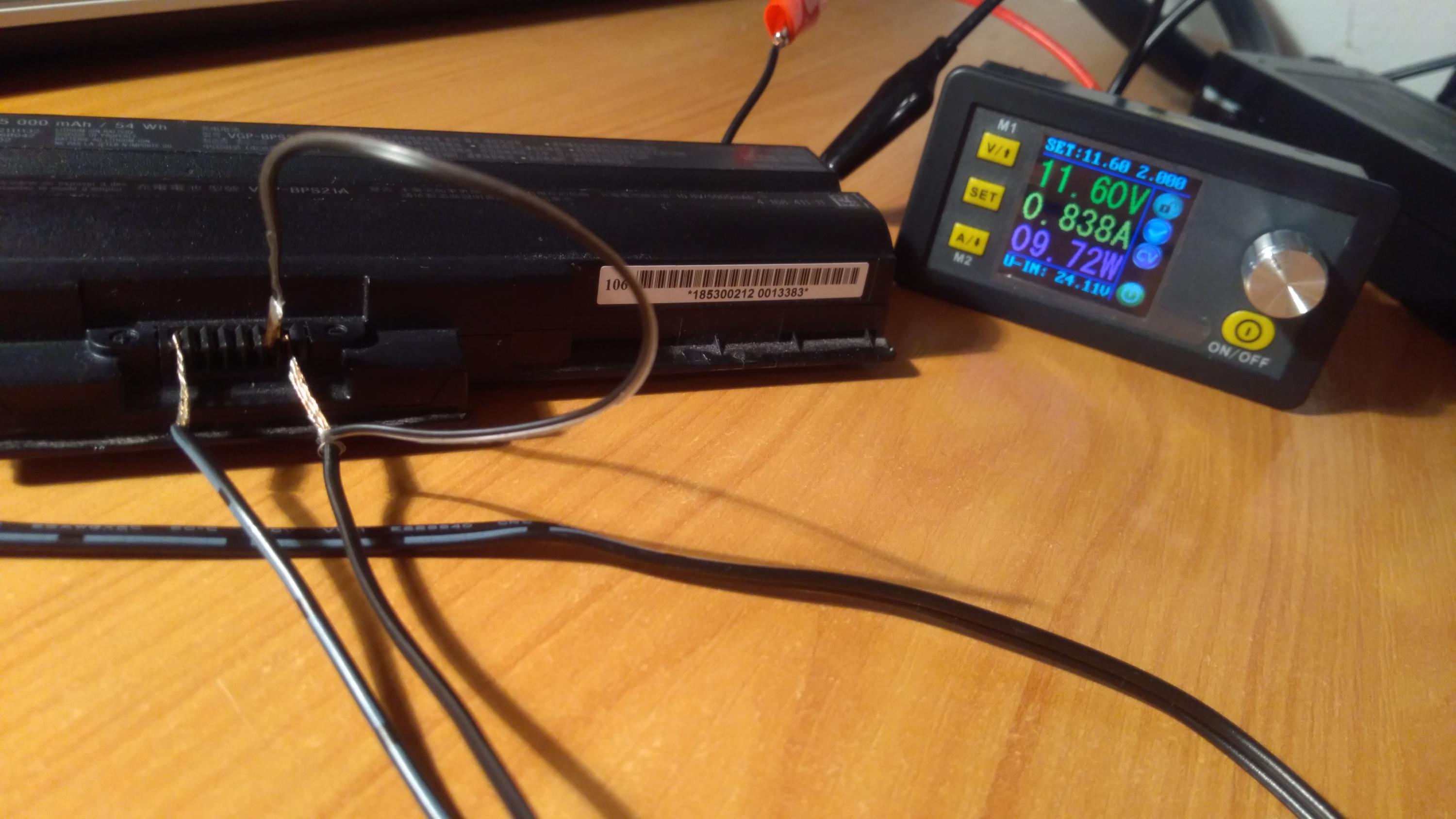

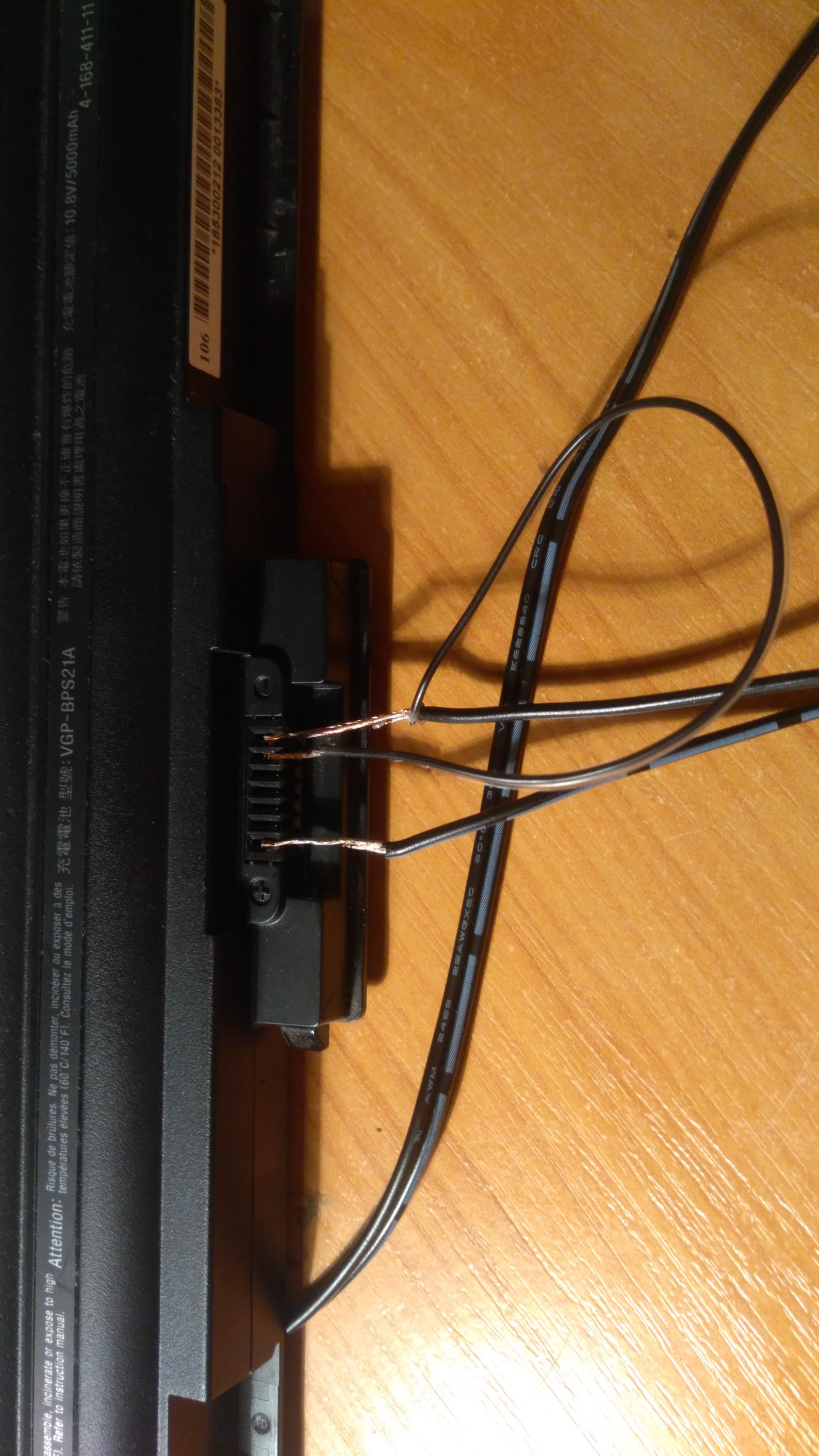

    Hello.
    If u need to charge laptop battery for check if laptop work on it when it would not work on charger.
    So here's the tip:
    U cannot only connect it with plus and minus, because nothing happend = power consumption 0 mA
    U need to connect plus and minus and other minus cable connect to pin next to minus pin as a start. Then u see some current.
    Than u need to find voltage suitable for charging, because if u overvoltage it, the battery charging for maybe one or two second and stop charging. then u need to disconnect starting second minus pin, lower voltage and try again until battery is charging constantly. change voltage by 0.1V and see when battery stop charging, than lower it.
    i attach pictures where u see overvoltage, constant charging voltage and pins connect
    Hope this will help u. if u have another tip be free to post it

      Re: TIP: How to charge laptop battery with PSU
      May want to mention what brand/model, as batteries come in different requirements to start charging. I was thinking about this when I glanced at this Toshiba NiMH pack I have on my desk and it "lies" about what terminals are + and -, there's another two terminals I need to short to get those terminals to be + and - --- and I could have used one of those two terminals as one of the battery poles and ignored what it said were + and - on the pack...
        the start pin and other pins can variate due to brand, so if somebody have other pinout please post it.
        thi pinout i used is from SONY VAIO
