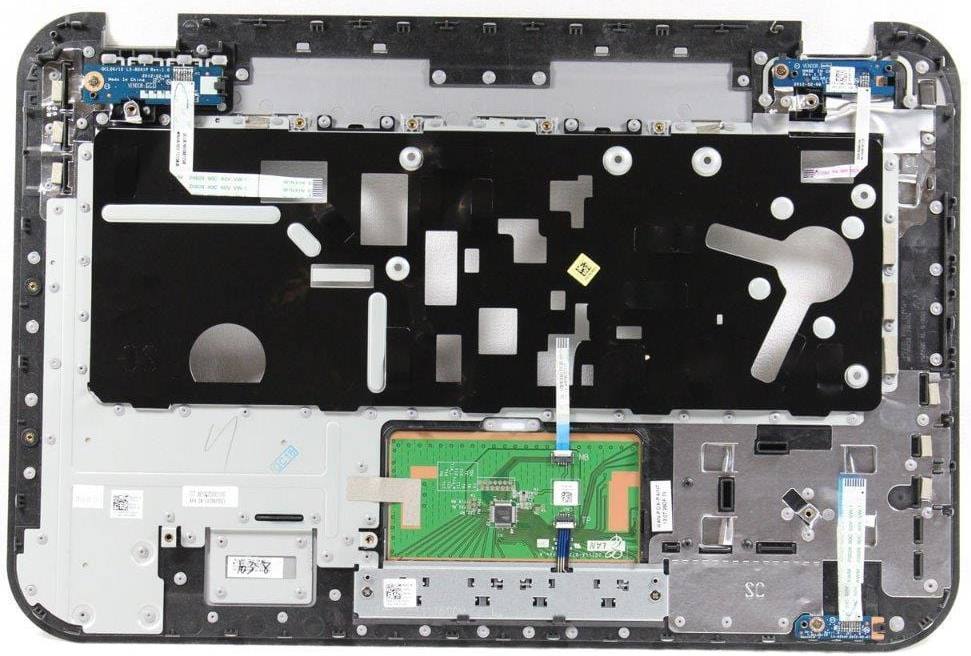

    Dear forum members,
    I am replacing the touchpad of Dell Inspiron 5520. I removed the old touchpad. It was glued to the palm rest. Now I should glue the new touchpad by some adhesive to the palmrest. but I do not know what kind of adhesive to use.

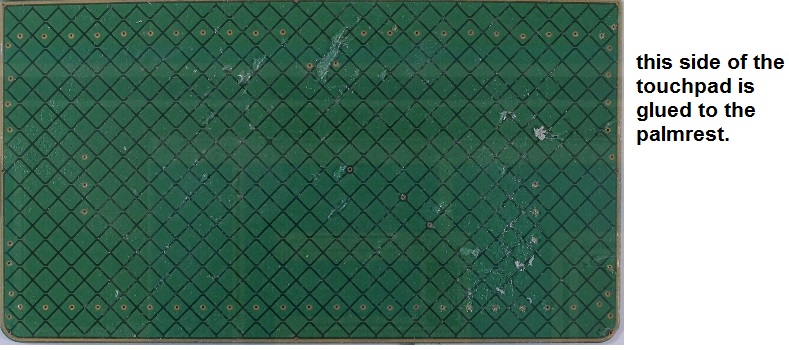

    Once I used some wood adhesive. but the touchpad did not work when it was touched. It seems the adhesive blocked the sensing properties of the touchpad. So I removed the wood adhesive.
    By inspecting the smell of the adhesive, I discovered that the adhesive of the old touchpad is not an ordinary adhesive such as super glue, or PVC glue, or plastic glue which we can find in the market.
    what kind of adhesive is appropriate for this purpose?
    thanks
    here is a photo of the touchpad and where it should be glued to.

                gluing a laptop touchpad is very rare among laptop repairshops. usually only factories do it. that is why very few people know about the adhesive.
                the touchpad adhesive is visible on the surface of the touchpad in the second photo in Post#1.
                the touchpad adhesive is similar to a colorless super glue that we use for gluing papers or plastic at home. but it has a different smell. It smells similar to some plant extract.

                          Re: Touchpad adhesive
                          the old adhesive was not powerful to hold the new touchpad. so I had to remove it.
                          I discovered that if a bit of wood adhesive be on the surface of a touchpad, then the touchpad gets confused in sensitivity and the mouse cursor stops moving, it does not matter the wood adhesive is wet or dried.
                          So I had to forget any kind of adhesive and use a heuristic mechanical method to hold the touchpad in place. I put plastic peaces between the touchpad and the mainboard so that the touchpad is pushed up. I drew a picture of this method for everyone to learn.
                          I wonder if someone discovers the best adhesive which factories use for gluing touchpad to palmrest. touchpad has a very sensitive surface so that its sensing capability is blocked if we use a wrong adhesive.
