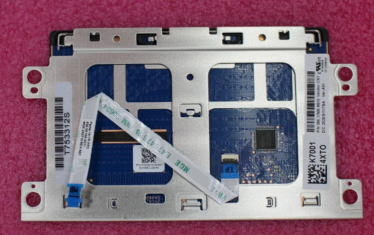

    last night i dropped some liquid over my laptop touchpad, immediately stopped using and tried to dry it up.
    the touchpad misclicks, sometimes stops working altogether
    i have removed the touchpad assembly cleaned it with alcohol and brush and cotton buds.
    can i fully disassemble the touchpad assembly as i suspect some liquid is still lurking inside the trackpad.Click image for larger version
