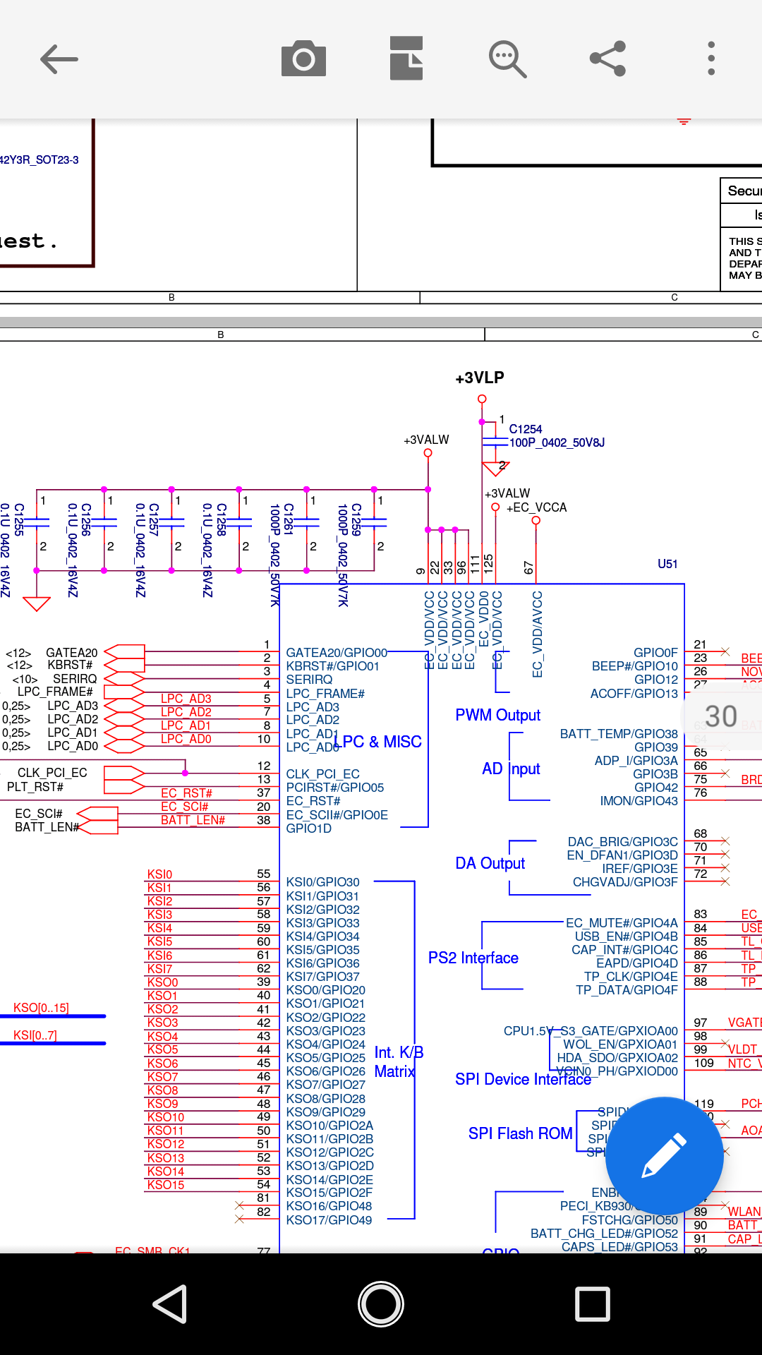

    Working on this mobo....Black screen
    Flashed bios, checked voltage on every coil all are OK
    checked Ram voltages 1.5v , vtt pin no.201 ok, Vtt_ref at pin 1 Okk, pin199 3.3v Okk pin no. 30 also ok
    What will be possible solutions?

    Re: LA-9001p black screen
    Plt_rst pin13 also present
        Where u r measuring plt_rst?? On wifi mini connector?? If so its not pin13
          Plt_rst means if on pin 13 of the kbc there is 3.3v
            at pin no.13 KB9012 and it is present 3.3v

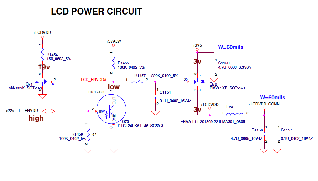

                  Check the JLVDS1 display connector
                  pin 1 + LEDVDD 19v
                  pin 7 DISPOFF # 3.3v
                  pin 8 INVT_PWM 3.3v
                        pin 1 + LEDVDD 19v
                        pin 8 INVT_PWM 3.3v
                        19v is okk
                        but pin 7 DISPOFF# - 0v
                        pin 8 INVT_PWM - 0.4V
                        this reading done without lvds cable inserted.
                        Nd one more thing i am also not getting +LCDVDD at Q71.

                                • pyry
                                  • Dec 2015
                                  • 37
                                  • Mexico
                                  19v is okk
                                  You have to make the measurements with the lvds cable connected.
                                  • pyry
                                    • Dec 2015
                                    • 37
                                    • Mexico
                                    Lcd power circuit
                                    3 volts not 19v I was wrong
