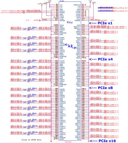

    Good day folks. I ended the night with a bang today I killed my motherboard, an Asus P5Q Premium...entirely my fault, yes, no question about it. I was being a total sh!thead and messing with loose wires from the PSU and the 12v wire touched the 3.3v one...little spark at those wires, PC turned off and now it doesn't POST anymore YEEY ...actually it sort-of POSTS, but always returns a "no video card" error (2 short beeps - 3 short beeps). The graphics card is a Radeon R9 390, which I think is still functional and here's why: during my numerous tries to get it going again, removing the CMOS battery, RAM modules, seating and reseating the GPU, trying different PCIe slots (it's got 4), the PC DID fire up one more time, so the video card appears to be functional as it outputs something. Sadly that was the last time I ever saw video out of it: after choosing the load the setup defaults and powering it off and trying a new startup, nothing: same 2-3 beep no video error and I couldn't replicate that result since....
    I thought OK, it's all done and dusted - 12v sent into the 3v bus !...there's no way that thing is still firing up ever again, but it DID (once), that's what intrigues me, so I thought maybe, just maybe...it's a BIOS issue ? :| The reason this crossed my mind is because the BIOS chip is powered with 3v, which I BELIEVE comes straight (well, more or less) from the 24p connector where those 12v came in, so perhaps the chip got? Removing the IC from the socket entirely and starting the board without it amazingly DOES give me something: the board comes on, but it just stays like that - no codes whatsoever, so maybe, just maybe there's still hope ? :| I shall try flashing the chip anyway just to see what happens, because it's on a socket and really easy to remove and mess with. It's a DIP 8 package...what do you guys think ? I think we can assume to voltage rails on the MB are fine since we do get the error codes. Removing all RAM sticks also returns its specific error (1 long beep - 2 short, repeated), so there is some life left in there - not like totally and utterly dead....it's not TOO much of a big deal, I can grab another one from like auction site, but it would be nice if I could fix this one too for sentimental reasons VERY strange defect....that's what you get for being stupid and messing with loose wires...lesson learned ! Hey, people die sometimes....whatcha gonna do ? :|
    Wattevah...

            Ok guys, rather than trying to explain what's going on, I figured it's much easier to make a video so you can see for yourself: system comes on, displays various codes before finally settling on "85" which corresponds to what would normally be "Press F1 to load setup defaults". I hit F1 and it ends with 00 which is the final state, so the system runs fine, but there's no video....definitely not something repairable I'd say, since I reflashed the BIOS chip manually with the programmer and the same thing happens...could be something as simple as a burnt resistor on a communication line, but good luck finding it....
            EDIT: it looks to me like the PCIe 2.0 slots got busted, because if I insert the graphics card in the other non 2.0 slots, it works just fine. Not sure how it would impact performance and sh!t and whether I should carry on using it like this....

              Re: I killed my Asus P5Q motherboard sort-of
              check voltage pins if shorted or if volts are present when it power on.
                Where'd u get that snippet from ? Can you provide the whole schematic ? Thanks - it would be priceless
                  i just googled pci-express 2.0 pinout
                  edit: dunno why putting image on the forum make quality bad.... however just google for it and ull find them
                      As usual no schematics but boardview for P5Q-E is available, it may help a bit. If you don't want to spend hours trying to figure out everything around the PCI express slot, your best bet is to compare voltage and diode mode measurements of every pins with a working slot… But that will be a pain. Start with the outermost pins (towards the back panel connectors), more chances that something is wrong there (power rail, control or reset signals rather than additional data lines).
                      EDIT: if it's the same architecture as the P5Q-E, the top PCIe x16 goes directly to the northbrige, the bottom one goes to the southbridge and the center ones are multiplexed along with the PCIe x1. So diode mode on the data lines won't help. But at least compare voltage of the power rail, control and reset signals between the non-working and a working slot. (with and without something plugged in if possible)
                      You could still take diode mode measurements of the data lines of the non-working slot to compare them (between themselves).

                              as he shorted voltage, i would just check pci.-express pins voltages that are just the few first pins. dont think data pins are damaged.
                                  Everything is possible… I got a damaged southbridge on a laptop with one bad differential SATA pair for ODD, one bad differential SATA pair for HDD and everything else working perfectly fine (including the eSATA), as a result of something happening on the 3V rail (took out EC, BIOS, 3V buck controller, some caps, LCD panel's built-in voltage regulator as well).
                                  Well, it's probably not the case here so I'd start with the power rails first as well.

                                    I took some measurements of those PCI slots with the system running a VGA card on a good slot and everything was identical between the 4, except for one thing: pin 11 on side A "Power good" reads 3.3v on the functional slots, but 5v on the other two...could be related to the issue ?
                                        Thanks, I'll give it a go, mainly because I like openboardview's interface better and would like to use it whenever I work with boardviews.
                                        I think we can call the Asus dead and buried, because all the power rails on those slots are there, so something on the logic side got damaged by that shock. The lack of an exact boardview also makes it quite tough to identify what's what. While I have been able to follow along up to a point and work by analogy with some of the larger components on the two boards, there's other components which are so small and so close together that it's pretty much impossible to ever identify those exactly. Could be one of those "muxers" or the northbridge itself, since I see some of the pins from those PCI slots go directly to it. Another thing I tried was following the 3v pins from the ATX connector which were subjected to 12v to see if I can identify any major component that would've been damaged but still fixable, but unfortunately some pins of the NB are also tied directly to the 3v bus, so that's no good...even Louis couldn't fix this one I think
