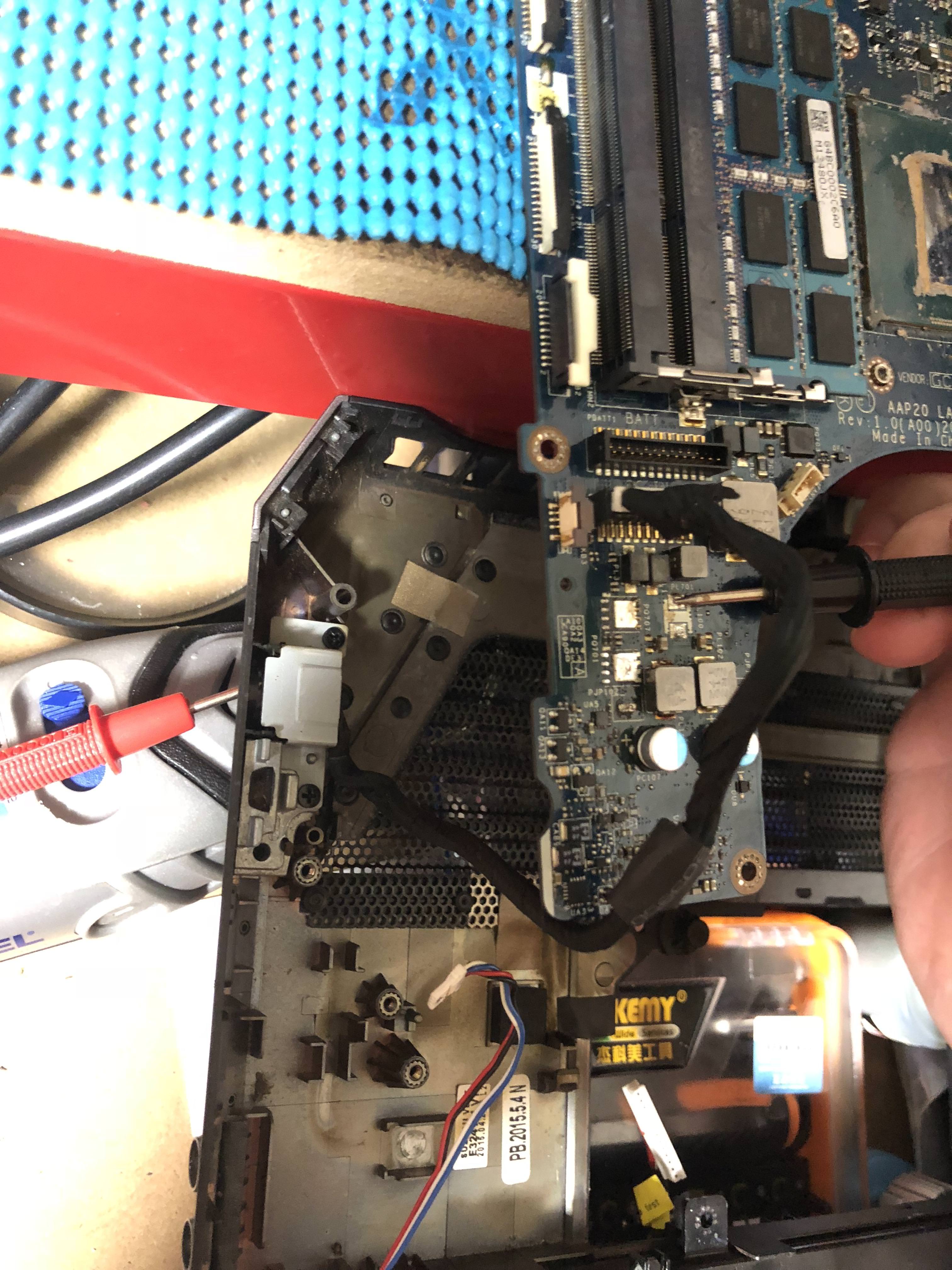

                  OK, PL100 has been removed! I accidentally dropped it onto my workbench, and since it was hot, it now has some of the rubber sheet from my workbench melted to it :/
                  Now for testing, I'm not sure how you tell which pad is 1 and which is 2. One of the pads has 3 short lines coming from it, so I think this indicates something, so this is what I'll be using here!
                  OK, here's what's happening when I test the solder pads where PL100 was with the probes of my multimeter connected to ground.
                  Solder Pad "1" (the one without the three short lines coming from it): Beeps, shows "002" on multimeter.
                  Solder Pad "2" (the one with the three short lines coming from it): Doesn't beep, shows "566" on multimeter.
                  Checking continuity from the beeping solder pad to the two mosfets' solder pads, I'm getting beeps for both mosfets, so it seems like this solder pad is connected to the mosfets. So based on what you said, the two mosfets are bad? We tested them before, and it seemed like they were fine..?
                  If it helps, here's what the laptop's mainboard is looking like now:

                    #49
                    Re: Laptop's AC adapter turns off when connected, corrosion on power-related componen
                    actually, there's no pin 1 or 2 on inductor
                    just said it to make easier to understand, look's like PL100 & PL701 connected directly? which pin on PL100 make the beep on multimeter? left side (from the picture) near PL701 or right side near PL101 & PL102?

                          #52
                          OK, I've plugged the AC socket back in and run a continuity test from the AC socket to PL701 and then to PL100. There is continuity to PL701 and also the left pin of PL100 (the one that beeps when grounded) but not the right pin. I don't have any schematics for this laptop unfortunately!
                          Anything useful here? Are we starting to get the cause of my problem narrowed down?

                              #54
                              Originally posted by kodox
                              i mean test in dc socket (where the adapter connected) for continuity after pluging in it to mainboard, is it beeped or not? if beeped i think the shorts in the "dc in" area, it's a main gate for 19v to enter the system
                              I didn't do it right? Here's a photo of how I tested it:
                              can you see something like LA-xxxx or DA0xxxxxx printed on the board?
                              Yeah, near the CPU it has "AAP20 LA-B753P" printed.

                                #55
                                no, it's not your fault. my mistake can't explain what i meant, but what you've doing it's okay. now, just move the black probe to ground, i hope it's beeped...
                                i'll search the schematic now, so we can had better understand what's going on and where...
