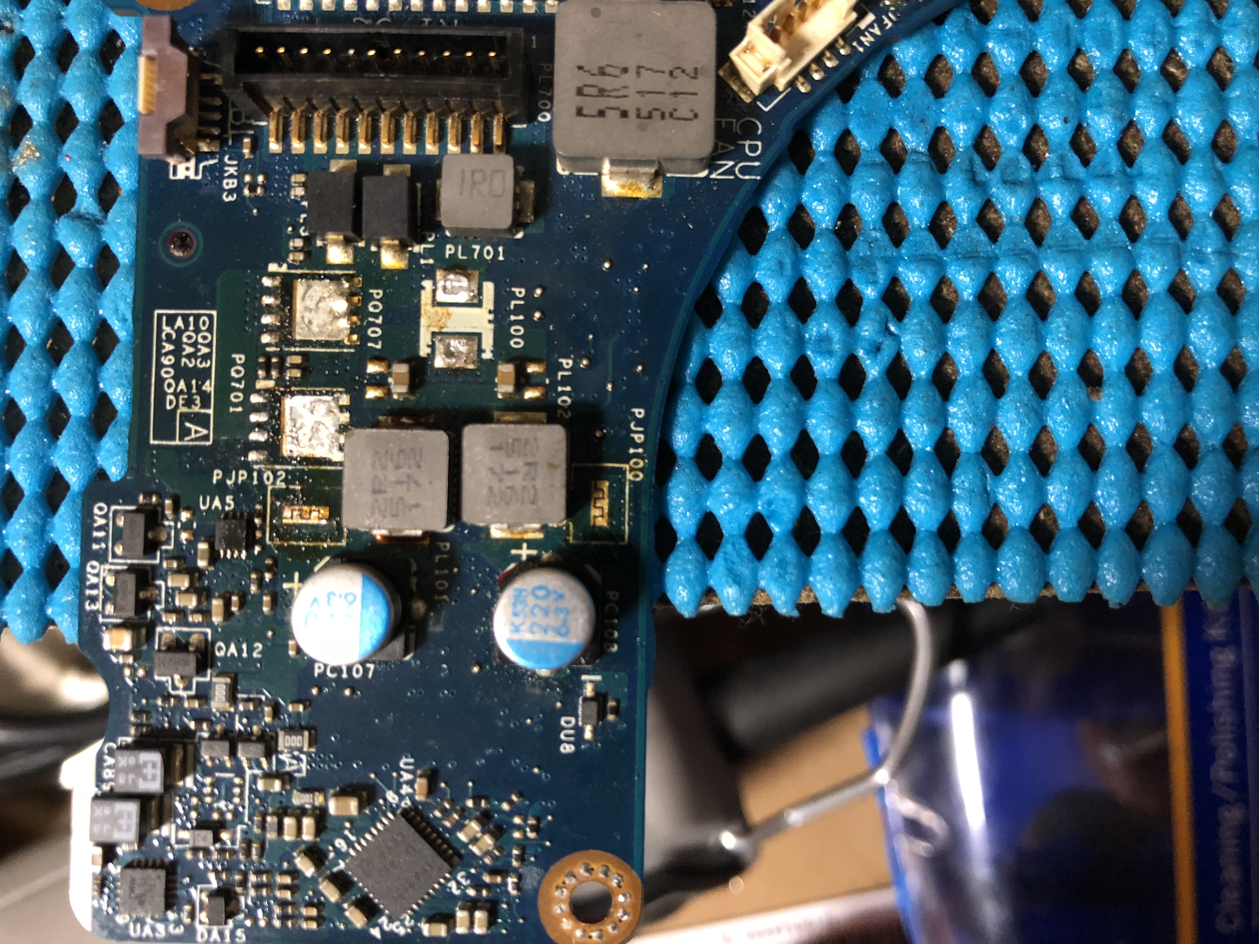

      OK, I've purchased a flat-sided soldering iron tip to see if I could cleanly remove the solder from the solder bridges. Well, I feel really dumb for having had so much trouble using solder wick in the past, because the flat-sided tip removed it all in seconds! This whole time I wasn't using the correct tip!
      Anyway thanks to this new tip, it seems like I've completely removed the solder bridges. Checking continuity between each side of the bridge doesn't result in a beep, but some numbers do appear on the multimeter's screen. The number is in the 1000s, so I'd say that the bridge is gone. Here's a photo anyway:
      Here's what I get when I check continuity between different sides of the solder bridges and ground. The "sides" are based on the orientation you can see in the above photo:
      PJP100 (right side): 0
      PJP100 (left side): 983
      PJP102 (top side): 773
      PJP102 (bottom side): 1561
      It seems a bit suspicious to me that one of the solder bridges is showing "0" for the ground continuity test, what do you think?

        glad you've finally found proper tips to remove solder bridges, about the PJP you've remove the solder bridges on it & measured, actually it's not the PJP we should concern because those pjp it's not on B+ line (AC Adapter Line), we can ignore PJP100 & PJP102 for now and move to PJP's that i've mentioned before

            after you sure 100% the solder removed from the PJP, test using the continuity to ground on PL100 top pin (on the last photo), if not beeped, you've found the block of circuit that causes shorts. if still beeped, reapply the solder on that PJP and move to the next PJP

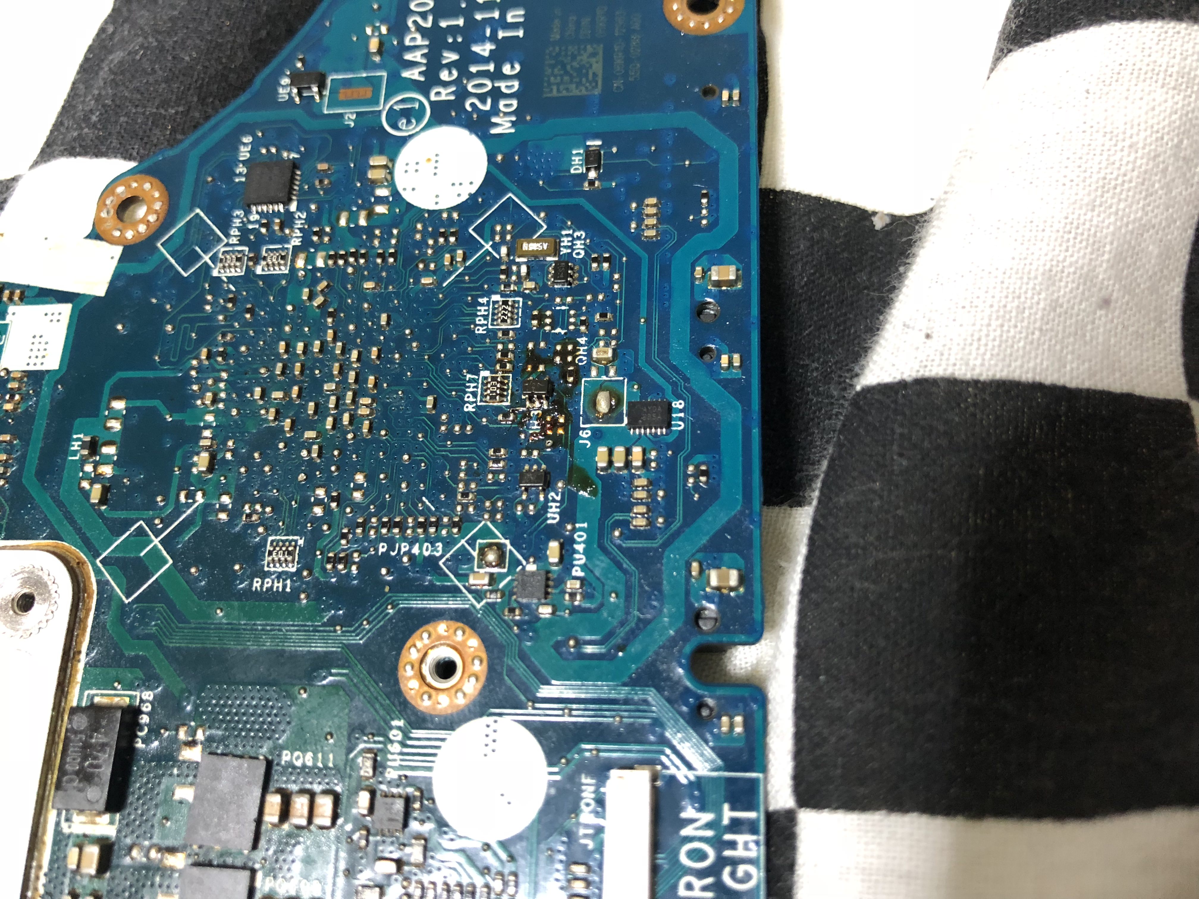

                      Oh, I've been focusing on the wrong solder bridges? OK, I'm trying to find the bridges you mentioned. I've found PJP301 but I'm not sure which one it is! Would it be the rectangular solder pads to the left, or the round solder pads to the bottom?
                      Also, as I was searching for the other bridges you mentioned, I noticed that the bottom of the board doesn't look too good! I've never really noticed since I've been focusing on the top of the board! Here's some photos:
                      This solder bridge is one of the ones you listed and looks to be a really bad shape! Possible cause of my problem?
                      Here's another area of the board with some nasty-looking gunk! It also looks like there's a solder bridge between two legs of that component! That can't be good!

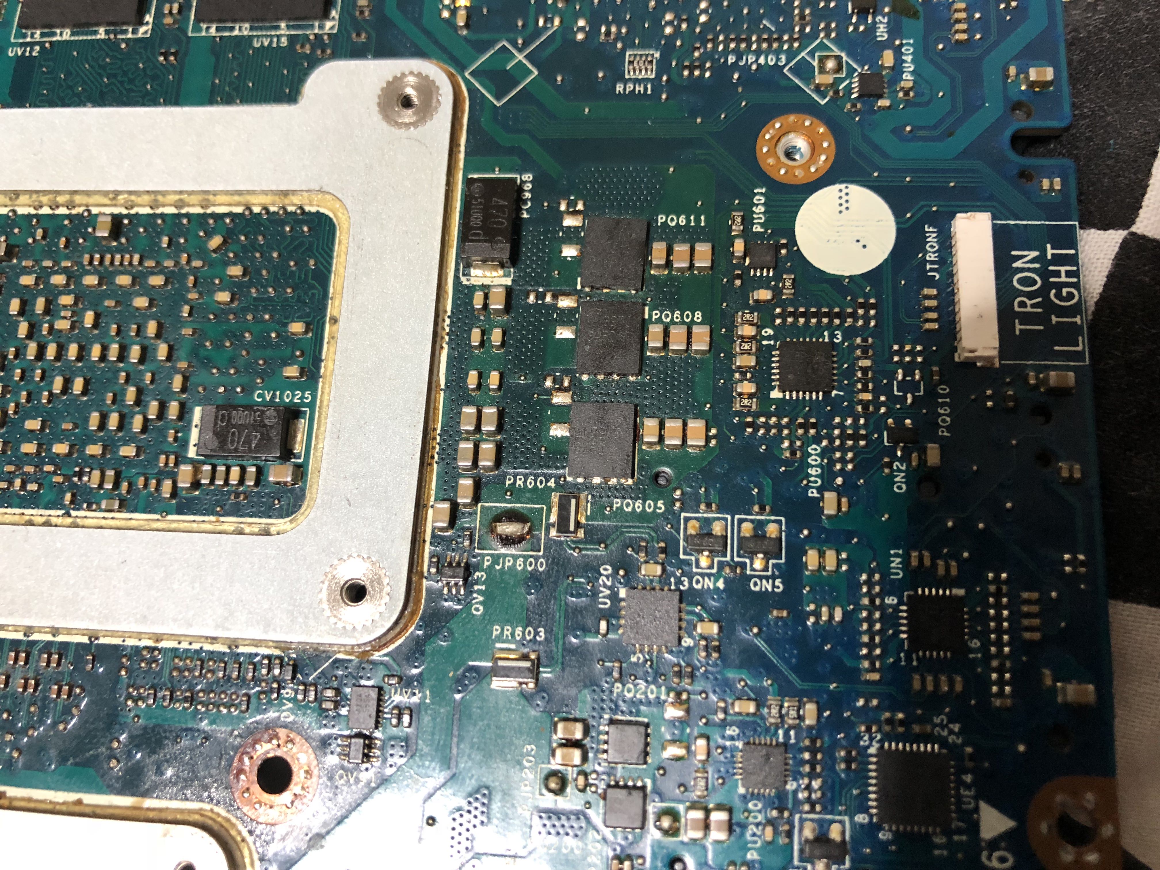

                            Hmmm, where do you guys think I should go from here? I'm a bit concerned about that mess on the bottom of the motherboard. Is this likely to be a problem when it comes to fixing this motherboard? Or will I discover if it is or not after further diagnosis with kodox's solder bridge probing method or using a PSU like dellxps15 recommended?
                            Originally posted by kodox
                            it's round solder pads
                            OK then. So both round solder bridges need to be removed then?
                            *EDIT* Ah! I think I've found something! I removed the PJP600 solder bridge and now when I test continuity between PL100 and ground, I'm getting different results from before! With the black probe on PL100 and the red probe on ground, I get a short beep, follwoed by
                            "442". With the red probe on PL100 and the black probe on ground, I get a short beep, followed by some large numbers, before finally settling on "1". Trying the test again usually results in "1" right away, no beep.

                              OK, I've cleaned up that mess on the back of the motherboard and cleaned up the messy solder on that chip.
                              From what I can see, it looks like whoever was trying to fix this board previously pulled one of the pads off the mainboard, since that brown part looks like bare silicon to me. Any idea where this pad would be connected to? It seems like the trace runs under the chip...

                                you've found the shorts, if you place PQ707, PQ701 & PL100 and then you plug AC adapter, the LED won't turned off.
                                those shorts are in graphic chip & VRAM power supply area (page 63 on schematic), before you remove anything on this area check for continuity to ground on PL601, your multimeter will beep & show a number. then check PR603
