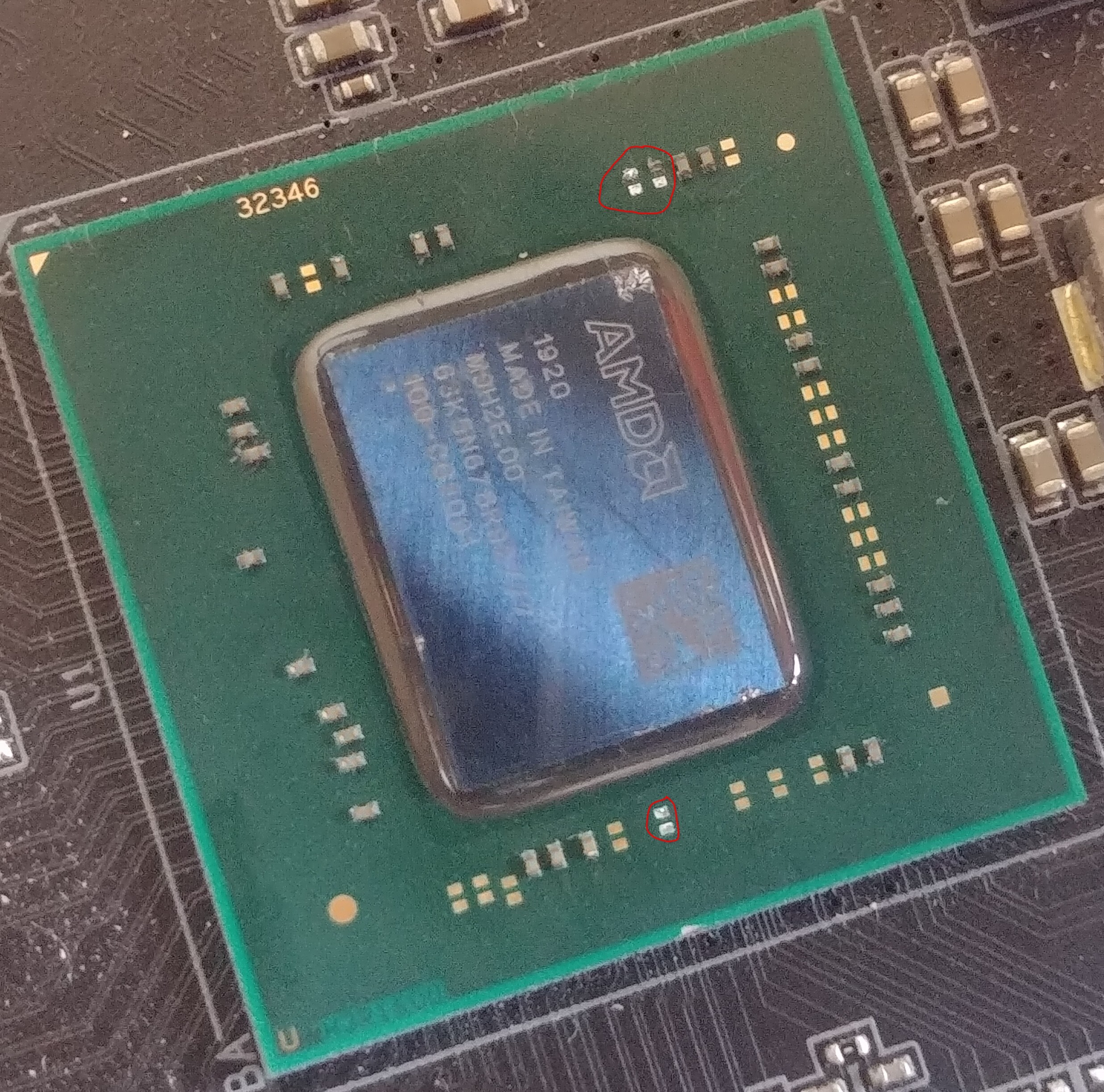

      Done some more poking with this. The power rails seem OK, VCORE is at 800mV. APU_PWOK is fluctuating though, because PM_PWRGD is fluctuating. It looks like this is the chipsets power good signal? I've closely inspected it and it looks like at some point there were 3 components that were ripped off the green PCB that the chipset is on. Is anyone able to identify them please? I am wondering if they are preventing the chipset from powering up properly. I've attached a photo and have circled the missing components. It looks like it took a good beating from someone fumbling around with the heatsink for it.
      • Swell61
        • Oct 2023
        • 31
        On closer inspection of the board, it seems as though PM_PWRGD does not actually feed into APU_PWOK. The schematic shows a 0hm link with "* CHECK" next to it but it is not present on the board. I've found a high res picture of the same board online and it is also not present. The power for the PCH is present, I've probed the SMDs on the green PCB and it has 1.0v and 1.8v and it gets warm after being powered on for a short while.

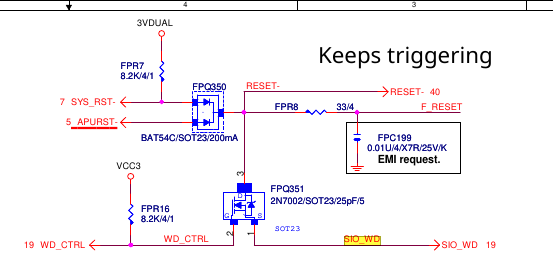

          Another piece of the puzzle - I hooked up an old 20MHz CRO and can see APU_PWOK is fluctuating because PCH_1V0_GD is pulsing which is caused by AVDDP_EN pulsing on NPU1. This is because GLOBE_S3- is pulsing, due to SLP_S3- pulsing. I've checked SLP_S5- and this seems to be pulsing too. By pulsing I mean they are both high most of the time but I can just make out a dip to 0V on the CRO. PSOUT (power switch) seems to be behaving properly, it is high until I press the switch and goes high again once I let go and there is no pulsing. Not sure what would be causing the two SLP signals to pulse.
          • Swell61
            • Oct 2023
            • 31
            The reset line is getting triggered rapidly. Not sure what from and I don't know if it a cause or a symptom.

                By fluctuating, I mean the signal is high but on the scope I can see dips to 0v briefly. E.g. SUS_S3 is high but drops to 0v very briefly. This is doing things like turning off power controllers briefly which drops the voltage. APU PWR OK signal (the one that combines the other power ok signals) fluctuates between 800mV-1.6V which I assume is because the S3 signal keeps turning the PCH power supply that is part of the APU power signal on and off.
                When the board has power but is not turned on, the reset line is high. When the power button is pressed, this drops to 0V with spikes to 3.3V. I'm not sure if this is because the IT8795E is holding it low after the board is turned on which could the the source of the fluctuating S3 and S5 signals, or if this is just another symptom of something else. I was trying to think of reasons why the S3 and S5 signals would be choppy and with my very limited experience, as these signals are so early on in the boot process, it is probably the processor beimg reset (either from a faulty CPU power supply (I'm not sure which one powere this part of the CPU) or from a reset lime going low). I tried disconnecting the third pin of FPQ350 but that didn't work, the board would power on briefly and then turn off.

                    I think I do have VCORE, it's at 800mV. SLP_S3 and S5 are 3.3v but with the scope I can see very brief drops to 0V, as if the processor is being reset. This led me to check the reset lines where I found this choppy reset signal problem (it being high when the board has power but is off then when the power button is pressed to turn the board on, it drops to 0V with constant spikes to high). I am now trying to figure out why the reset line is being triggered. Something clearly seems unhappy as when the board is off, the signal is high, as expected. But when the board is turned on, it becomes erratic

                      If I'm not mistaken, SYS_RST- and APU_RST- and RESET- are all active low signals because of the - symbol. So they are held at 0V when the board is turned on, and 3.3V when the board is on standby because of the pull up resistors.

                        No, active low means if you want to reset the circuit, it will pull down the voltage level, during normal operation, it should be high to remain inactive status, otherwise your system will be in endless resetting itself.

                          It could be due to one power is abnormal, so the SIO keep sending RST, or maybe the 3VSB/3VCC been shut down. suggest to look at all the power domains to make sure the powers are good.

                            The PCH power (PM_1VSOC) is abnormal - it is on most of the time with drops to 0v very briefly visible on the scope. This is one of the power rails monitored by the IT9795E (the EC according to the schematic). It is enabled by the S3 signal though, which keeps dropping out, which I think is causing PM_1VSOC to be unstable. I see the SIO also monitors 7 voltages, I will check those, thank you for the pointer. I am away for the holidays so will continue the debugging in the new year. The SIO doesn't seem to have a direct connection to the RESET line, can it still cause it to toggle? Presumably through the EC?
                            EDIT: I see there is SIO_WD which looks like it can control the line if WD_CTRL is high
