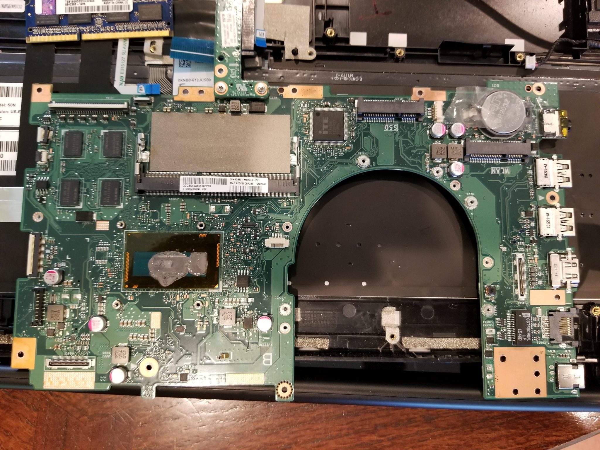

    I have picked up this laptop, without hard drive and only with the motherboard soldered memory.
    It starts up, LED is on and fan spins slow/fast/slow/fast a couple of times, that settles, on the fast spin. Nothing shows on the screen, not even backlight. I have tried with external monitor, still nothing.
    I have to admit a mistake that I have made, but did not change a thing.
    While it was on, I have pulled the display plug and blew up a capacitor, that goes to the battery(16.3V).
    If I plug in the charger, the battery LED is on.
    I don't have experience, with laptop repairs. I have repair equipment.
    I would appreciate any help, that I could get.

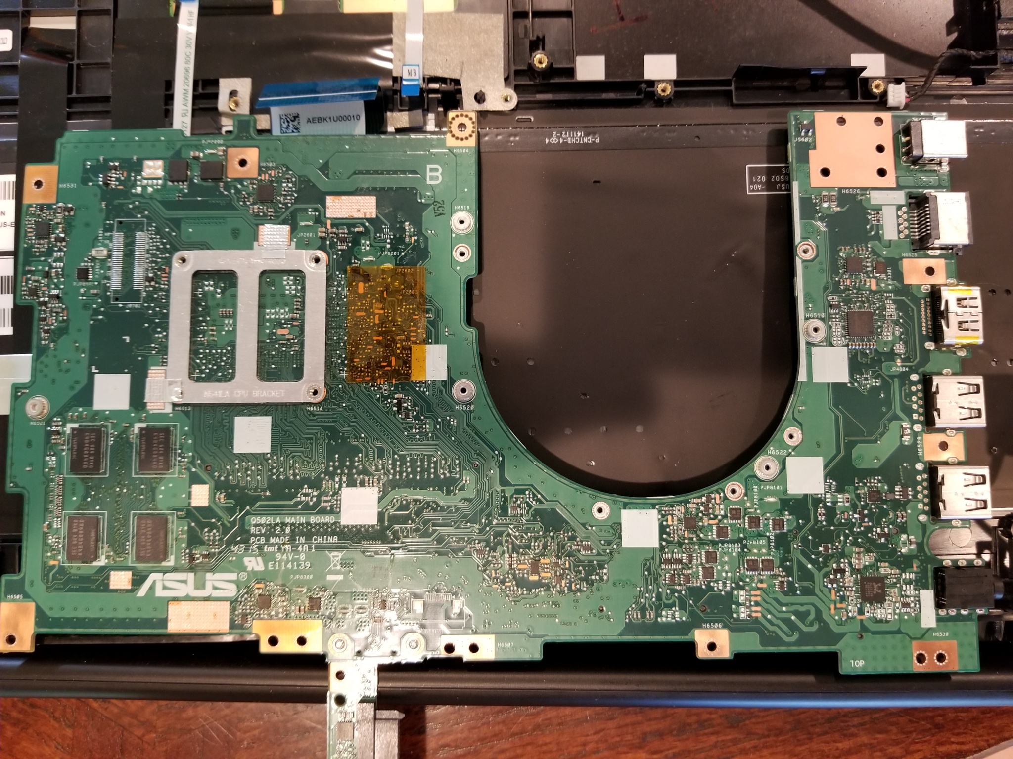

    I think on this model the soldered memory is VRAM. Install some memory and see, and replace the blown cap. There`s no motherboard schematic available, but there is a boardview file, i can`t find a free one anywhere. https://***********/threads/asus-q502la.20646/ .EDIT: if you need the boardview ask on this forum if anyone has it .

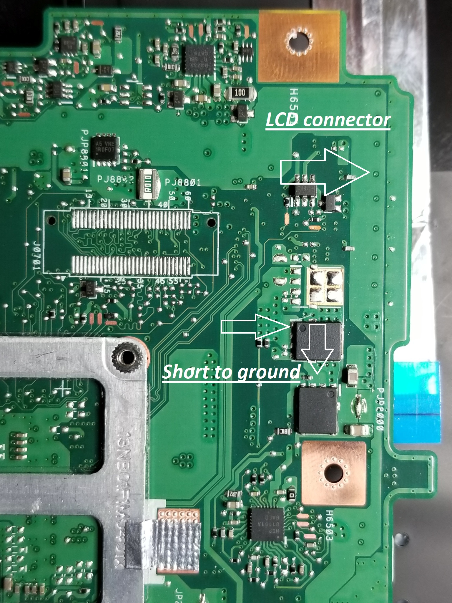

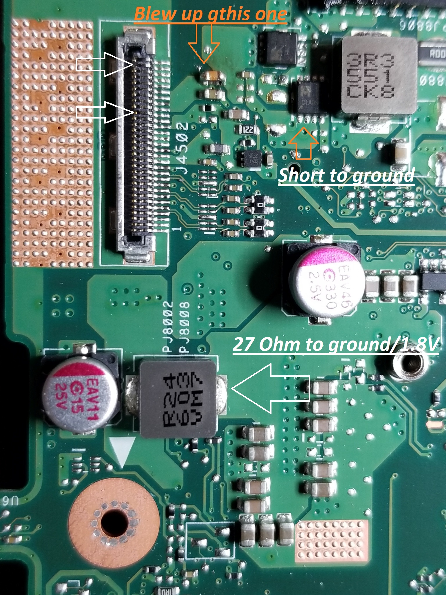

      OK, I have soldered in another capacitor. No change.
      There are two pins at the display connector, that it seems like a previous person "played" with it, because they are not nice and straight. To me, it seems like they should still make contact, though.
      I have removed a FET above it, because it seemed like it is shorted, but after I have removed it, it wasn't.
      I'm kind of confused about these FETs, how they should show with the meter.
      There are two at the bottom, that at least one shows like it is shorted.

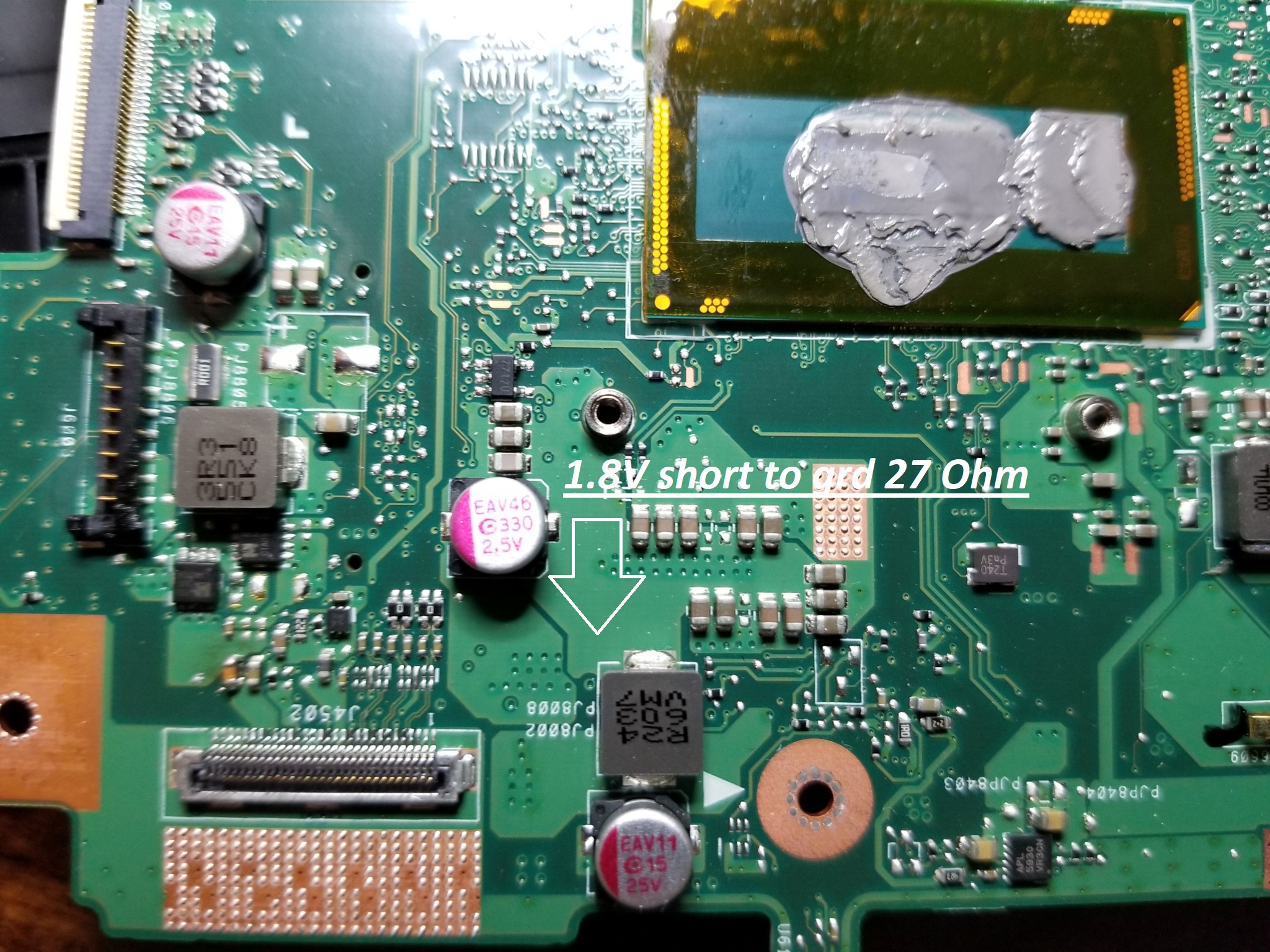

      Definitely, the 1.8V coil gets pretty warm. With Ohm meter, shows 27 Ohms, which is not good.
      CPU is cold.

        The part that blew by the display connector was a ferrite bead. Not a capacitor.
        That 1.8V rail is CPU core power (which can range anywhere from 1.5V to 1.84V for that CPU). It's supposed to have a low resistance. That goes along with low voltage and high current. Reading double digits for resistance is not alarming.
        The other places labeled as a short to ground are really just... ground. Those pairs of FETs are buck converters. They have a supply voltage on one side of the pair, ground on the other, and the output voltage in the middle.
