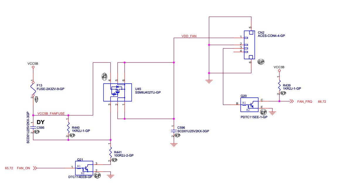

    I have the schematic,what I attached,but I can't figure out what is the problem.

          Do you have the FAN_ON signal? I assume it is a pwm signal to drive the fan at different speeds
            • 21874
            Re: Lenovo T510 Fan error
            FAN_ON into Q21

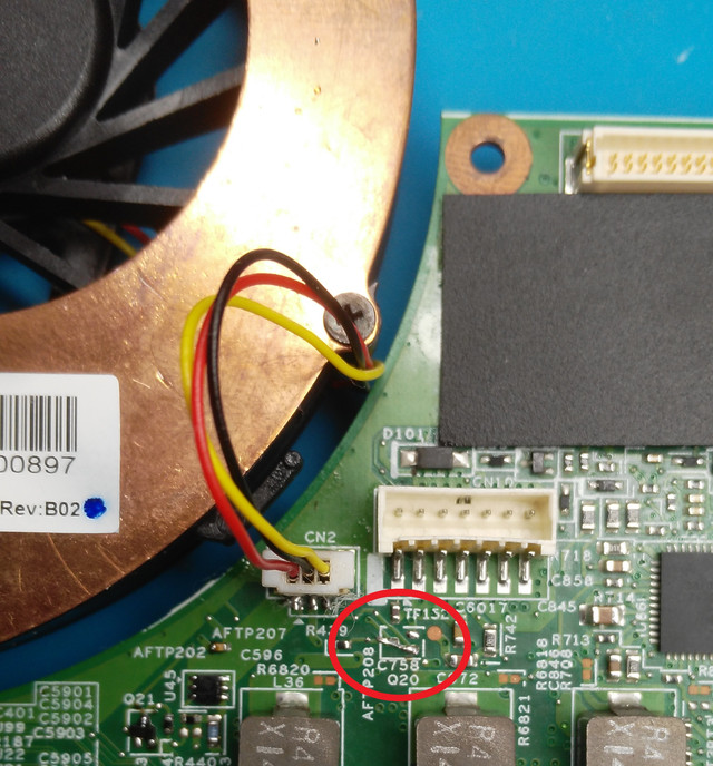

                LE: My problem was Q20. Removed. Made a short between B + C. Replaced the FAN. Everything is fine now.
                    The same problem ,shorting B anc C of Q20 helped. This new ordered fan have probably another output section for rpm sensing. thanks

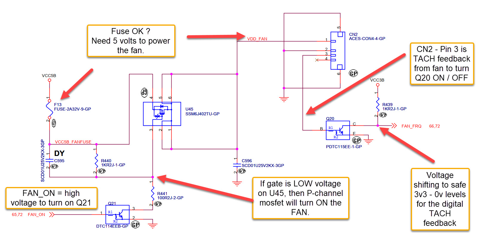

                          See attached.
                          Measure the voltage output of the 3v3 TACH feedback @ Q21. Do not bypass this transistor else you risk to damage other parts on your logic board.
                          Without the use of Q21, the voltage output from the FAN is not limited - it can swing to a dangerous value and kill the digital feedback pins used to monitor the FAN operation.
                          Post the voltage at each leg of the circuit to review.

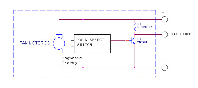

                              See attached. (borrowed without permission from another website)
                              The output is apparently open-drain so there is a low signal but no HIGH signal - instead, the transistor is OPEN and the internal pull-up will define the 'soft high voltage'.
                              On this note, only 5v is being fed into the fan connector so very likely the pulse stream output swing (hall effect switch will trigger upon each revolution of the fan) will be 0 to 5v which is too high for digital logic to accept without damage.
                              Respectively, Q21 will perform this level shifting to the 0 to 3v safe levels.
