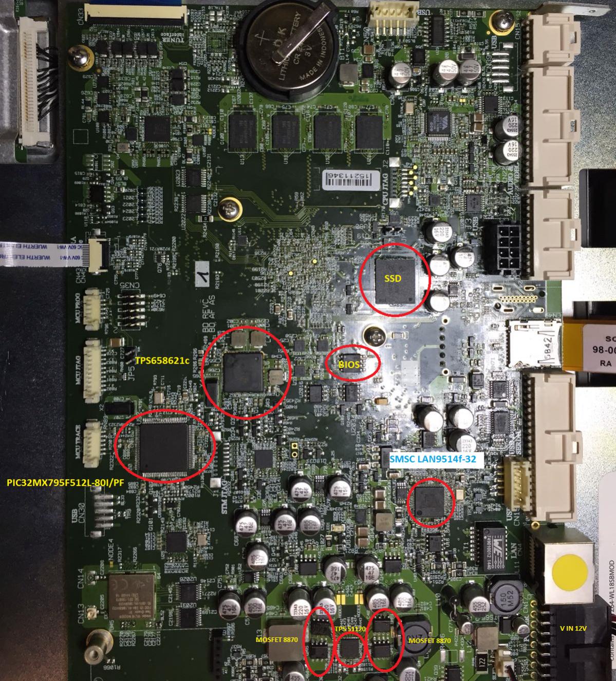

    Hello, can somebody help me with this Device? ( its like a Notebook)
    There are no schematics for this board avalabile, but ive tested some parts to change, but no reaction.
    Normaly the device has an Autostart mechanisim (power on when 12V plug in).
    I checked the board with laboratory power supply but i have allways the same issue the device wont start and consum not more then 0,25amps.
    Normally when the device start it should consum about 1,4 – 1,6 Amps
    The 12V, 3,3V and 1,6V are present on the board.
    The device has a LED on front wich is flashing permanently.(no screen)
    I tried t change several parts wich u can see in the PICs but no success, can anybody give me a note ?
    NOTE :
    On The Backside of the board is an NVIDIA T20MGS-SH-A4 ( I think Graphic , North / South / CPU all in ONE ) BGA wich i changed to.

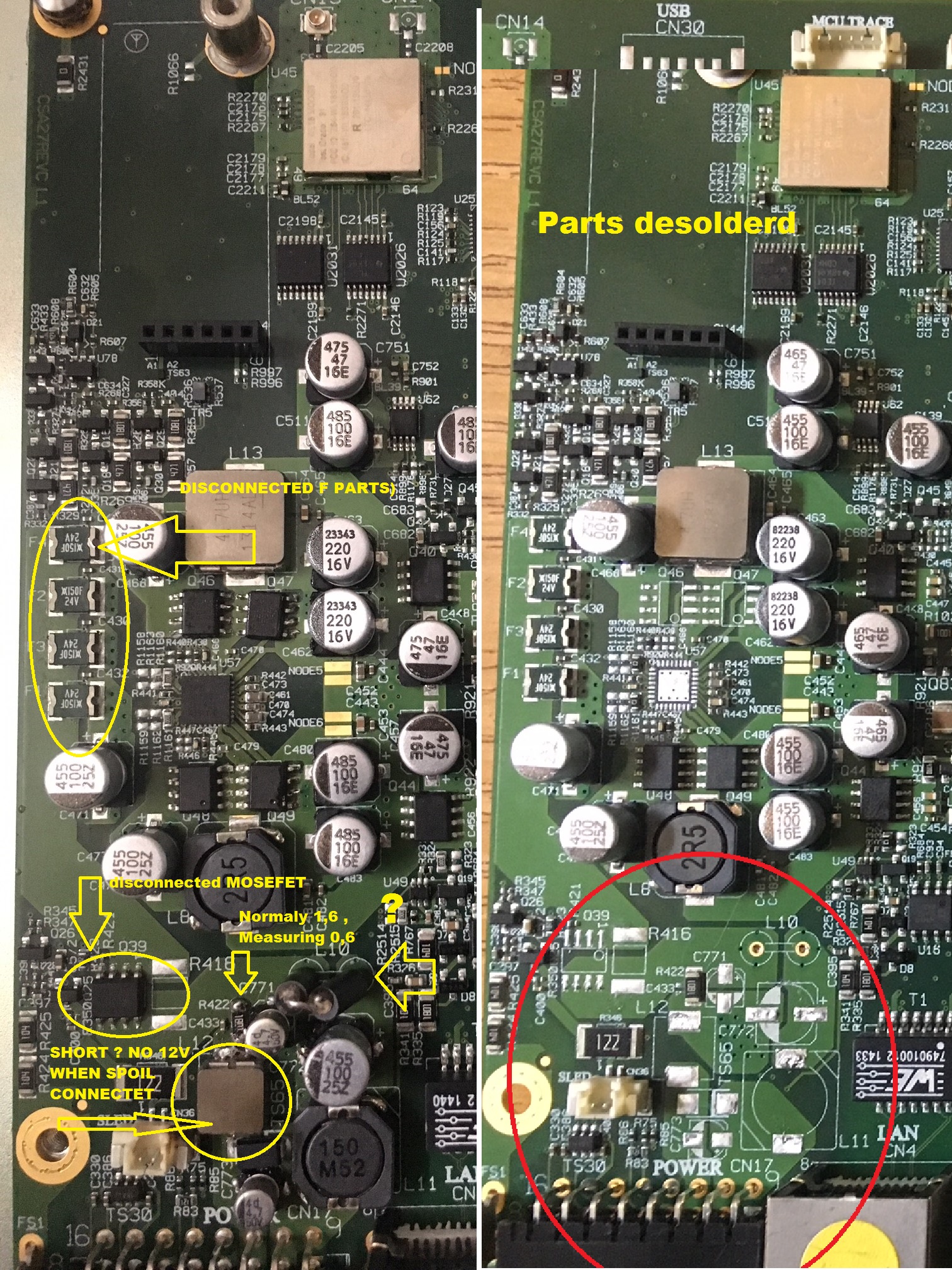

        today i have measured all coils, and i see that the coil by V-IN has no power (i think its in short) see in the pics. When i disconnect the spoil i have 11,9V there but even if i connect the 12V are not present.
        The other coils on PCB has power and work fine.
        I tried to dissconnect other parts (like marked f parts ) to separate the circle but its still in short.
        Also i have seen that the R422 Resistor should give 1,6 but when the Parts are connected i have only 0,6
        Can somebody tell me what is the L10 ?? is it only a brigde ?

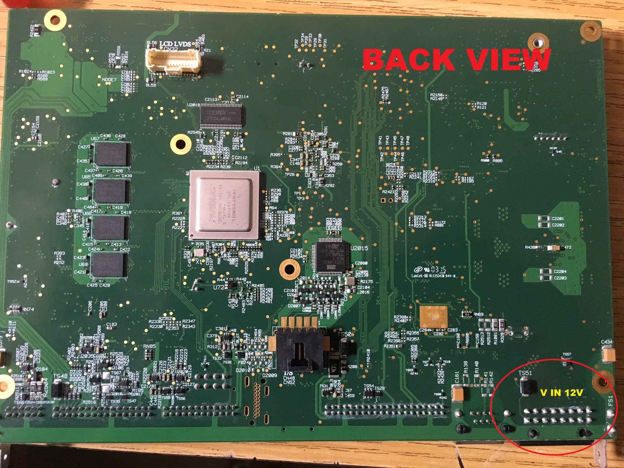

        I also uploaded the Backside pic so (but i didnt see so much things in the back)
        Can somebody help me to find the issue ?

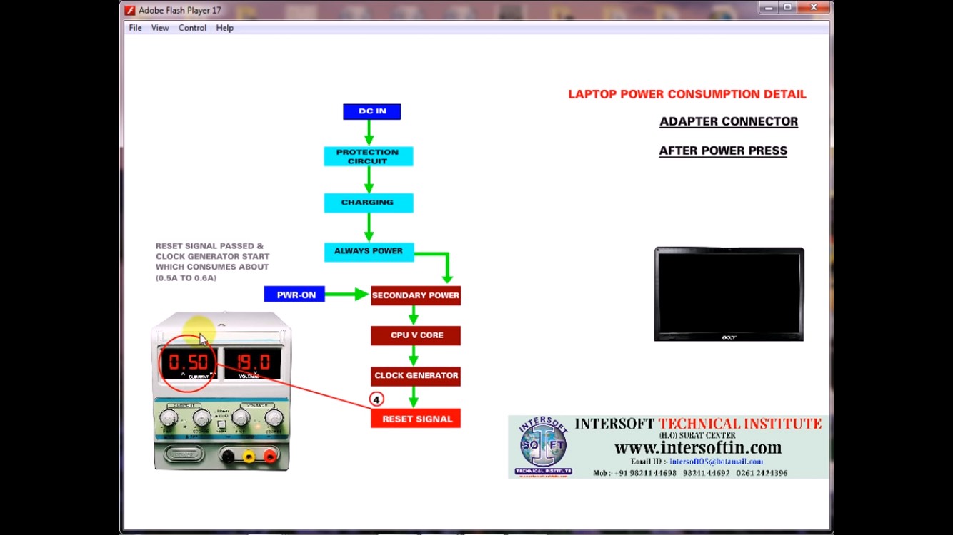

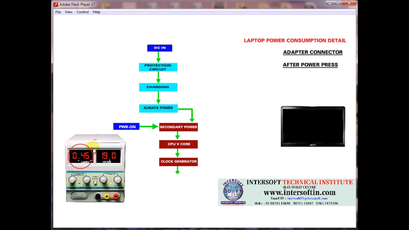

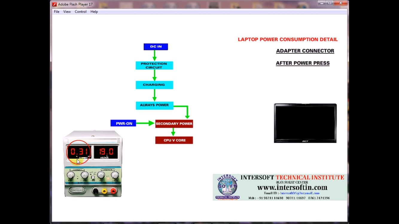

          I have seen this video and try to find the fault with the consumption of board , is it possible ?
          https://youtu.be/ASqHvtNks9E
          Can it be that the problem is in the sequence between secorndary power and to V-Core to CPU and is this method possible to find the issue?
          Or can it be that is a bios issue ? (but bios should start by 0,85 AMPS consumption after north South brigde start like demonstrated in the video)

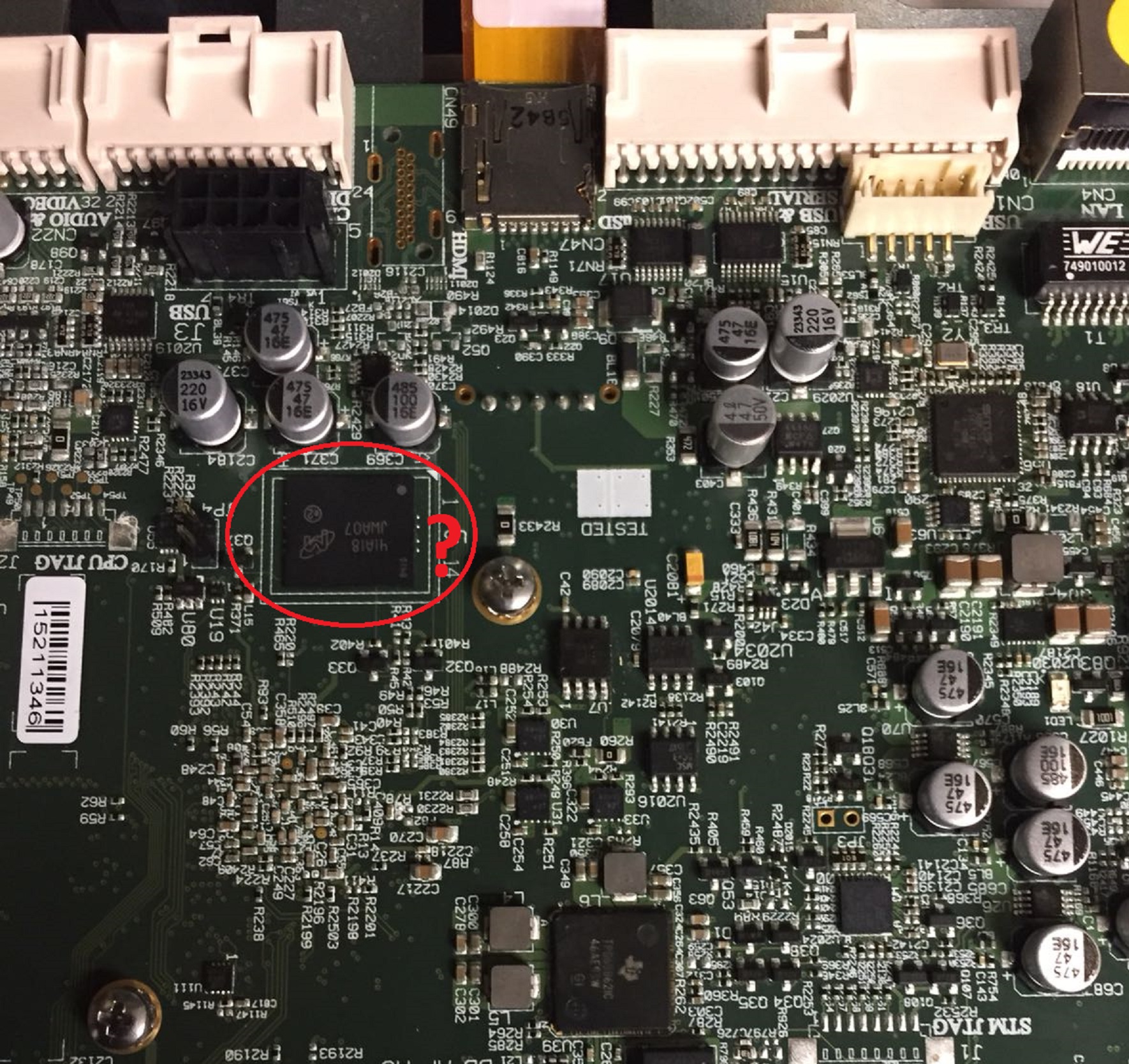

          and can somebody tell me wich type of Flash 41A18 JWA07 is on the last pic and wich programmer can read /write is the best for it.
          Many thanks for your support
            • 21907
            Re: Mainboard consum 0,25AMP/ wont start , Please help
            Micron JWA07
            https://www.elnec.com/en/device/Micr...5BWFBGA153%5D/
            https://www.aliexpress.com/item/EMMC...270054778.html
            These are adapters for the popular RT809H programmer
            https://www.aliexpress.com/item/Free...ceBeautifyAB=0
