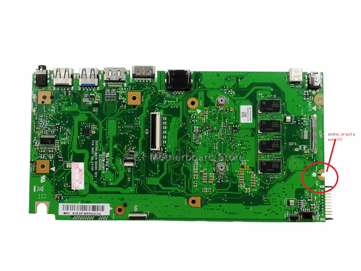

            Re: Asus X541NA power issue
            take look at H6001 it has also a star as indicator, there must be a screw to connect both side of the ground connector.
            • casti3l
              • Mar 2014
              • 95
              • romania
              take a look at this photo

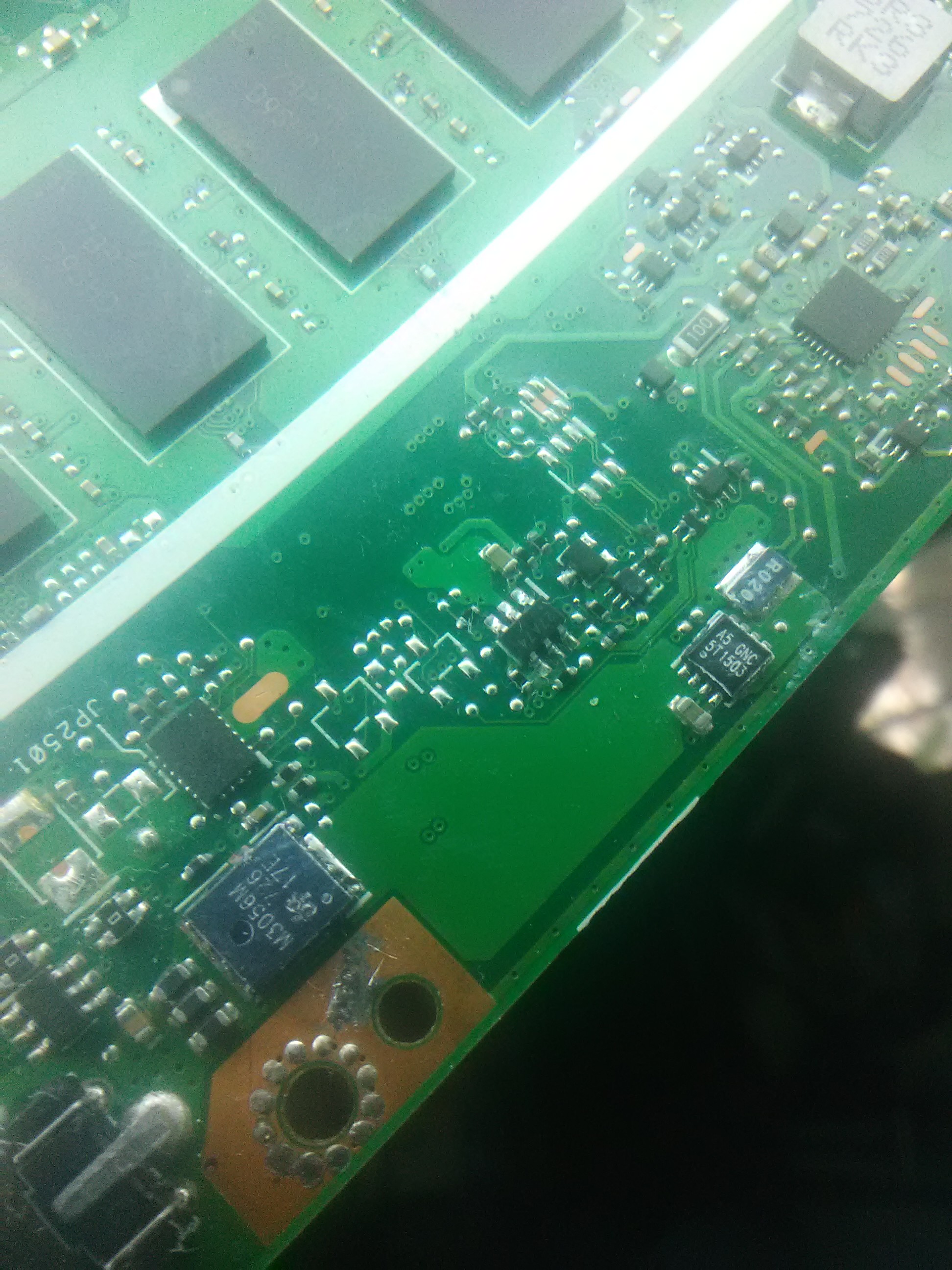

                  Issue is no power, first mosfet, ubiq m3056m (n-type 30v) checks out good, removing it shows gate and source are shorted. Battery is not charging, voltage won't make it past the mosfet. Bench power supply didn't show any power being consumed when mosfet was still soldered.

                    I meant diagram for BQ24780 is avlbl not the specific schematic for asus x541na. As far as your problem is concerned,do the following and report back.
                    01.Voltage on PIN1/4/8 of 1st and 2nd dc-in mosfet
                    02.Resistance between pin 1-4/pin1-8/pin4-8
                    03.Resistance on pin8 of 1st mosfet specific to ground.
                    • Mazorca
                      Sorry for the delay. I am assuming that the second mosfet mentioned is the smaller one.
                      Voltages: black probe on first pin
                      1st mosfet:
                      1-4 short
                      1-8 15.4v
                      2nd mosfet:
                      1-4 short
                      1-8 short
                      Resistances:
                      1-4 1.7 ohms
                      1-8 0 ohms
                      4-8 OL
                      2nd mosfet:
                      1-4 1.7 ohms
                      1-8 4.3 ohms
                      4-8 5.1 ohms
                      Resistance pin 8-Ground: OL
                      Resistance of 1st mosfet out of board, discharged by pressing finger
                      1-4 OL
                      1-8 .7 ohms
                      4-8 OL
                      • Mazorca
                        • Jan 2017
                        • 463

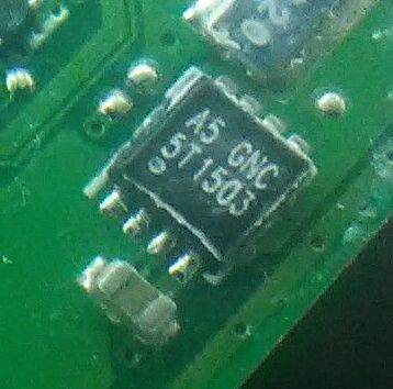

                        Nevermind, the second mosfet is shot, source to drain is shorted, source to gate is shorted, drain to gate is shorted. I should have done more work before I posted. The schematic is still needed, I have no idea what the 2nd mosfet is.
                        Found it, it looks to be a P0903BEA

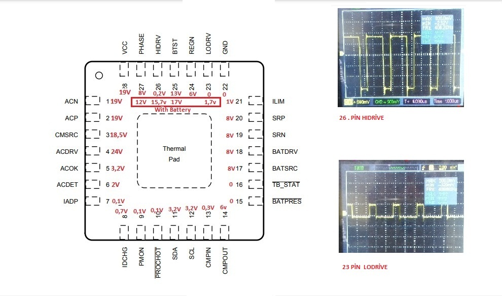

                                Originally posted by satheesh123
                                x541na mother board, issue is restarting always ,some times display coming but suddenly goes off. plzz helip me
                                With or without battery. If not receiving 3.3v RTC signal from battery. may not work stably.
                                  measurements should be as in the figure.

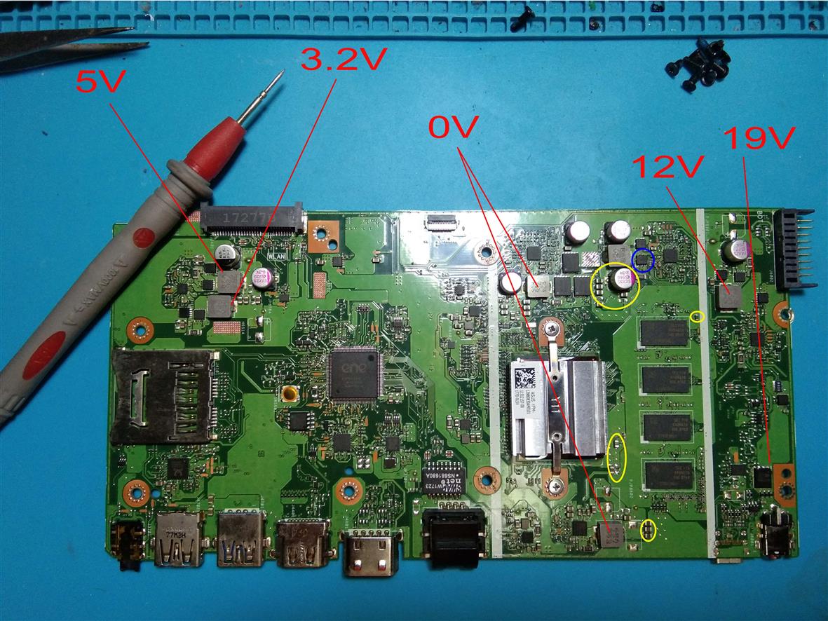

                                        I also working on this board with same power issue... I'm sure and i found short, i just can't locate the short, the only part that getting very hot is the processor, is this mean's that the processor is shorted? i check the surrounding passive components around the processor and memory specially the capacitors they are short everyone of them. I really suspect the processor because it getting very hot once i put the power power adapter. see the attach picture, all voltage line (red) normal i think... except those in 0 volts. yellow color circles are shorted caps or v+ path i'm not sure what voltage are those I need a schematic, the blue circle is a mosfet that at first tested short but testing it out of circuit is good. I mentioned that the only part that is getting very hot is the processor, any thought? I don;t have a proper equipment to pull-off the processor, I need help for this... thank you
