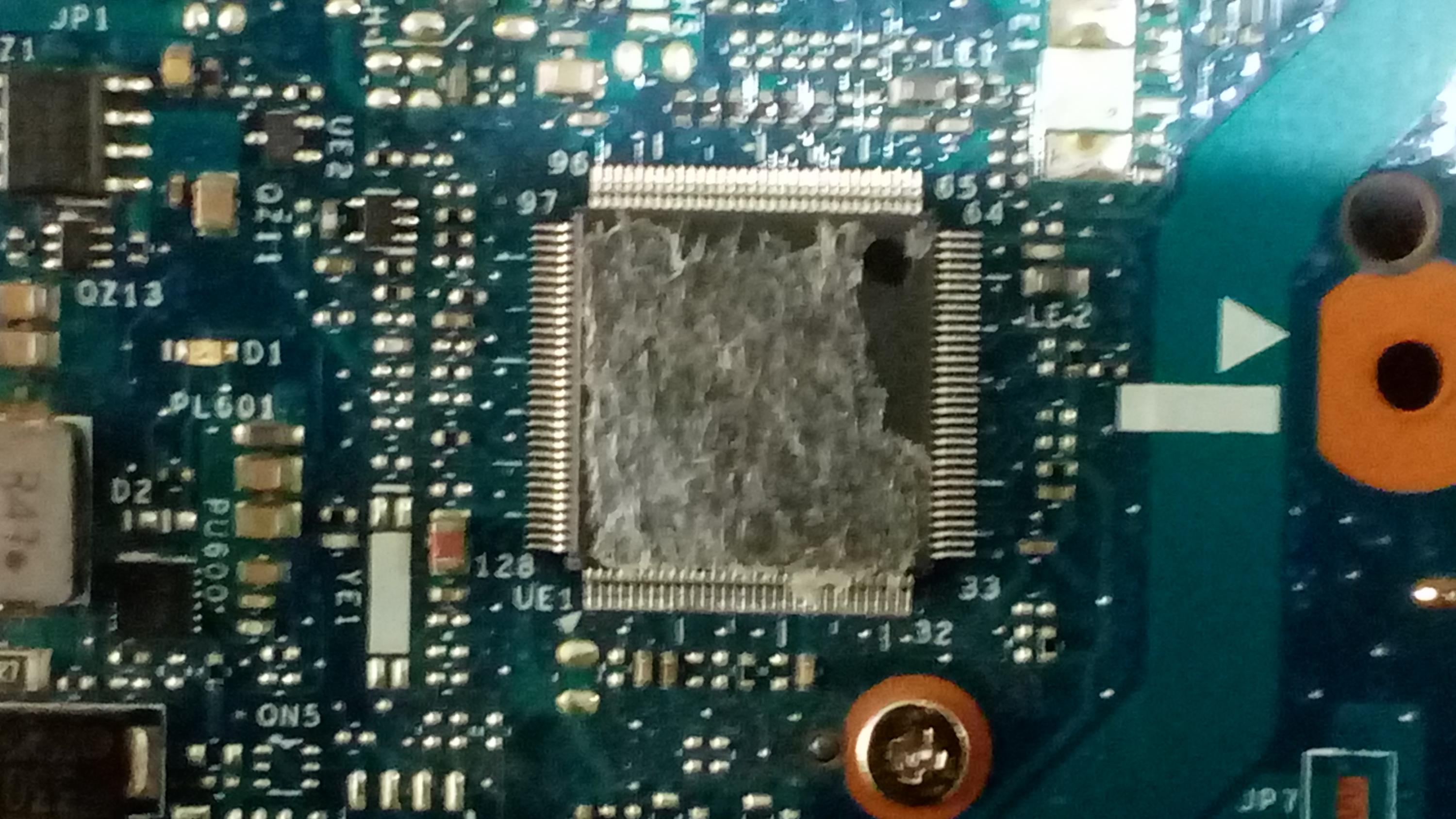

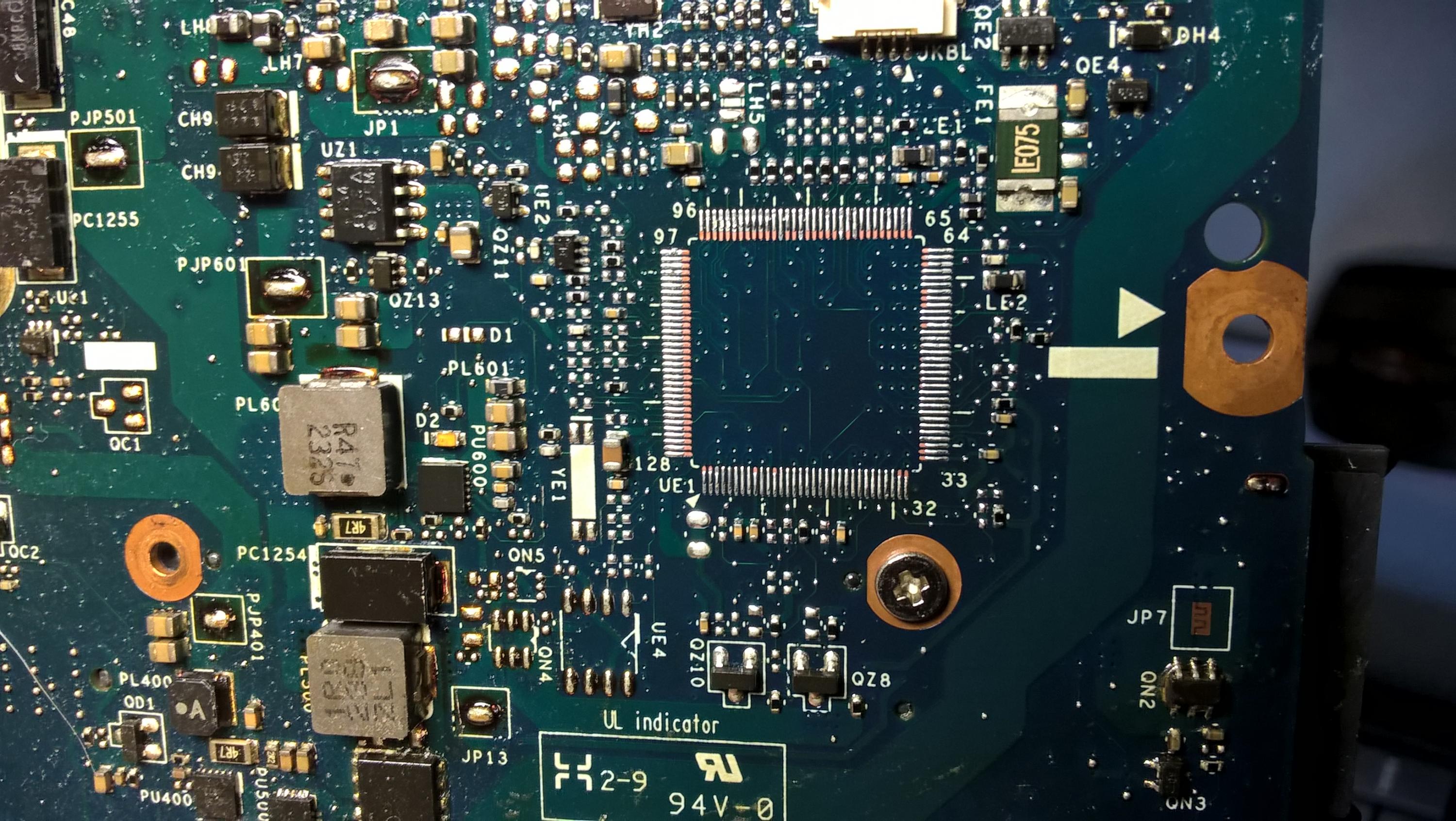

    Somebody please share images of LA-8241P motherboard. Image of SIO and surrounding components.

    see if it helps

      Hello, is this your board QCL00 LA-8241p?
      If yes, I could get clear images in 2 days.
      This SIO chip ENE KB9012QF A3 KB9012QFA3.

        Re: LA-8241P Images
        yes, my mobo is La-8241P

          Re: LA-8241P Images
          Here you go.

            Re: LA-8241P Images
            Thanks a lot, I fixed it.

                    Re: LA-8241P Images
                    @spleenharvester
                    Mine not short dead, but some of the component around SIO were missing.
