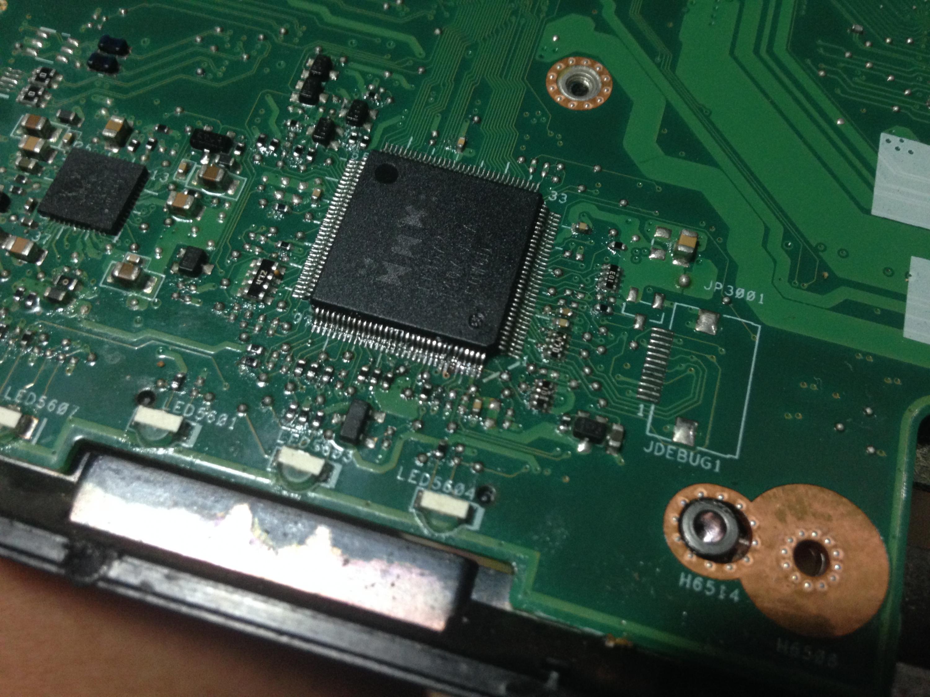

    hi everyone i got a laptop which was the sio chip removed maybe the other technician remove this but the problem is 3pads have remove on the board is there a way i can connect again the chip?please help

    good clear pictures of the area on the board will help us

      ok thanks for the response this is the image attached

        you can connect it,i see only one missing pad,it is 6th pin from the end(pin nr.123).You must look in schematic,maybe is not conected and under the pin was only free pad. Other pins carefully straighten with some pike tool and solder it back..fine solder tip,good flux and microscope-10minutes of work

          where should i connect the missing 123pin?
            Re: SIO remove pads on the board
            look in schematic for this board..if you dont have it,post the motherboard number
              board code is x450ep rev 2.0
                I see some pins are connected together. Do not plug power/battery into the laptop to avoid damaging the SIO.
                  i dont have schematic for this board but this one pin can be also not connected-not in use..separate the pins and solder it back to the board..leave the one unconected,i dont see any trace going to this pin
                    some pins looks like bend (or bent ) . check with good magnifier if they are isolated or touch other pins before give power. if so, better put a new one and use a bit of extra solder 60-37 without extra flux on the missing pad.
