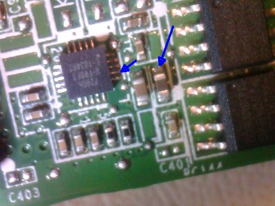

    laptop hp dv6-3132 dead, no lights at all
    When the power supply is plugged in there is power on the motherboard but no lights at all. I have removed the battery, which seems dead as well.
    I measure power on the section up to the first MOSfet switch which is turned off.
    There is power to at least one pin on the OZ8681 charge controller chip. This is where I am stuck as I can not find a data sheet for this chip and see how it works.
    Can anyone help pointing to spec sheet download. I have searched on the net for a couple of hours but admit defeat.
    Anyone that can explain roughly how that chip works? Mainly need to know if the DC supllied to the chip sends DC power out in the form of the VDDA and VDDP port signals?
    Still Trying to figure out how to attach circuit, my present laptop scrambles font when trying to browse for file.
    Last edited by starling22; 09-06-2017, 06:54 AM. Reason: added annotated charger circuit

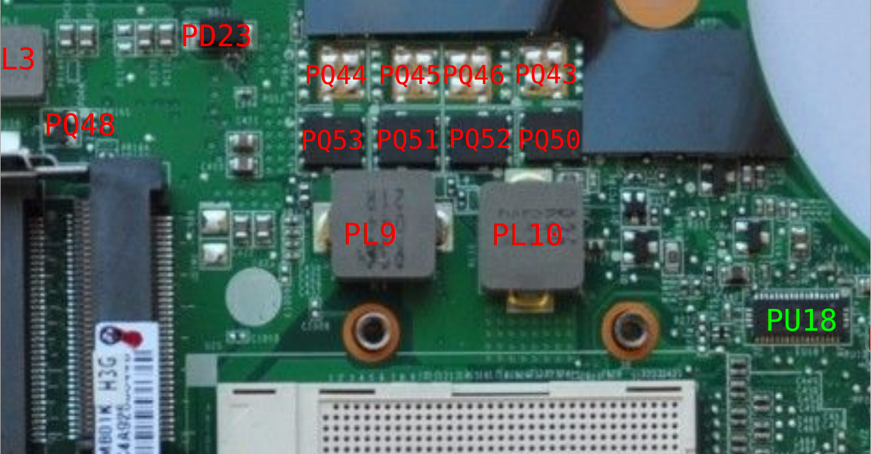

                        There is a diode of some sort, I don't think it is an ordinary diode. Designated PD23 a P4SMAJ20A. I found data sheet and attached copy looks like being a transorb or ? whatever. Initially I seemed to get diode behaviour but I went back and repositioned the board so I could get a bit more force on my needle probes. "Shorted diode".
                        Measuring between cathode and GND less than 10 mV, so also short, so the short is probably not the diode but some other component but could of course be the diode.
                        Assuming there is a short this suddenly looks like a lot more work???
                        Last edited by starling22; 09-07-2017, 11:39 PM. Reason: PD23 initial measurements were wrong, corrected

                          Ah yep if you've got a short on +VIN that could explain why PQ42 doesn't open… (at least I hope it's the cause)
                          PD23 is a TVS diode, it's designed to somewhat protect the circuit against voltage spikes. Those diodes let through all the current past a certain voltage (like a zener diode), and they can die in this case. Try to remove it and see if the short is still present.
                          If it's not the TVS diode, it can be pretty much anything else on the +VIN line. Most of the other power rails of the motherboard are created from +VIN using buck converters. You'll have to inject voltage on the +VIN line and find which component gets hot. Make sure to do that without any component connected to the board, start with 1V and check first if the PCH gets hot, you surely don't want to burn that. If it doesn't and nothing else gets hot, you can increase the voltage a little.

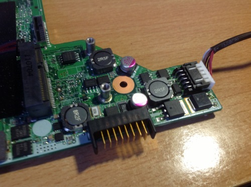

                            I have been counting capacitors on the +VIN rail, it amounts up. Well with a short on the board and heating up near the power entry it narrows the area a bit.
                            Basically the area on the picture attached here gets up to about 40 deg C, hot to the touch but no specific component.
                            Will get my little infrared temperature indicator out an try and see if this can pick a hot spot, small sensing area on the unit. The generated heat may of course not be due to the short either.
                            I have a variable power supply 3-27V 1 Amp with current limit as low as 20-50 mA and as well I can put a string of 1A rectifier diodes in series to get down to approximately 1V when current start flowing.

                              Re: laptop hp dv6-3132 dead, no lights at all
                              If the PCH and the GPU don't get hot, you can try increasing the voltage, maybe a couple of volts or more. It would be nice to monitor the current consumption.
                              PS: there is no picture attached.
                                Sorry about the picture missing, I think I got sidetracked looking for a really good picture of my motherboard so I can annotate the bigger components. A few days away from this work and I have forgotten where I got to, I put it down to old age.
                                Yes good point about keeping an eye on the current consumption. I have just had power on the board and measured 96-100 deg F, somehow I managed to change mode from deg C and forgotten how to change it back.
                                The board area that hots up now attached.

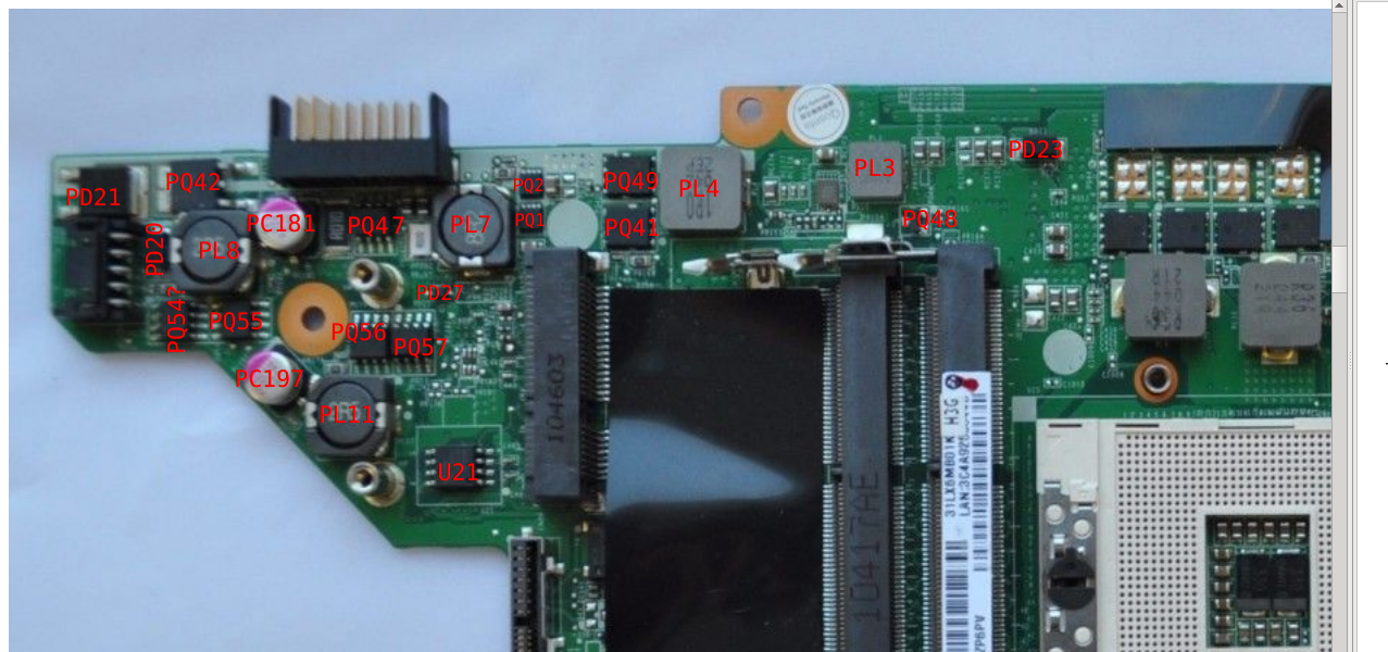

                                  I have spent time making a component identification map to help me manage what I have identified. Getting back to troubleshoot.
                                  When I apply power I find that PQ42, which is OFF, preventing +VIN. While it is off some current must be passing because it does get hot to the touch after a 1 to 2 minutes. The longer power is on the a greater area around the device also gets warm to the touch.
                                  I have got my power supply set to 3.2V, lowest I can go and set a current limit of 400mA. Applying power to the Cathode of PD23, a voltage of approximate 0.120V so the short seems to have some resistance.
                                  With this setup I can only go to about 0.9A. When I use the 0.9A setting I measure aproximately 0.350V. The ground reference changed to the two board support pads nearby (to the left of PD23, there is a sticker over the second ground hole area, see attachment) where I use alligator clamping.

                                        Power: 5A @ 1.68V ( app 8 watts) =>> 0.336 Ohms. My DVM uses 48 micramps, assuming the short is 0.336 ohms, the DVM would need to measure around 16 microvolt. Well my instrument would not be able to measure that low.
                                        I need to check the 8 MOSfets, initial check on one seems to be shorted but am having trouble figuring layout. I hope I am in the right area.
                                        Doing an ohms check in both direction shows roughly 10 mV in both directions for all 8 MOSFET devices.
                                        The device names almost invisible but I believe there are two types in pairs and from Fairchild
