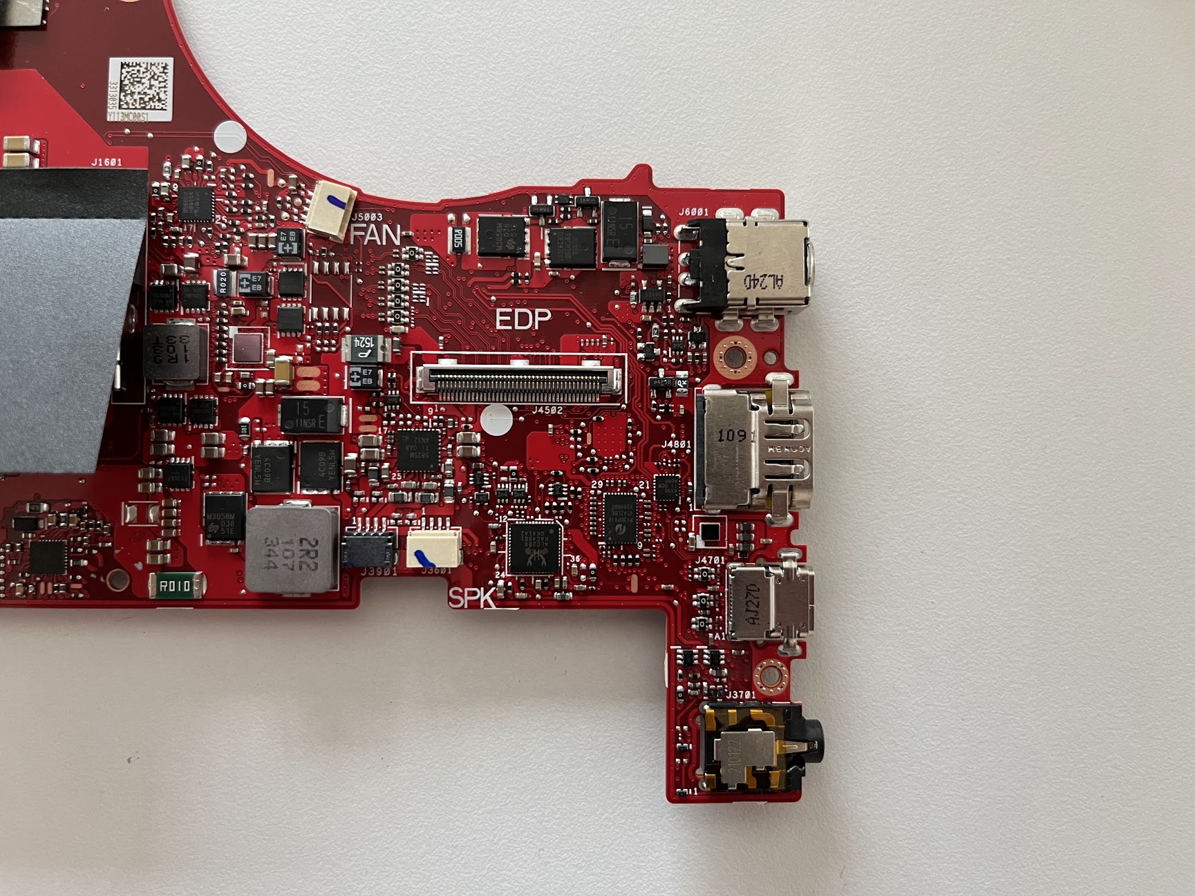

    Asus GA401QM dead, no lights.
    Yes, I know I had a similar laptop I fixed a while ago, don't blame me for picking up a new (dead) one
    This one shows no life with AC or USB-C charging. Reset CMOS, removed battery, and tried again, nothing. No lights, and no response when power on button is pressed.
    Measured DC In mosfets as good, and the board seemingly seems to supply 20V, 5V and 1.2V with my quick measurements. Battery is completely depleted, I believe this has disabled itself as my other battery also did. When DC is plugged in the GPU gets 45C and CPU VRM/Mosfets get to same temperature. CPU itself is cold.
    No immediate shorts on the board as I could find, but will need to dig deeper later.

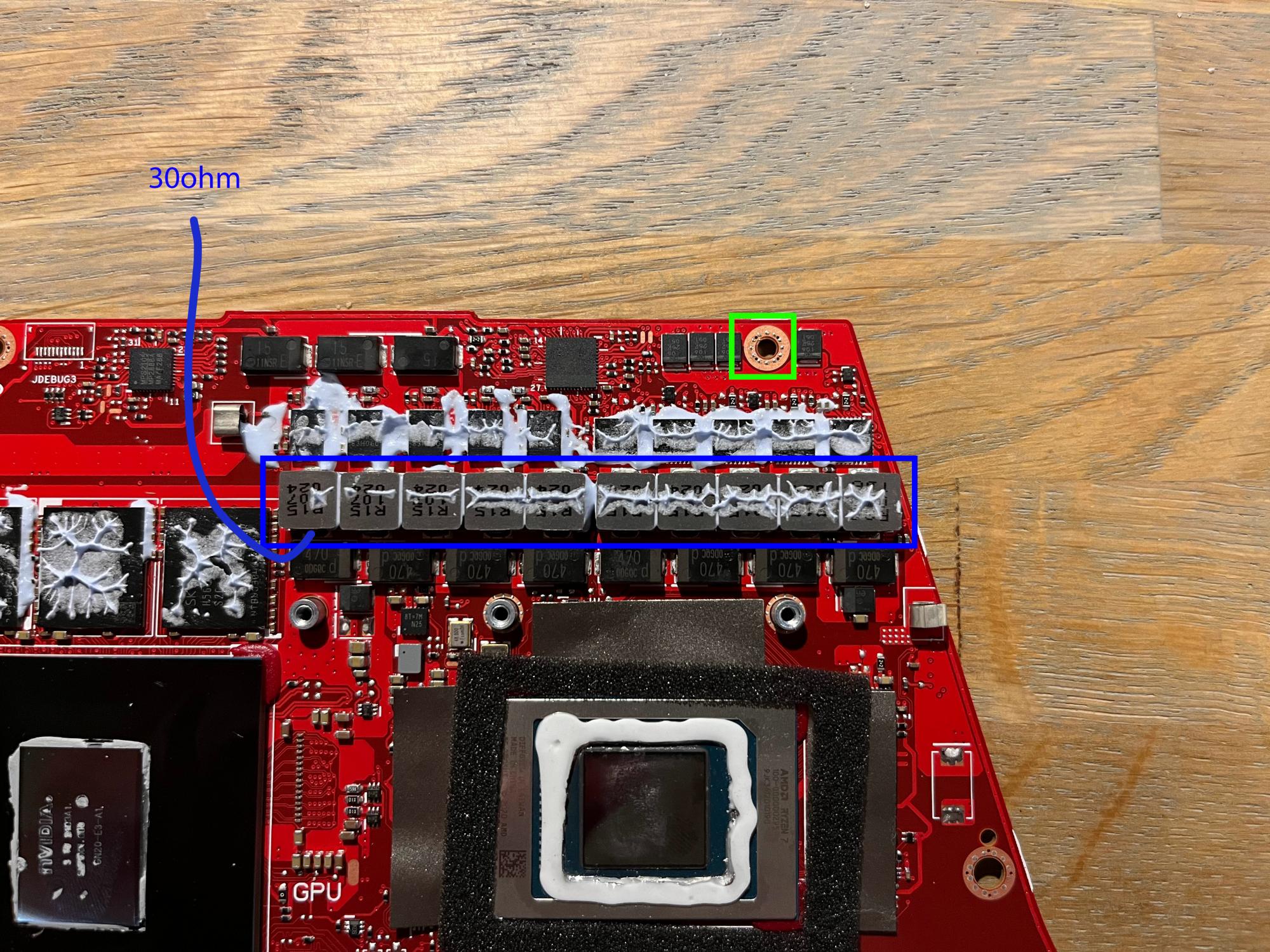

    Coils at CPU area measure 30-40ohm.

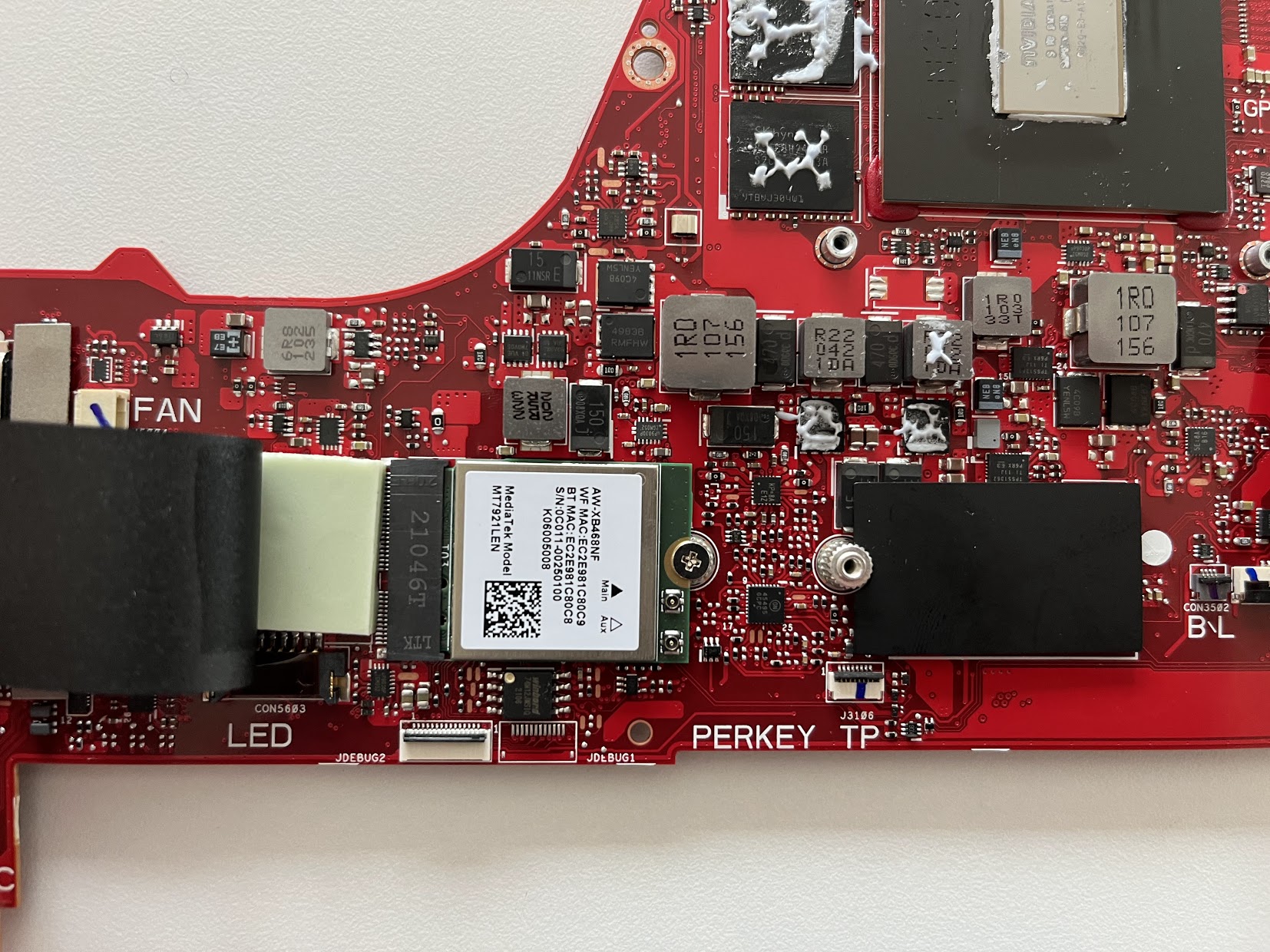

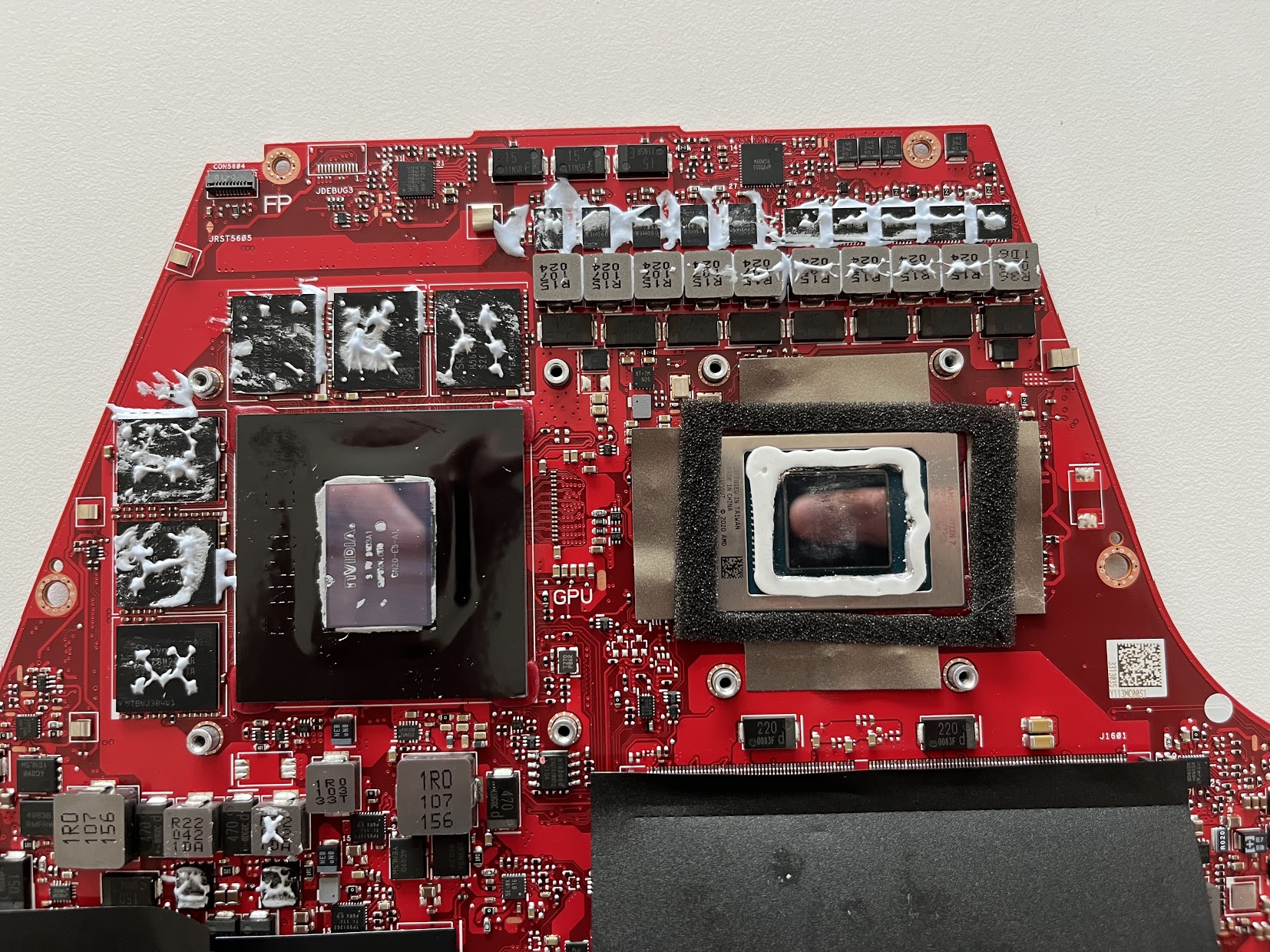

    The laptop is shipped with liquid metal on the CPU, and the cooler screws had been used, so the first thing I checked was for any leakage of the LM on the board, but I haven't found any.

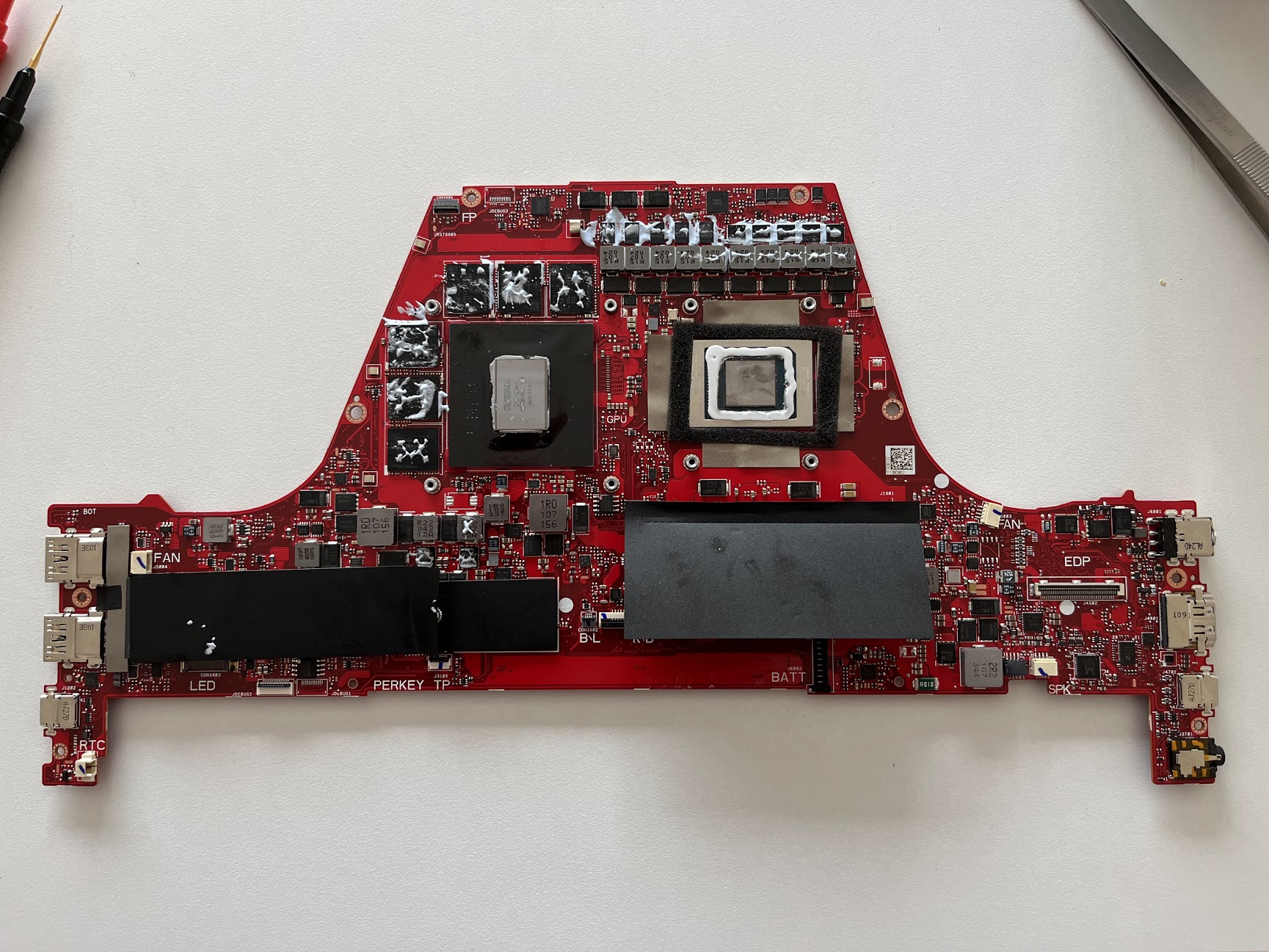

    I have attached some pictures of the board.
    What would be the correct way to tackle this board? Haven't had a board with no immediate short to correct.

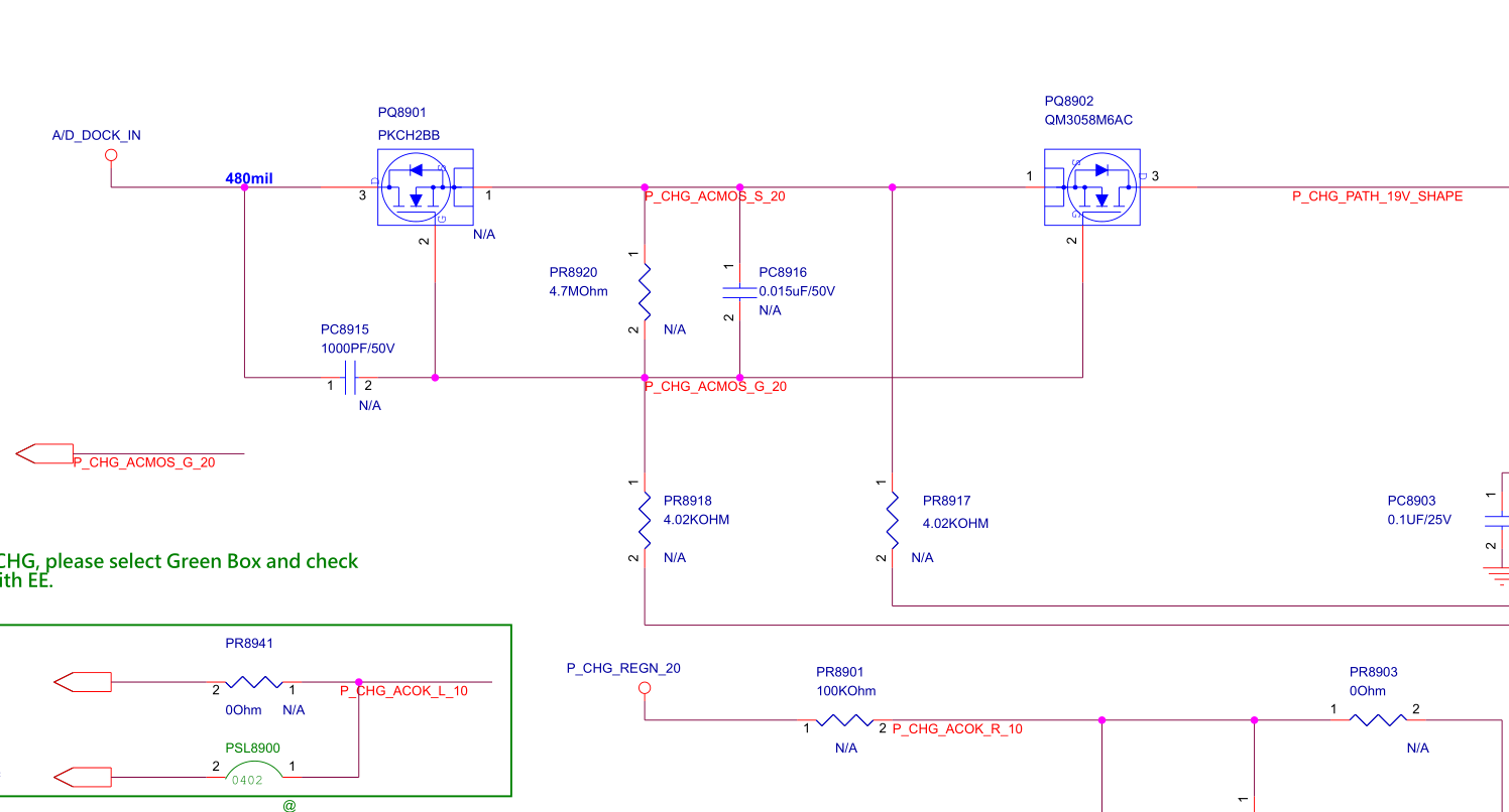

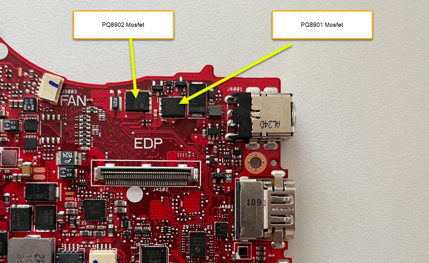

    See attached.
    The mosfets mated with the charger IC need to be reviewed. While they are passing through the voltage to the logic board, you may have defective mosfets.
    Start with, remove all power / no battery.
    Meter in resistance mode.
    Measure the resistance of each of the 2 x dcin mosfets as follows:
    Source (1-2-3) & drain (5-6-7-8)
    Source (1-2-3) & gate (4)
    Gate (4) & drain (5-6-7-8)
    Post each measurement and the meter scale used.

      PQ8901:
      S-D: 300kOhm
      S-G: 2.5Mohm
      D-G: 5.6Mohm
      PQ8920:
      S-D: 1.8Mohm
      S-G: 2.6Mohm
      D-G: 5Mohm
      Meter scale on Auto.
      Thanks!

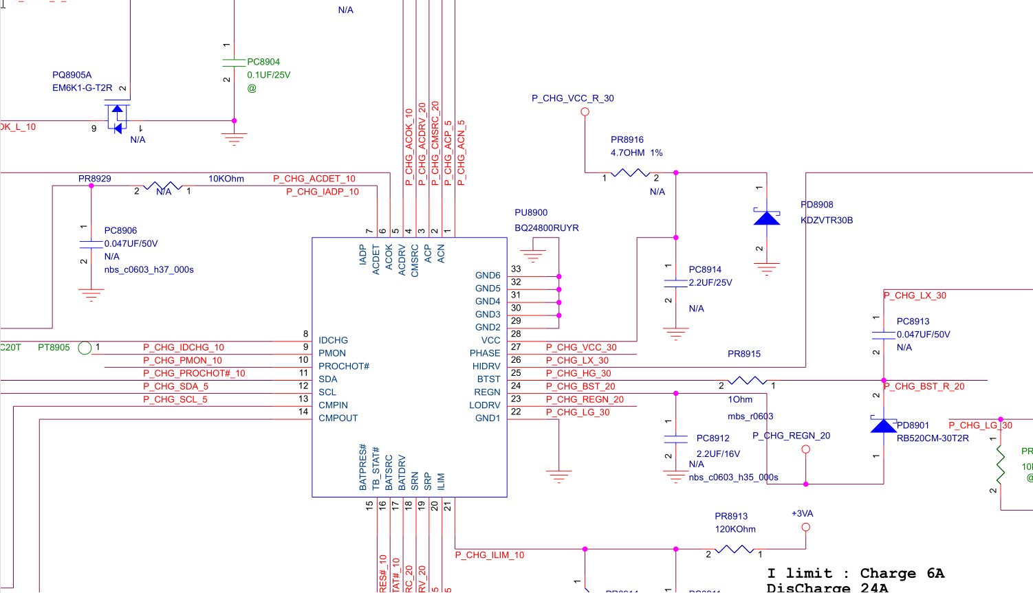

        To me, PQ8901 with the 300k ohm resistance, being low, is a suspect. Worth a replacement so that it can be as high as the 2nd mosfet.
        Measure very carefully and post the voltages on the charger IC (PU8900) with the adapter connected. For now, leave off the battery.
        Also, review the voltage on each coil with the adapter connected.

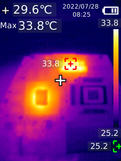

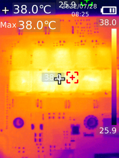

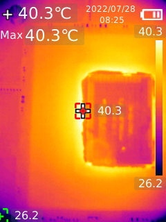

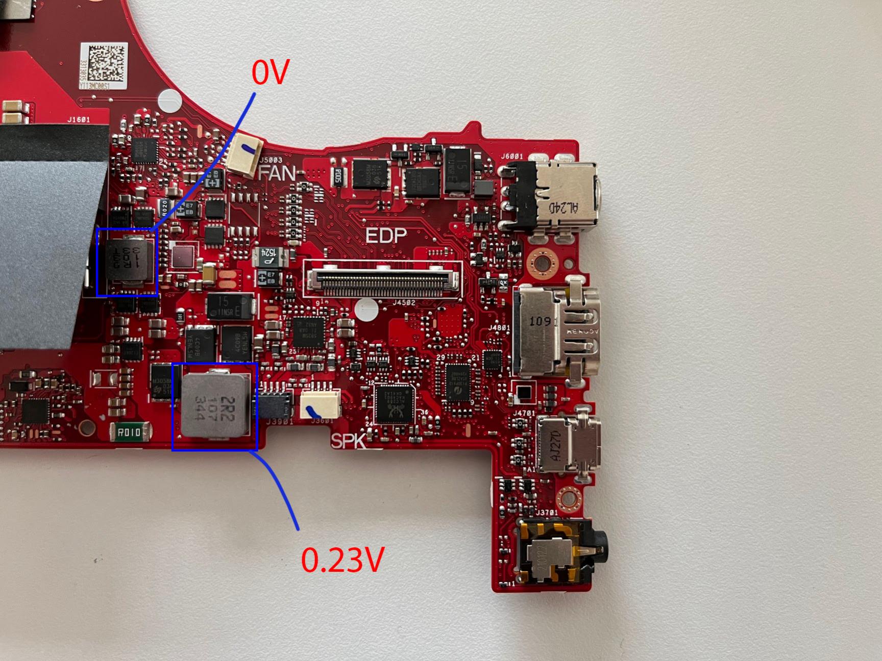

          It must have been a mistake from my side, double checked, and PQ8901 now shows the same Mohm resistance as PQ8902.
          The two coils on the right side measure very low or none. Left side coils measure fine at 3v3, 5v, 1.8 etc.
          See attached.
          I have also attached some thermal images of the whole board, and the individual coils at CPU area, and of the GPU.
          Charging IC measures:
          20V on ACC
          6V on ACOK
          26V on ACDRV
          20V on CMSRC
          So it seems fine?

            Re: Asus GA401QM dead, no lights.
            Voltages & revised resistance look ok.
            Lower coil = battery charge coil so ok that it has no voltage since the battery is not connected = coil PL8901.
            Other coil is PL9301 = secondary battery charger ?? (according to the schematic) - so this logic board has support for 2 x batteries ?

                            Could this be a dead CPU? How would I check that? The coils around the CPU has a low resistance, but thats normal, right? They are about 30 Ohms.
                            • mon2
                              • Dec 2019
                              • 14685
                              30 ohms is not a low resistance for CPUs. We thought we had one last week (Macbook A1398) where the resistance was 0.9-1 ohms. Working fine.
