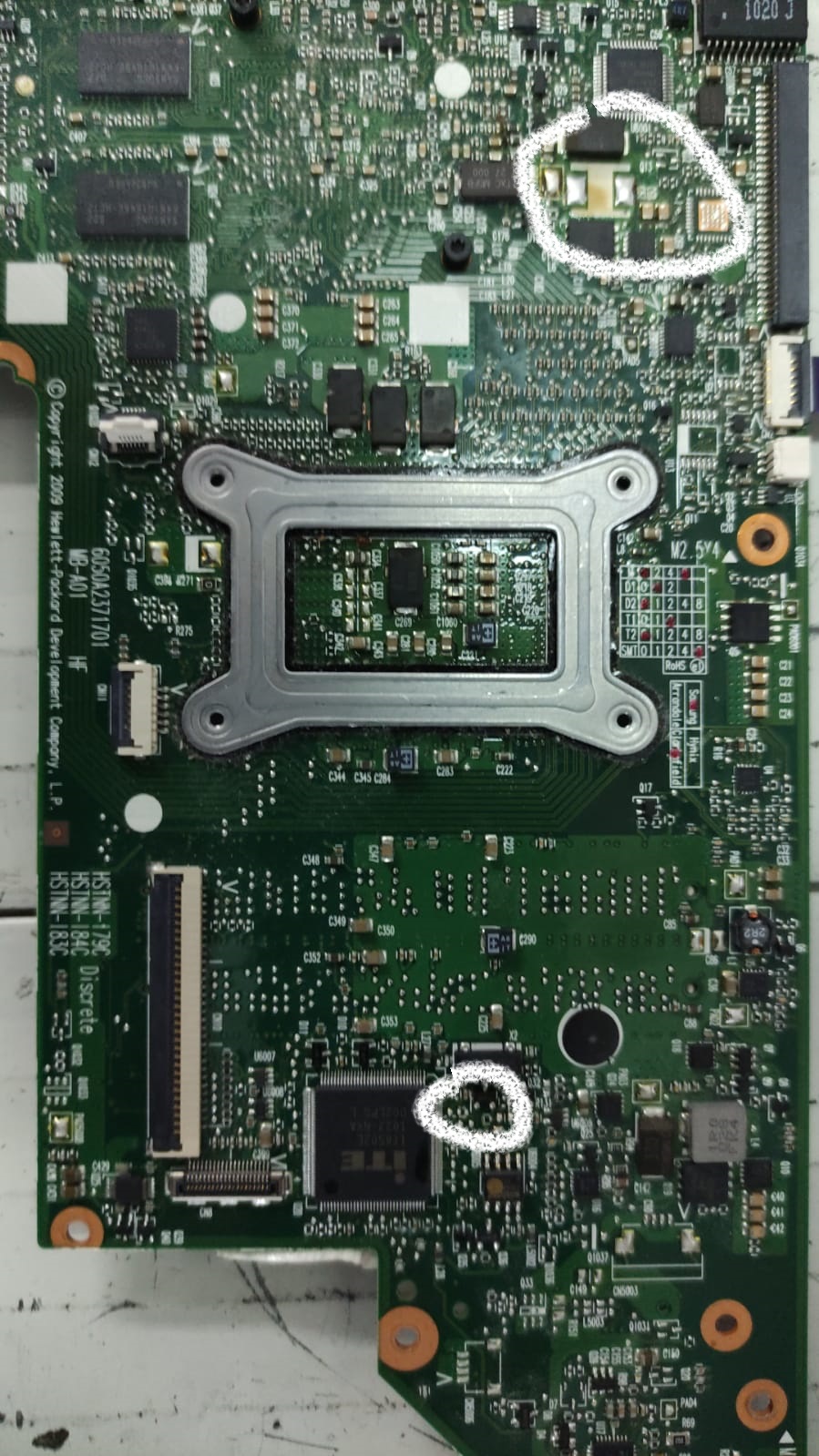

    Hi, is there any chance to convert this mobo to uma?
    hp dv3 mainboard 6050A2371701-MB-A01
    Re: hp dv3 dis to uma?

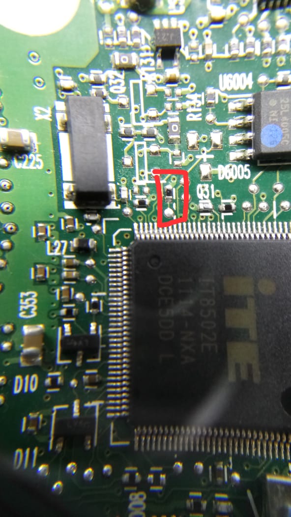

    I think its possible on this mb. Perhaps needs to move /change board id resistor near kbc ite8502. dont have schematics, so cant be sure. I did it on dm4 mobo which is very similar to yours. give it a try.
      Thanks for your answer.
      I have forced a low level on pin 2 of R166, (MB_ID2, pin119 of ITE) but nothing changes.
      I have also disconnected coil L6.
      Can you point me any other advice?

          I DO THE SAME REMOVED THE R119 AND I GO TO A NORMAL ... I WAS LUCKY.
          MY PLATE IS FROM UMA HP DM4 6050A2314301-MB-A04

              Sorry, I'm wrong. It's the R166..

                  Please help. Where are the location of R166 on mobo 6050a2371701 mb a01? Can someone send me a picture?

                      In my case laptop the conversion in Uma worked by removing R166 and inductor L6. My mainboard is 6050A2371701-MB-A01with i3 350M CPU

                          I succesfully converted my HP Pavilion dv3-4050et (Product no: WN975EA#AB8) to UMA. I removed resistor R166 and Inductor L6. It isn't necessary to remove heatsink or Mainboard. Just lift the faceplate (which includes Keyboard) and desolder the resistor and Inductor. Thats it.
