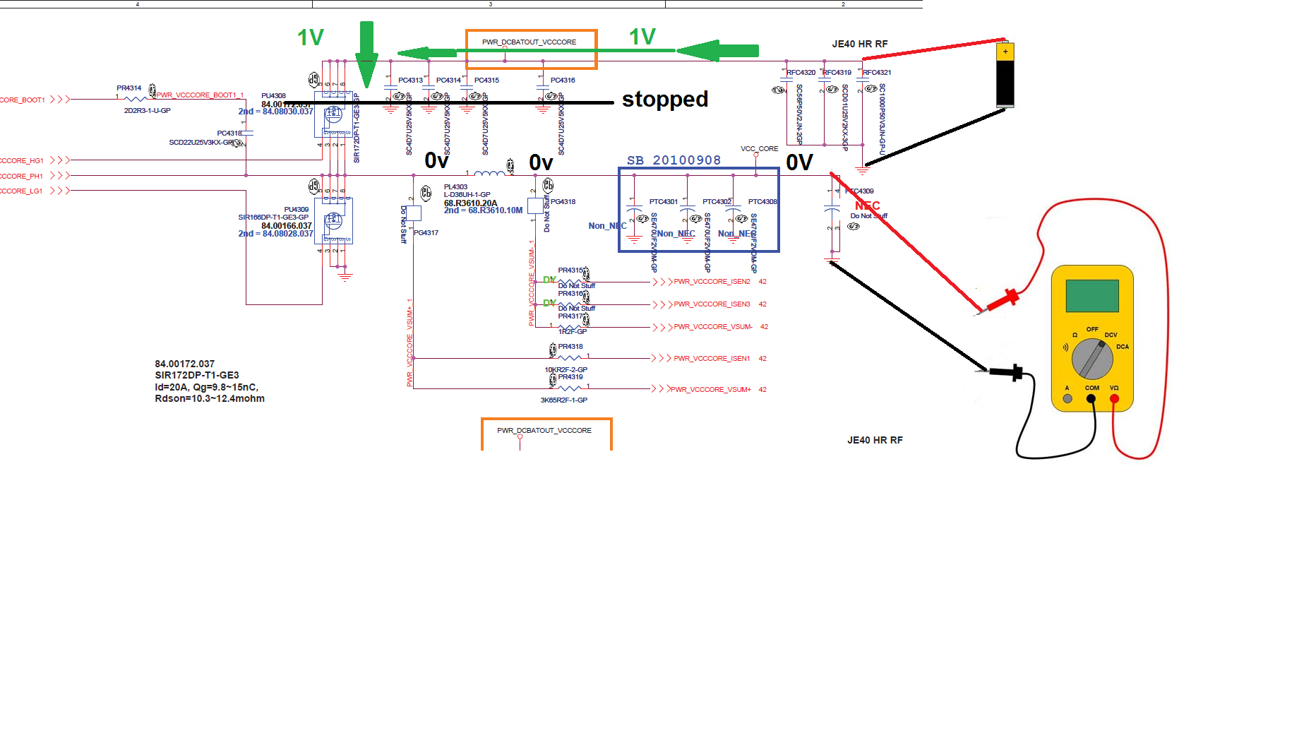

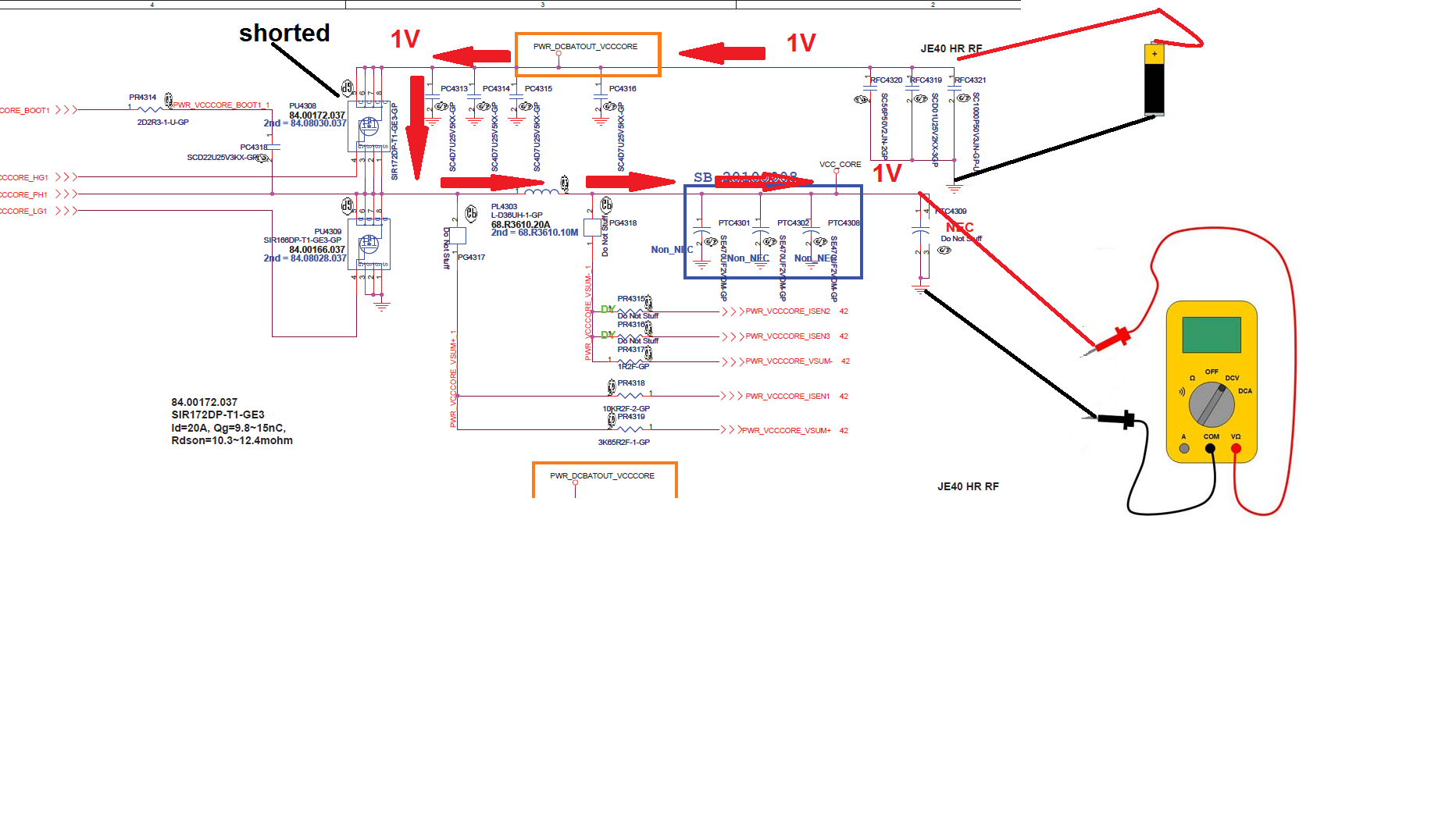

      I'm worry about High-side mosfets, probably one of those have been shorted.
        I don't think so with a 1.2ohm short to ground.

          It is a special version msata... Smsr150s3, it contains 2ssds that are on one PCB... If I connect that one to a normal msata, I only detect 1 of the 2ssds.. and they are configured in raid0 :-/
          Regarding the mosfet (damn autocorrect), which one you think could be shorted?

            About the short on the motherboard, maybe you could try to remove PR4004 and connect the batteries on the pin shorted to ground (should be pin 2)? Also, if the cables are heating up, use thicker cables. If the batteries are heating up, it means you're already drawing a lot of current so a component on the motherboard should get hot too. If you cannot locate the short with batteries, you could try to use an ATX power supply, but most of the time they will turn off due to the overcurrent condition.

              1.2 ohm and U6202 probably was clue, since more than one pieces dual N-channel mosfets on this mobo.
              I suspect 5v line was shorted too
              That was good idea to measure resistance versus gnd on every coils/inductors first.
