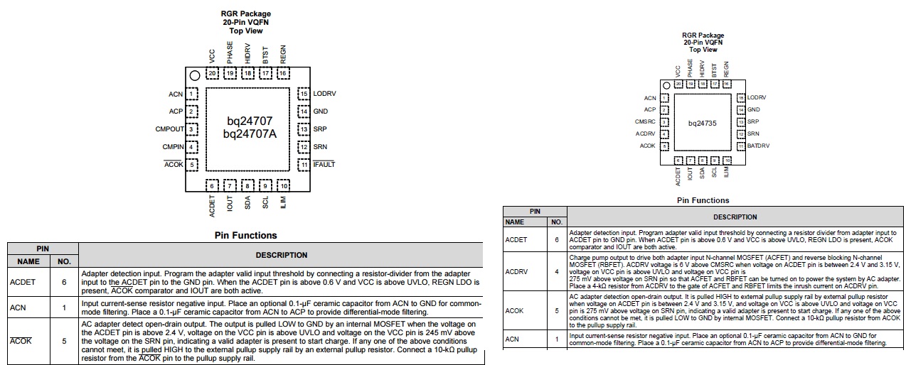

    I have a dell that fails to charge batteries.
    The charger circuit is BQ24737 [the schematic shows different part, also I could only find a datasheet of BQ24735].
    I could narrow my search at the fact that ACOK is 0V [the pull up resistor PR4434 is ok and gets the 3D3V_AUX_S5].
    ACDET is 2,44V
    VCC is 19,55V
    SRN is 2,6V [without battery]
    datasheet says:
    voltage on VCC is 275 mV above voltage on SRN pin, indicating a valid adapter is present to start charge
    but this makes no sense as VCC is much above the battery voltage.
    what am I missing?

    It is not 735
    For me it looks like 707
    https://cdn.badcaps-static.com/pdfs/...107dc7e515.pdf

      ktmmotocross was right, ACOK should be LOW, because the signal should not trigger PWR_CHG_ACOK to pulling down to GND.

                    BQ707, BQ727 need ACOK LOW
                    BQ725, BQ735 need ACOK HIGH
                    Check datasheet again!
                    And a few different the pin out also I think New of the IC only for support Turbo Boost Mode.

                        707 and 735 cannot be interchanged.

                          So in my case could somebody replaced 707 with 735 before?
                          The 707 seems the correct one?

                            maybe u post wrong schematic

                                that picture confirms that the 737 is the correct one
