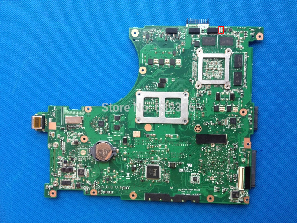

    Post some high resolution picture of the motherboard and circle the spot where you found water.
    Check for a short at the power jack between + and ground.

          Re: Waterdamaged Asus N56VB - no power
          Check for a short to ground on the AC_BAT_SYS line. There are many points where you can take a mesurement, for example on the current sense resistor I squared in red.
