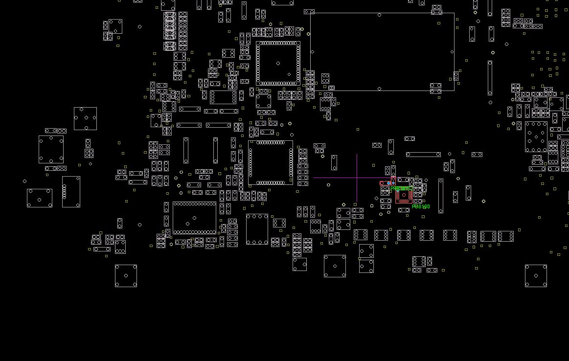

            Re: ASUS N56VM no power
            So far i've checked that the mosfets near the dc jack (PQ8801 and PQ8802) are switching ok, and that i can't detect any 5v or 3v anywhere on the board.
            Looking at the repair guide i should be checking RT8206A, but i can't find it listed in the boardview on boardviewer and there isn't a search function. Can someone point me in the right direction please?
                              I don't know as i can't find RT8206A on the boardview to test it, it doesn't seem to be listed which is where i got stuck.
                              The motherboard is an Asus N56VM Main board Rev 2.3, above that it says tmt YA-4A 1, E114139, 94V-0

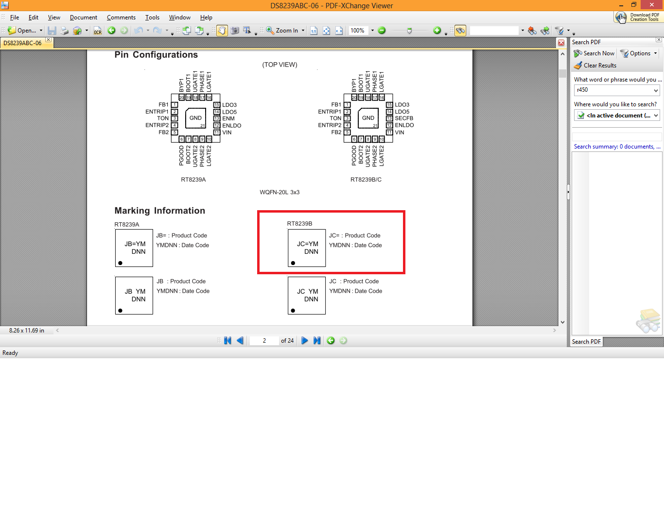

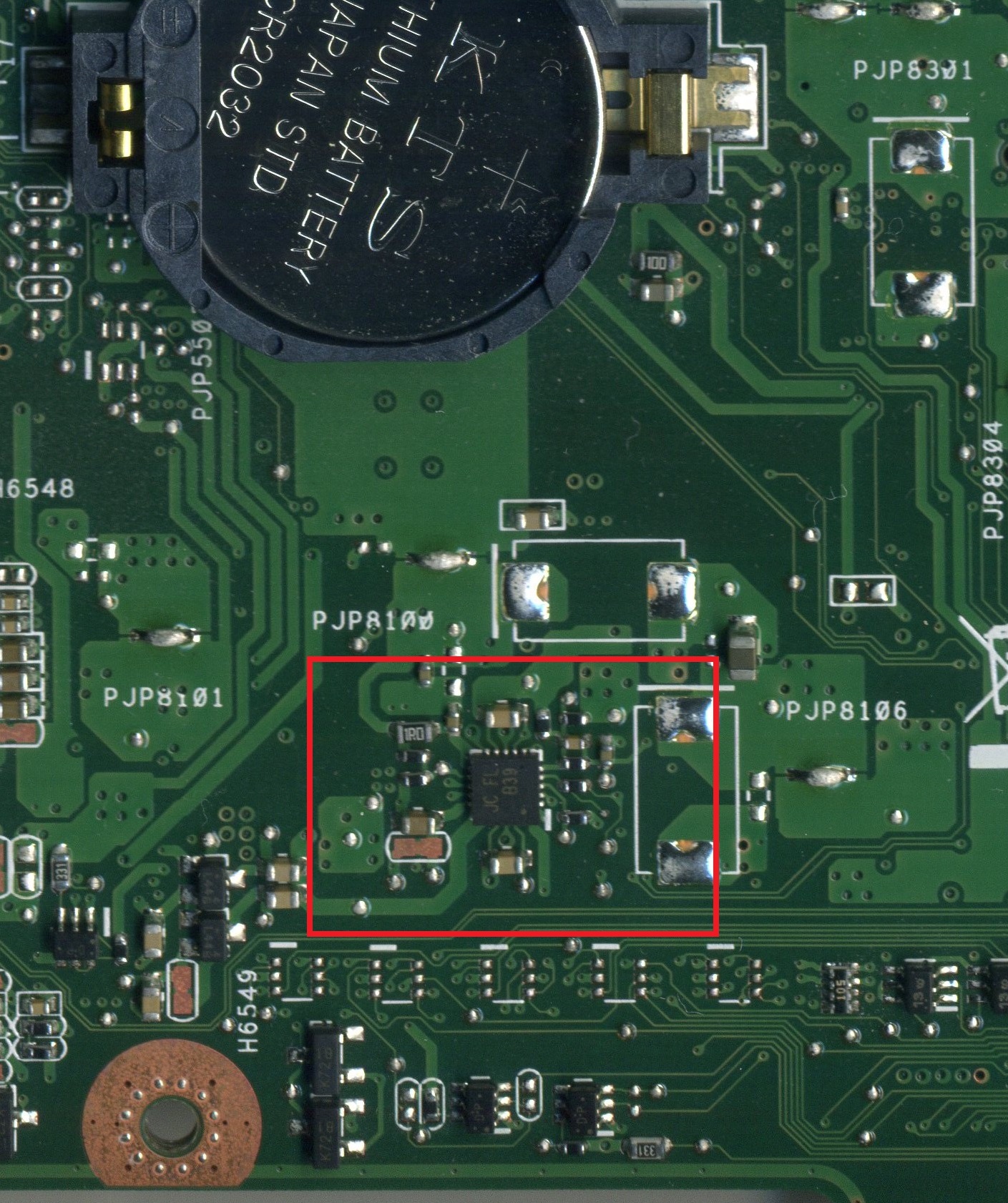

                                https://drive.google.com/folderview?id= ... sp = sharing
                                credit [Ruv] Yuri Rogachev http://notebook1.ru
                                Rt8239B is responsible for SMPS 3V and 5V

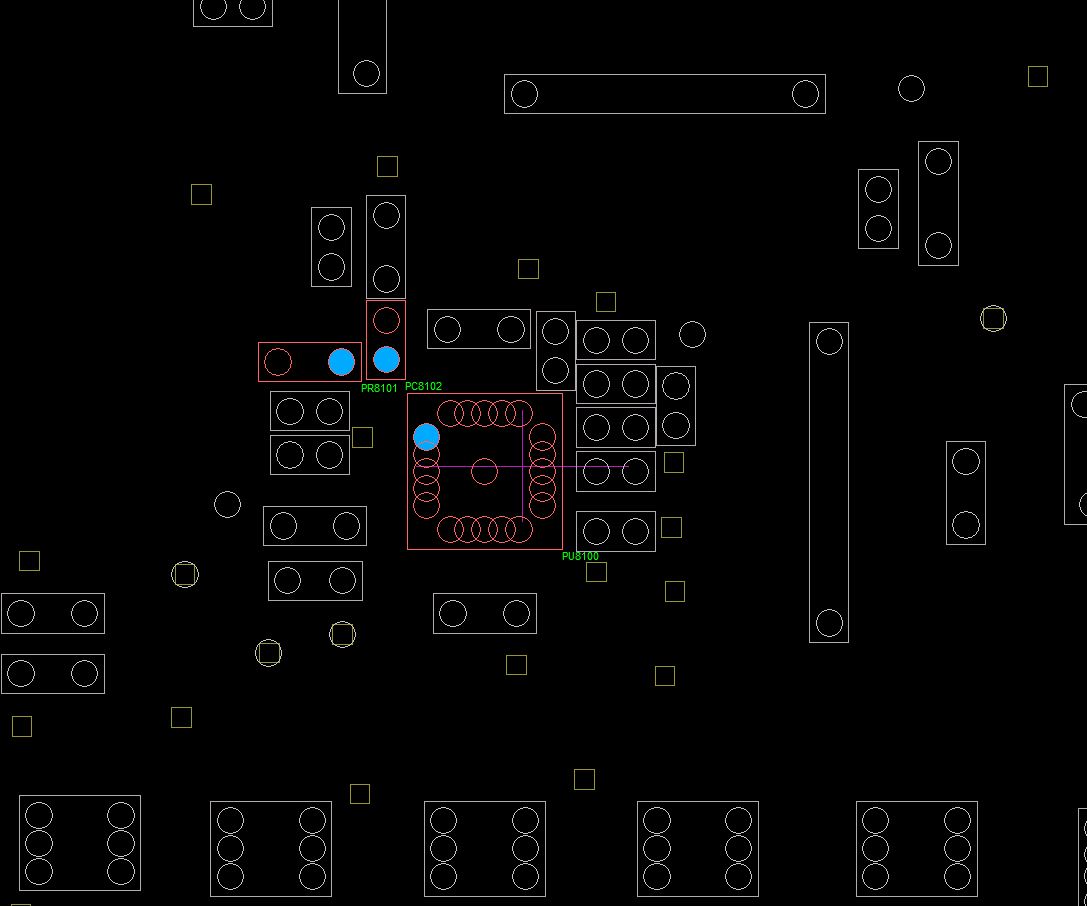

                                  VIN at pin 11, see pics point in light blu.
                                  however this type of card is not easy to understand, especially with the boardview in .asc
                                  If you have another type of boardview post it.
                                  Be careful when detect voltage not to short other pins.
                                        Hi
                                        I am having quite same issue with a N56VM board too.
                                        i have a Ver 2.3 board.
                                        originally, i had a short on AC_BAT_SYS, that went to CPU_VCORE (3 mosfets changed, and CPU dead,)
                                        There is still a short on CPU_VCORE as soon as i plug any CPU
                                        so i guess there is a short after CPU too(that may have originated the VCORE mosfets to blow)
                                        i will see this later,
                                        i plugged NO CPU,
                                        now i have +3VO at 0Volts (no short), but +3VAO and +3VA are present, so i am confused
                                        5 volts are all present.
                                        i changed PU8100 RT8239BZQW, still same.
                                        Power button has power (3V)
                                        BIOS chip too.
                                        so, wich signal is my PU8100 missing to get +3VO ?
