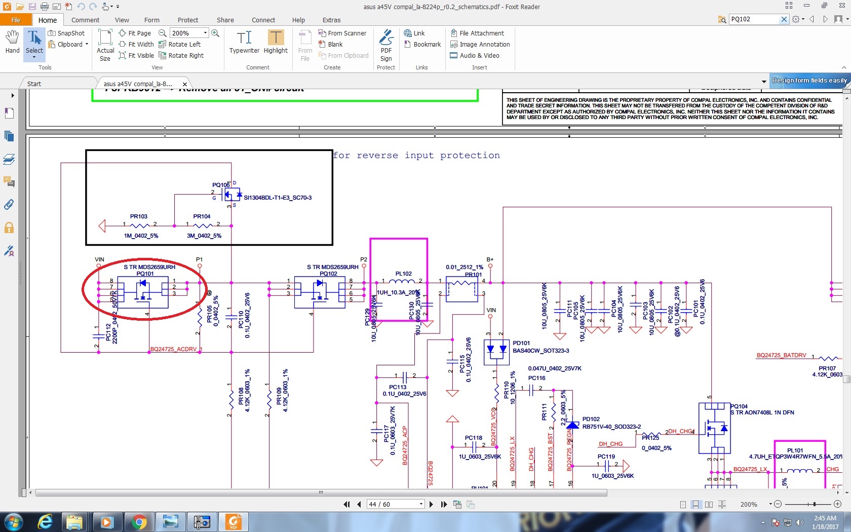

    Hello There i have repair Asus A45V (K45VM).
    Problem: can power only on Battery- but can charging also- cannot work on standalone if i plug only the charger? to weird....
    Primary Check.
    1. Check Adaptor Charger ok and i replace a new tested one. same 19v-4.74A,not lock
    2. check the charging terminal - okey have 19v out.
    Any Technical Idea?

      I already check.
      but i have notice the Voltage of this?
      The Unit turn off, Plug-in The Adapter, the i Check (PQ 101).
      using Digital Tester...
      123 - S - 19Vdc
      4 - G - 24.7Vdc
      5678 -D - 19Vdc
      here the image
      and also here the Schematic
        Re: Asus A45V (K45VM)Can Power Only in Battery???
        how many voltage you receiving on pl102 or PR101?
        check shortage on PQ106 and PQ101? remove these FETs and and check on meter?
            If your PQ101 PQ102 and PQ106 are OK then you have ACDRV (pin#4) problem on IC BQ24725.
            also check pin#6 ACDET on IC BQ24725 which must be voltage something 2.6 volts.
                  Charger Plug-in
                  test Prove black for Gnd
                  RED for the Following
                  ACDRV (pin#4)= 19.2V
                  ACDET (pin#6)= v2.6V
                  Do you think this IC Have Problem.
                  anyway tgis type of IC prod code is BQ25A
                    check voltage on ACOK pin#5 of the BQ25?
                    are you receiving 3volts on switch when plug the charger only?

                                if I Check on the Unit using battery then i Plug the Charger adapter. check the voltage of PQ101. no Valtage at PQ101?
                                Something does not make sense about no Voltage on PQ101 because D is connected to Vin which is the supply Voltage from DC input jack from the AC adapter.
                                So the B+ at PR101 shows 19V when adapter is connected (without batteries) and stay at 19V when power button is actuated, right?
                                And the same B+ point shows about 10V (batteries Voltage) when on Batteries only, right?
                                  Yes Sir. have only power on battery. how can i do?
                                    Sorry but I do not understand your answer.
                                    So are you saying that when the AC adapter is connected to the lap top, the DCV at the Drain pin of PQ101 (which is connected to the DC input jack of the laptop) has ZERO VDC?
