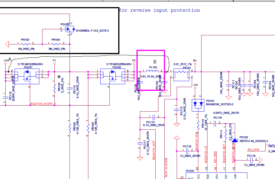

Asus A45V (K45VM)Can Power Only in Battery???
Re: Asus A45V (K45VM)Can Power Only in Battery???
Sir Here The Result -
A = 0 Zero
B = 0 Zero
Which is a Culprit Parts?
ThanksComment
Sorry Sir. smali. i put wire on point A to point B as you Said.( Tap A to B)
- i plug in the charger adapter. then i press power on can't turn on
nothing Happen...Comment
