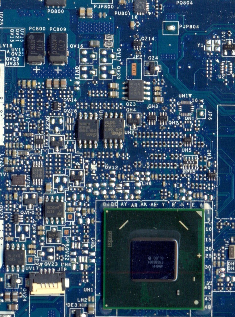

          This is FullHD album photos for my mobo (LA-8241P)
          its same just with dGPU Dell Inspiron 7520 model
          >> http://www.thienbui.com/media/albums...-la-8241p.161/ <<

                            this is the bios chips zone (not taken by me) cuz i cant take a good photo with my mobile camera its shit quality im sorry its same as mean dnt wry >> in attachment <<
                            im already measured Mr. with & w/o bios chips same voltages from 1 : 8
                            all = 1.5V : 1.6V (except pin 4) i mean all even pin 2 as u said should be around 1v
                            so now im pretty sure it's from this zone or from power zone relate to it
                            you better than me :-)

                              so one bios is 16mbit and the other 32mbit. did u put them back properly ?
                              check all resistor near them if they are in good place...
                              u removed bios with hot air ? maybe u moved some resistor in wrong place...

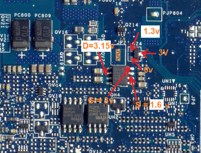

                                    measure voltages of qz3 and qz4. problem must be here.
                                    • AGmR
                                      • Nov 2016
                                      • 22
                                      • The mother of the world
                                      Re: Dell Vostro 3560 no power :'(
                                      QZ3 & QZ4 voltages..
                                      • dellxps15
                                        • Feb 2014
                                        • 1598
                                        • italy
                                        problem is qz3 gate.
                                        check rz7 value (remember to remove power supply.
                                        it should be 470k
                                        check also rz8 voltage both side.
