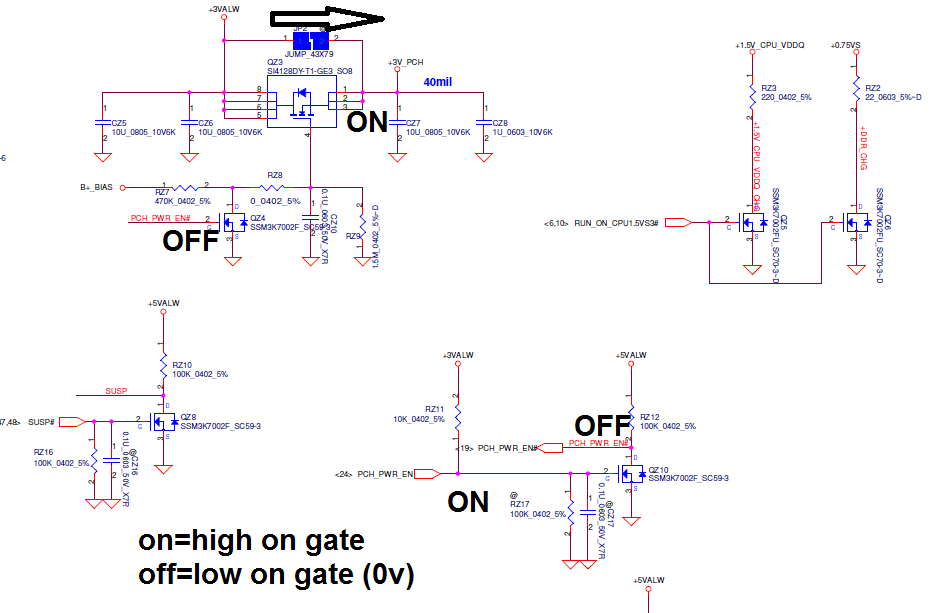

Dell Vostro 3560 no power :'(

      sry but u mean problem is qz4 gate or qz3 ? cuz the qz3 gate is 3v, so ..

        qz3 i mean. gate should be higher as it should be 19 volt (if im right)
        try remove qz3 and measure voltages of qz3 pin 1-2-3, 4, 5-6-7-8 and report back

            So QZ3 it self is good (tested out board by method 6 measures and only one read >> cuz i just was know it before )
            so on board pins 1-2-3 S = 0v, 4 G = 2.65v & 5-6-7-8 D = 3.15v
            about resistor out board = .275M ohm ( i think its not this one should = 1.5M )

                I think the gate QZ4 seem weird too, Why only 1.3V. its should be 5V, Right?
                @AGmR you can compare with QZ9 (if its working properly as well)
                After PCH_PWR_EN signal be HIGH (3V), QZ10 generate signal PCH_PWR_EN# from RZ12 (I think should be 5V of course its only signal after the resistor). Consider to check QZ10.
                And the gate QZ3 maybe around 15V, RZ7 and RZ9 act as voltage divider.

                    #29
                    Re: Dell Vostro 3560 no power :'(
                    oh yes thats right QZ9 G= 5v
                    >> QZ10 D=1.3v & G= 2.3v
                    good explain about G QZ3 VD i got the point now

                      #30
                      the # on pch power enable means it has to be 0 volt when present.
                      so qz7 qz9 should be the same as qz3 qz4. chech and report any difference in voltages between them.
                      remove qz3 and report voltages pin.

                        #31
                        This tests when QZ3 out board now
                        QZ7 : (D 3.15v) (G 0v) (S 0v)
                        QZ9 : (D 0v) (G 5v) (S 0v)
                        QZ4 : (D 2.66v) (G 1.3) (S 0v)
                        QZ3 removed, voltages pins : (D 3v) (G 2.66v) (S 0v)
                        QZ3 (on board) : (D 3.15v) (G 3v) (S 1.6v)

                          #32
                          You're correct, so I've give wrong explanation about that.
                          So, that's mean the correct voltage/signal must be 0V on gate QZ4. after that B+_bias not pulling to ground. Thanks to correct my statement.

                            #33
                            Should be like this:
