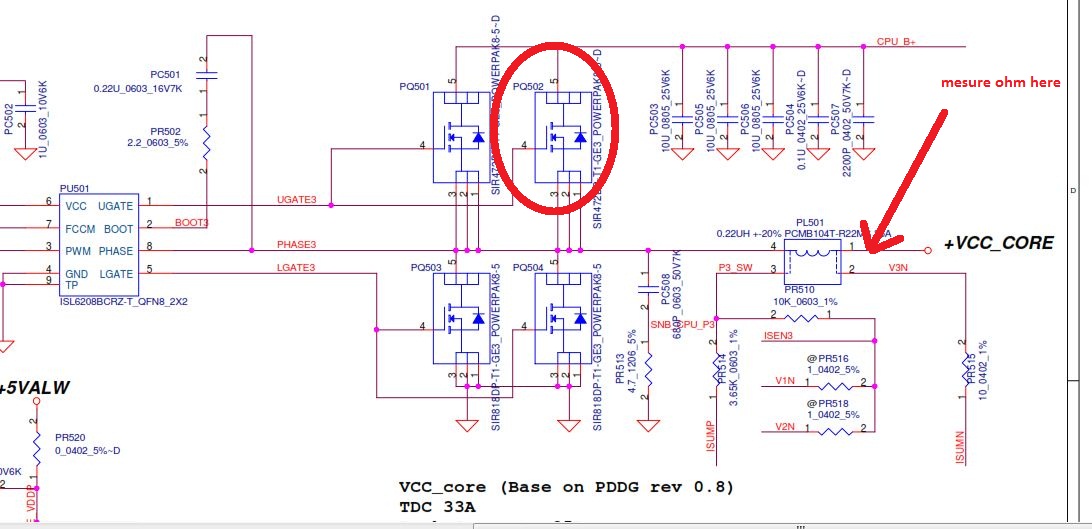

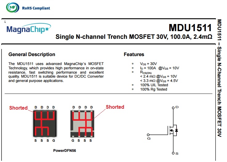

    Hello Guys,
    i have a Problem with my Alienware 17 (R5), it´s the LA-9331P Board. I dont know excactly what happend with this Alienware i got it functionless. I detected that the Power Supply was faulty (it was a DA180PM111 19,5V / 9,23A), so the Notebook didnt started. I bought a new Power Supply, it is a mtXtec 0J211H 19,5V / 12,3A. When i pluged the Power Cord to the Laptop something blown. It was the PQ502 - MDU1516 which burn out. Could someone tell me what could be the reason? I measured the Voltage on the 0J211H, for less then one second i have about 30V, and then it varies between 18V - 22V.
    Can someone tell me if the Power Supply is faulty? I checked the manuel of the MDU1516, he should take up to 30V max. So why is he blown?
    Greets, Grishnackh

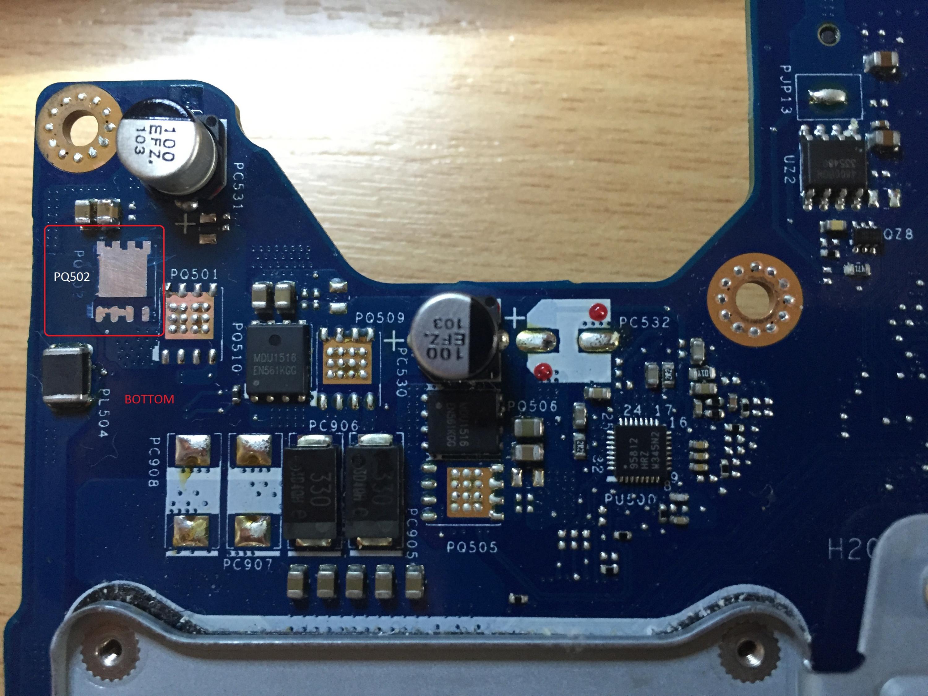

    Re: Alienware 17 (R5) shorted Mosfet
    we need schematic.
    • polytek
      • Dec 2013
      • 496
      • TUNISIA
      check your cpu PQ502 cpu vcc
      here is the sch:
      [MOD EDIT] Link to schematic https://www.badcaps.net/forum/troubl...331p-schematic

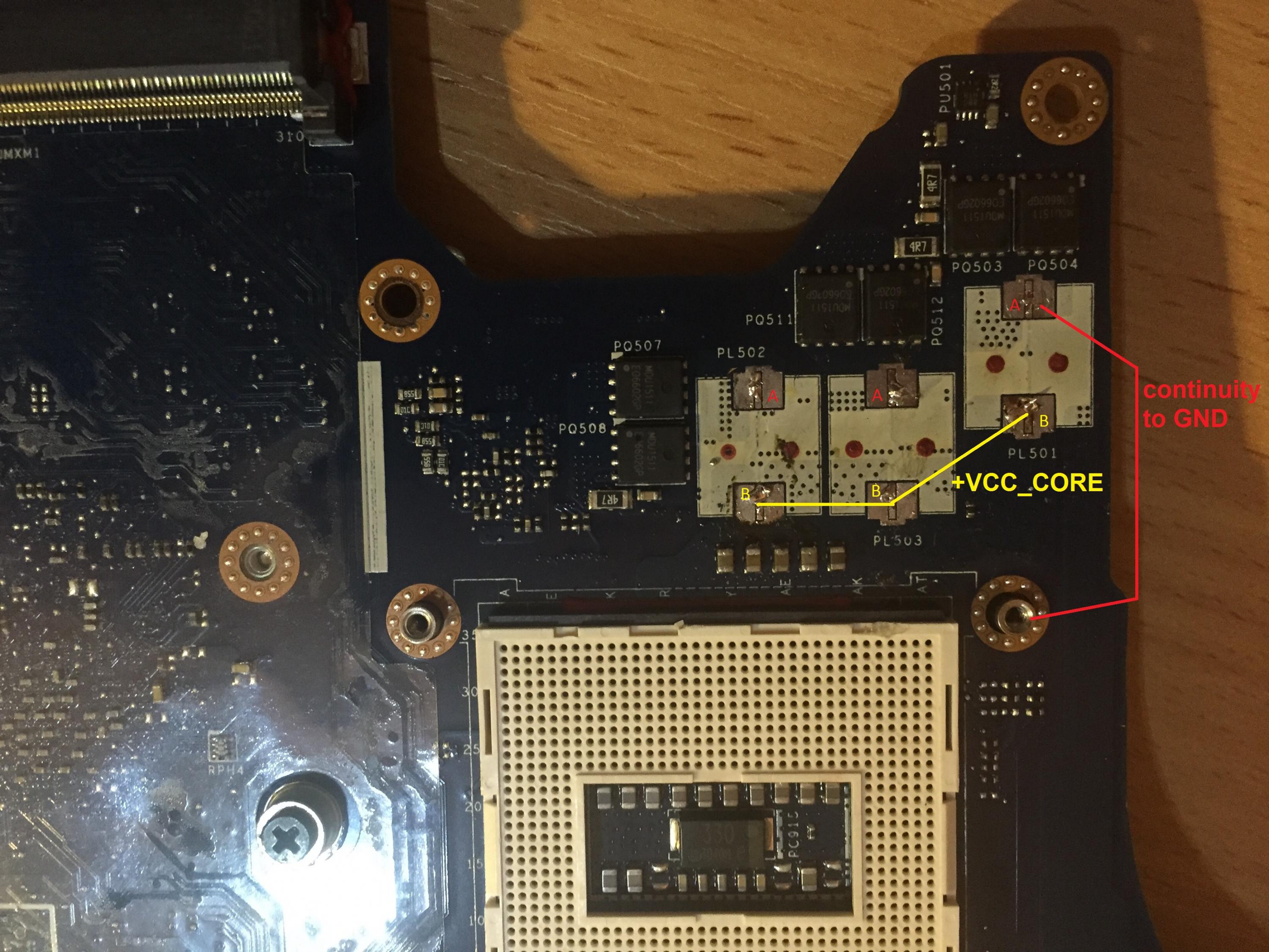

        @polytek - thank you for you help, i measured the ohm - like shown in your picture - to ground, and it´s about 0,2 Ohm. I hope i did it correct, because it has only two pins (see picture). Should i measure the voltage too? I am afraid to burn another mosfet - i already removed the burned PQ502.
        Greets, Grishnackh
          hello
          where did you measure 0.2ohm?between pl501 and ground?
          do this measurements(before that remove the cpu):
          pq502 pin4 and gnd
          pq502 pins1,2,3 and gnd
          pq502 pins5,6,7,8 and gnd
          pq502 pins1,2,3 and pins5,6,7,8
          • Grishnackh
            • Jul 2016
            • 22
            • Austria
            Originally posted by koresi
            hello
            pq502 pin4 and gnd
            pl501 to ground -> 0,1-0,2 Ohm
            pl502 to ground -> 0,1-0,2 Ohm
            pq502 pin4 and gnd -> 22 MOhm
            pq502 pins1,2,3 and gnd -> 0,4 Ohm
            pq502 pins5,6,7,8 and gnd -> 33 MOhm
            pq502 pins1,2,3 and pins5,6,7,8 -> 19 MOhm
            Greets, Grishnackh
                ok,so you have a shorted component on +vcc_core signal.you have to check all components connected on +vcc_core and ground.on the left side of pl501,pl502,pl503 you have pq503,pq504,pq507,pq508,pq5011,pq512,pu500.On the right side you have a bunch of capacitors :pc900,pc901....
                if you can't measure the faulty one all you can do is remove one,measure,put it back and so on until the short goes away(the measurement has to be tens or hundreds of kohms).
                goodluck.

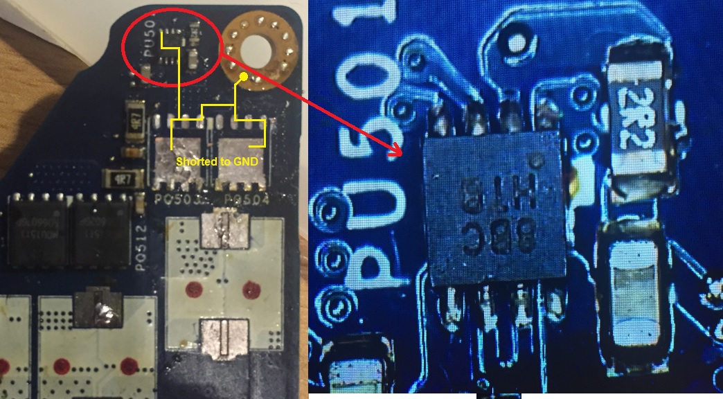

                  thank you all for your help so far....what i found out, is that PL501 seems to be defect or theres something wrong. I removed PL501, PL502 and PL503. Only PL501 (i called it "A") "A" has a connection to ground - that shouldnt be, "B" where connected with "B" from PL502 and PL503. PL502 and PL503 both "A" doesnt have connection to ground. When PL501 was on board, PL502 and PL503 also the little capacitors between PL502 and the CPU Socket were shorted. So i think i should go back the way from PL501 "A" - but which Pin from the Schematic on the PL501 (2, 3, 4) i should take?
                  Greets, Grishnackh
                    pin4.
                    so only pq503,pq504 or pu501 is potential defective.i will go to pu501 (mosfet driver).

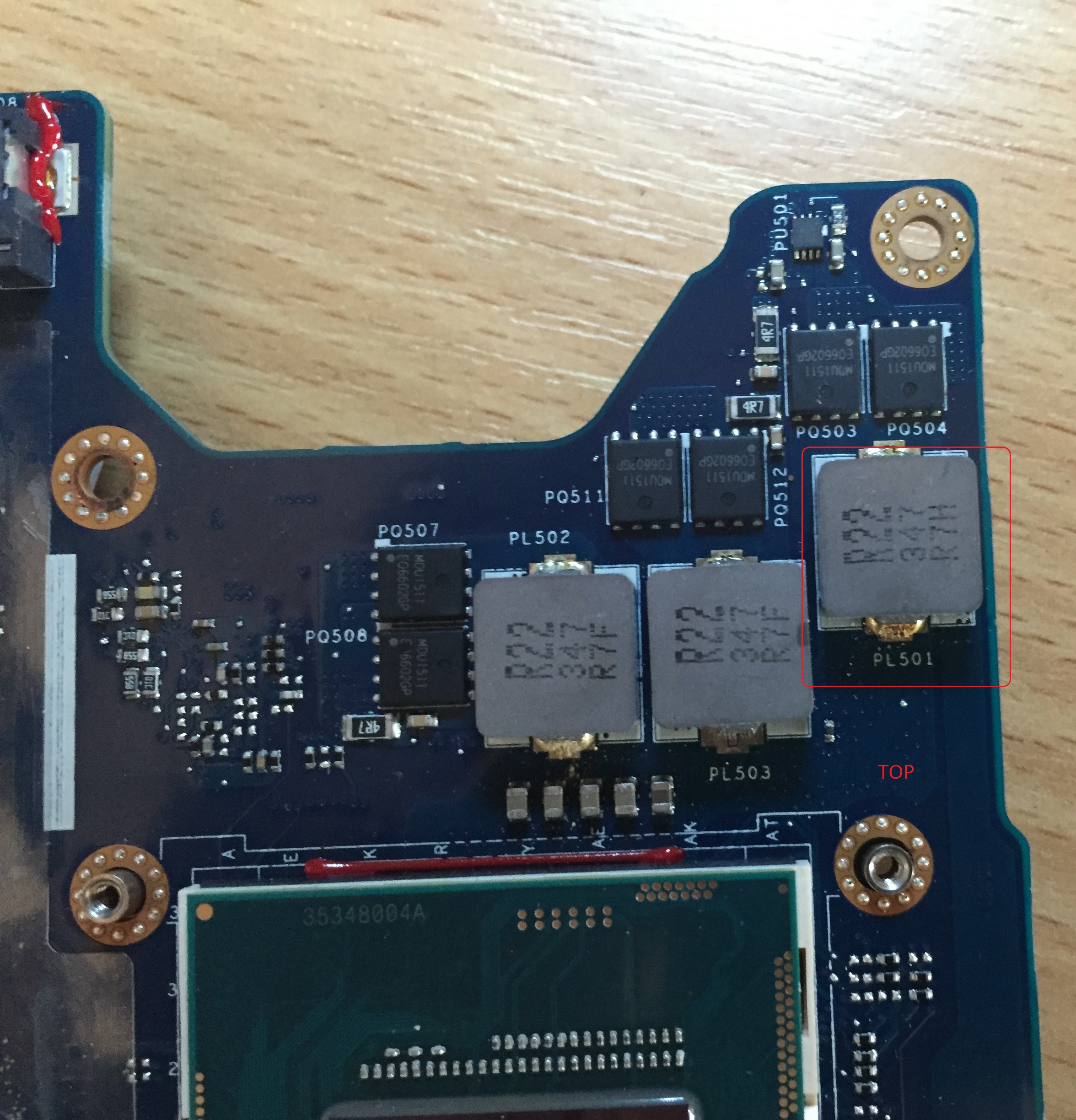

                      I think its PQ503 and PQ504 - both are shorted at least i have direct connection from Drain to Source. Is this my problem?
                      Other Mosfets PQ507, PQ508, PQ511 and PQ512 doenst have direct connection from Drain to Source.
                      Greets, Grishnackh
                        @Koresi i think you are right....on PU501 Pin 4 (GND) is connected to PIN 8 (PHASE3) and continue to Drain to Source from PQ503 and PQ504. So i could only be the PU501 or? Could anyone has information where to get this part in europe or a comparable to ISL6208BCRZ-T?
                        Greets, Grishnackh
                            Thank you, i ordered it on aliexpress and the PU500 too - Do you think changing the PU501 will solve my problem?
                              did you remove PU501 and short gone away?
                              • koresi
                                • Sep 2012
                                • 24
                                • Romania
                                oh sh... yesterday I wrote pu500 instead pu501,my bad.it's about pu501 not pu500 ,sorry.
                                yes I think that changing pu501 will solve it.
                                    @koresi Thank you, i removed the PU501 and the short circuit is gone...hope to get soon the new one to test it.
