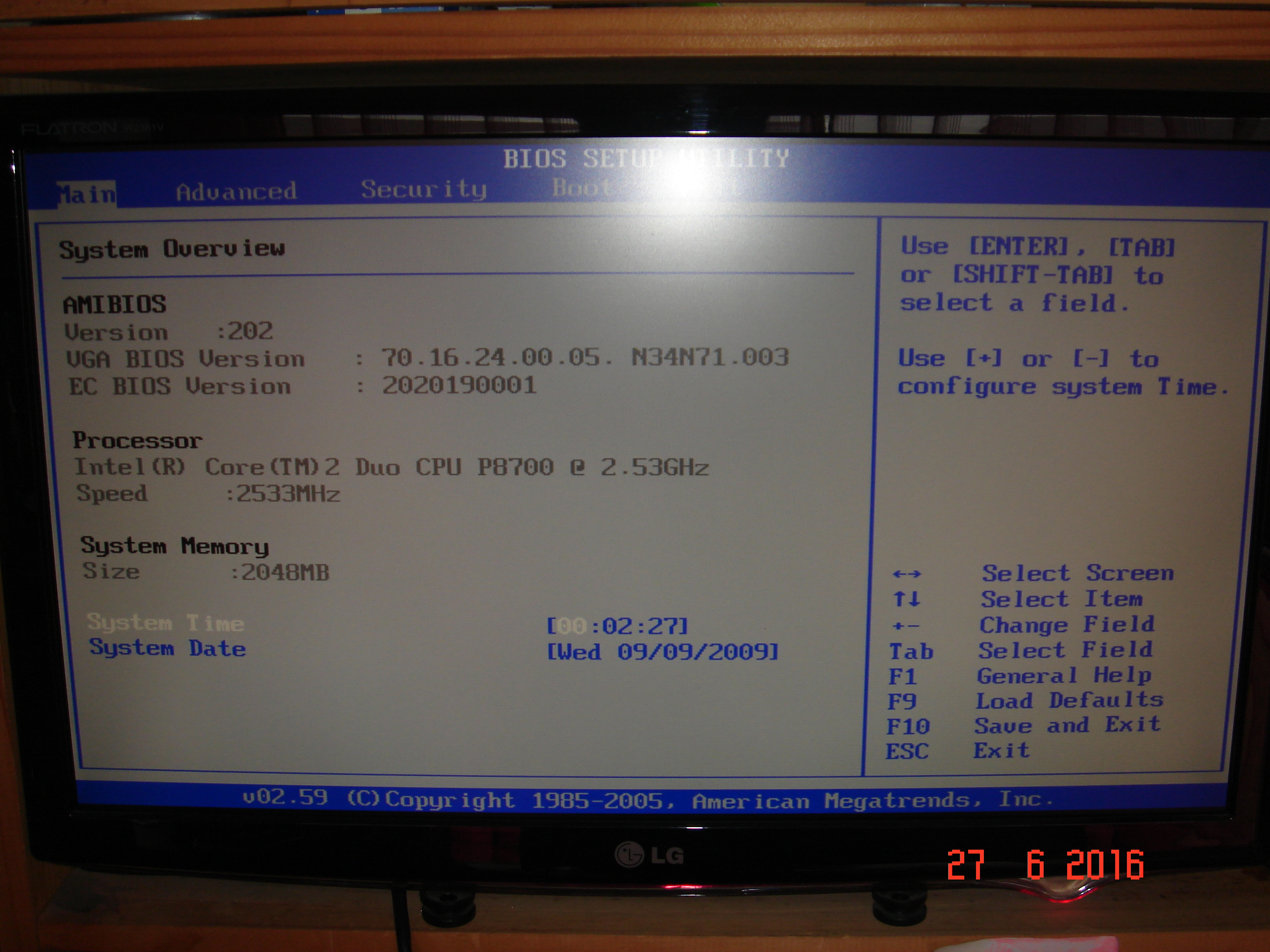

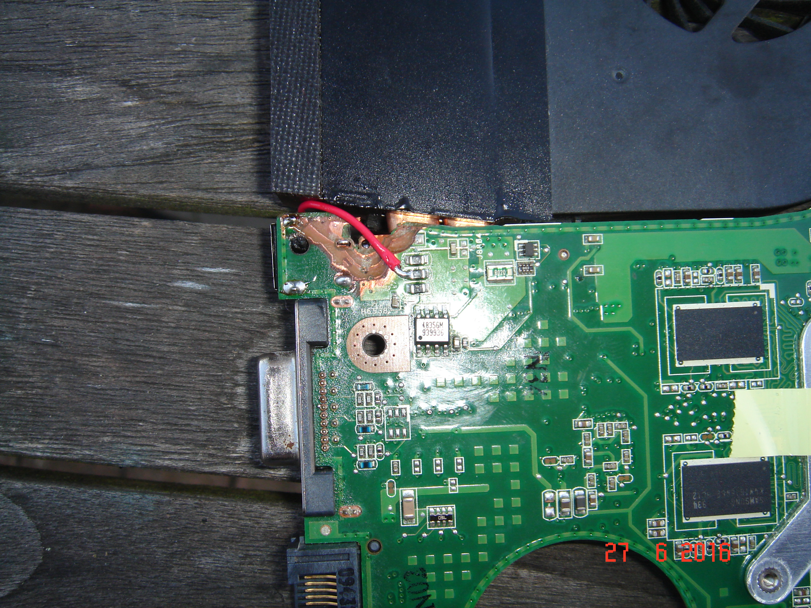

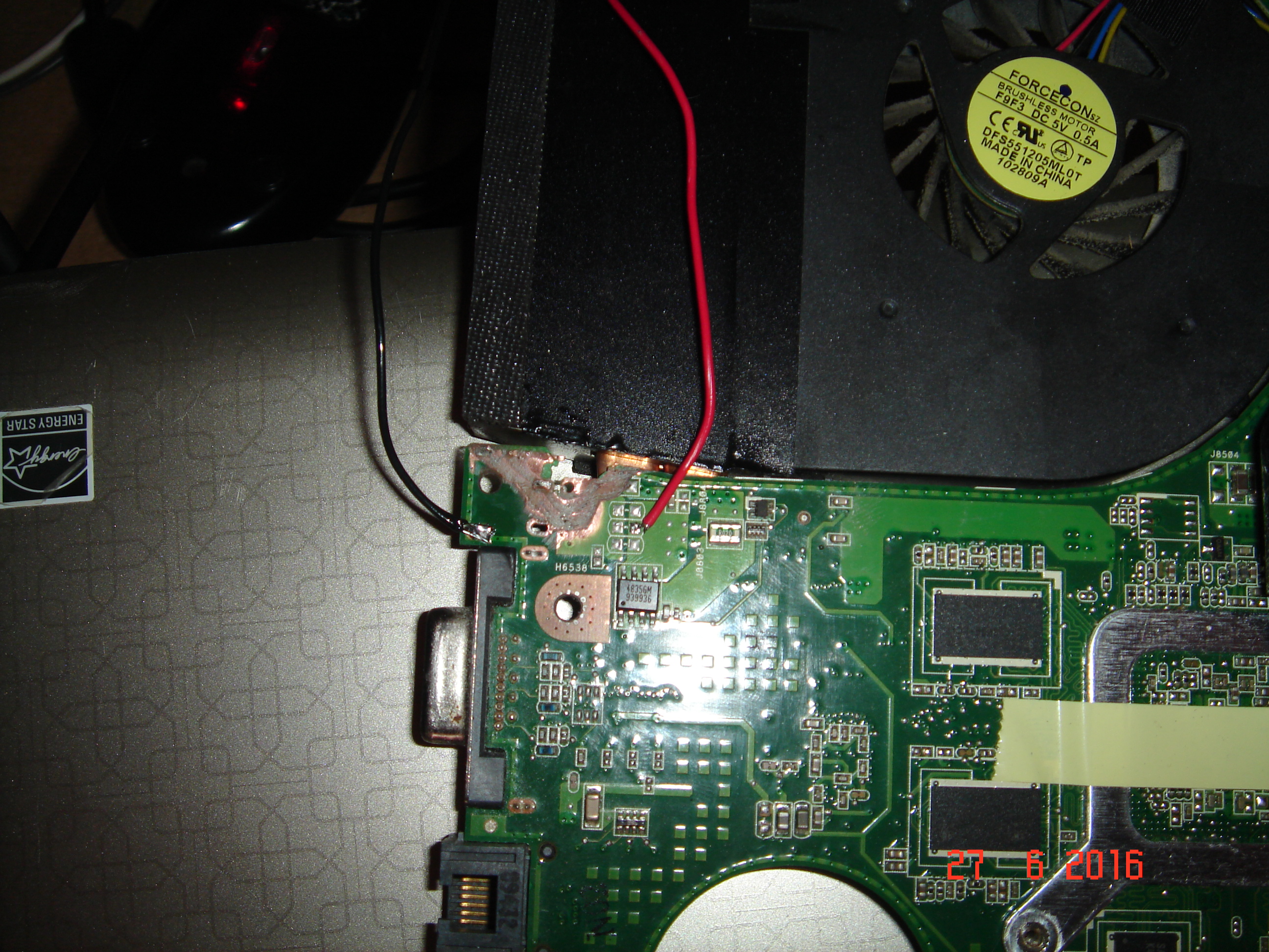

      LOL, after the dremel it worked on first attempt !
      I don't have anymore the short between + and -, it's better if i resolder backe the inductors and capacitor ?
      Crazy, you really need to remove all the charcoal, otherwhise short will remail !
      Thank you all of you buddys
      PS: Now need to run final tests

          Yeah, now it's just a big hole, not a Black one

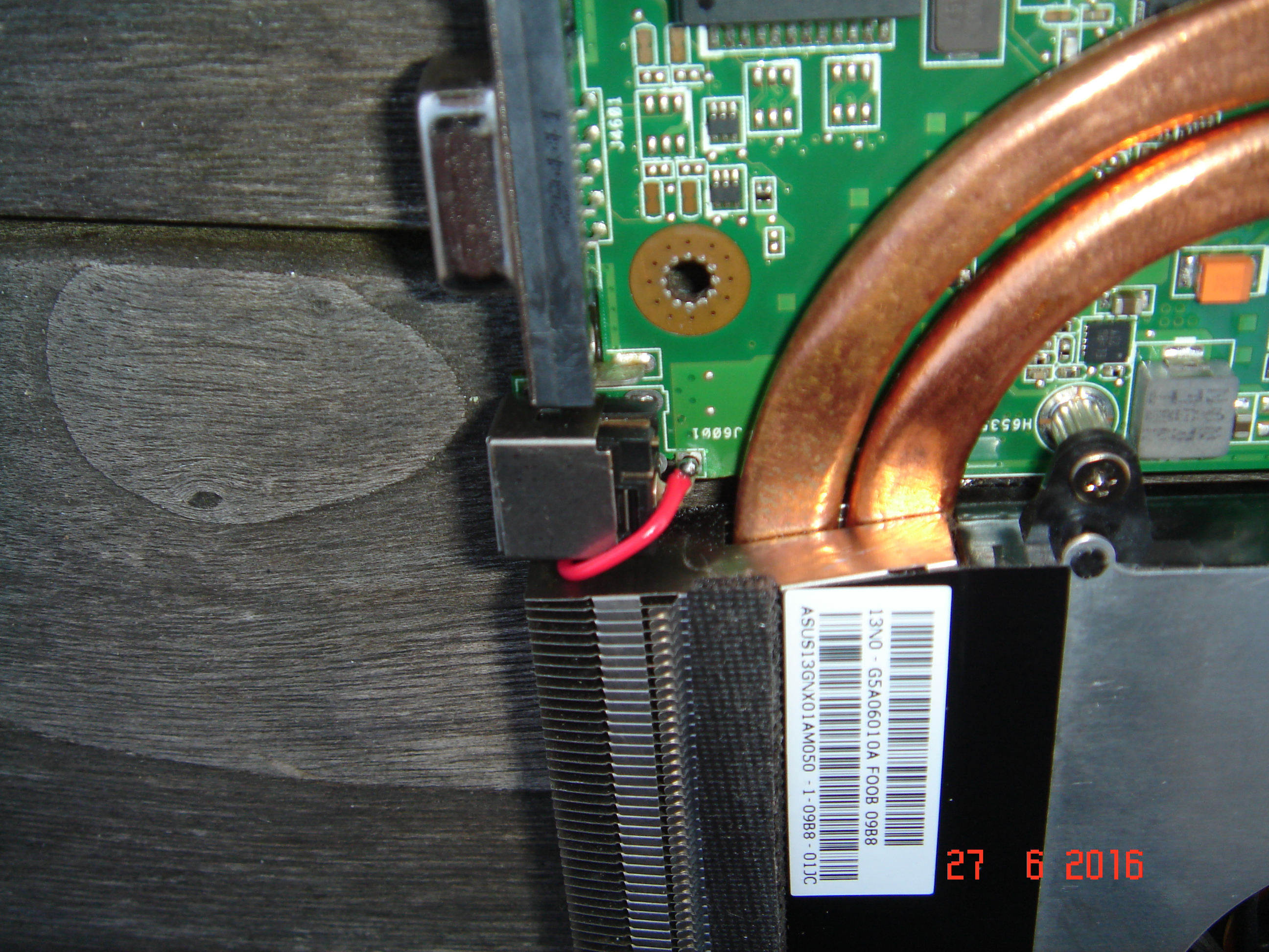

          Just finish solder back the 4 removed smd's, now will rest before i atempt to put back the connector

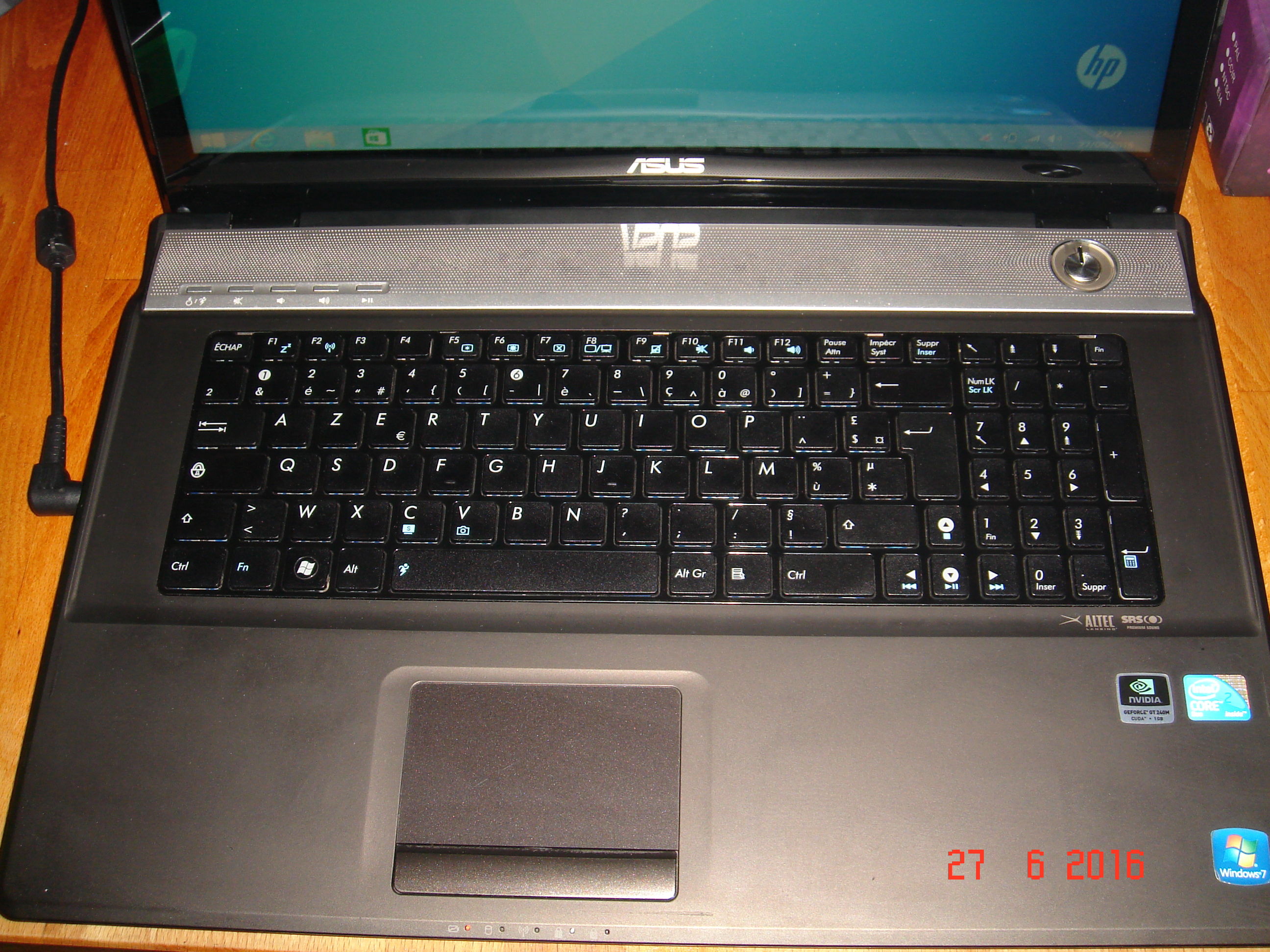

            Ok, pc is 100% Working, battery is charging !
            The + Pin of the power connector is not touching the mobo, i used a wire to connect on the other side.
