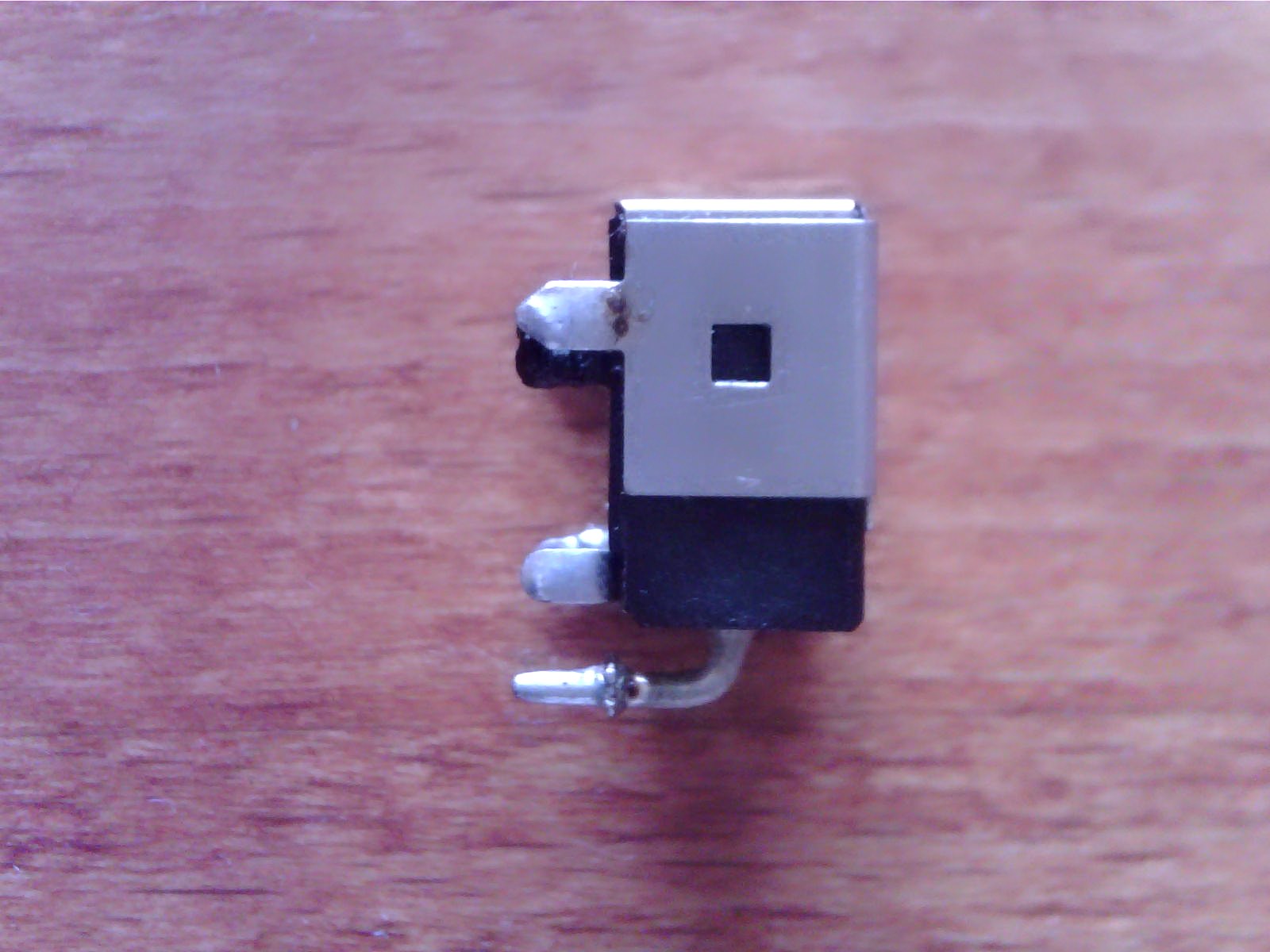

    Is this socket that you are talking ?
    Pin is strait ?

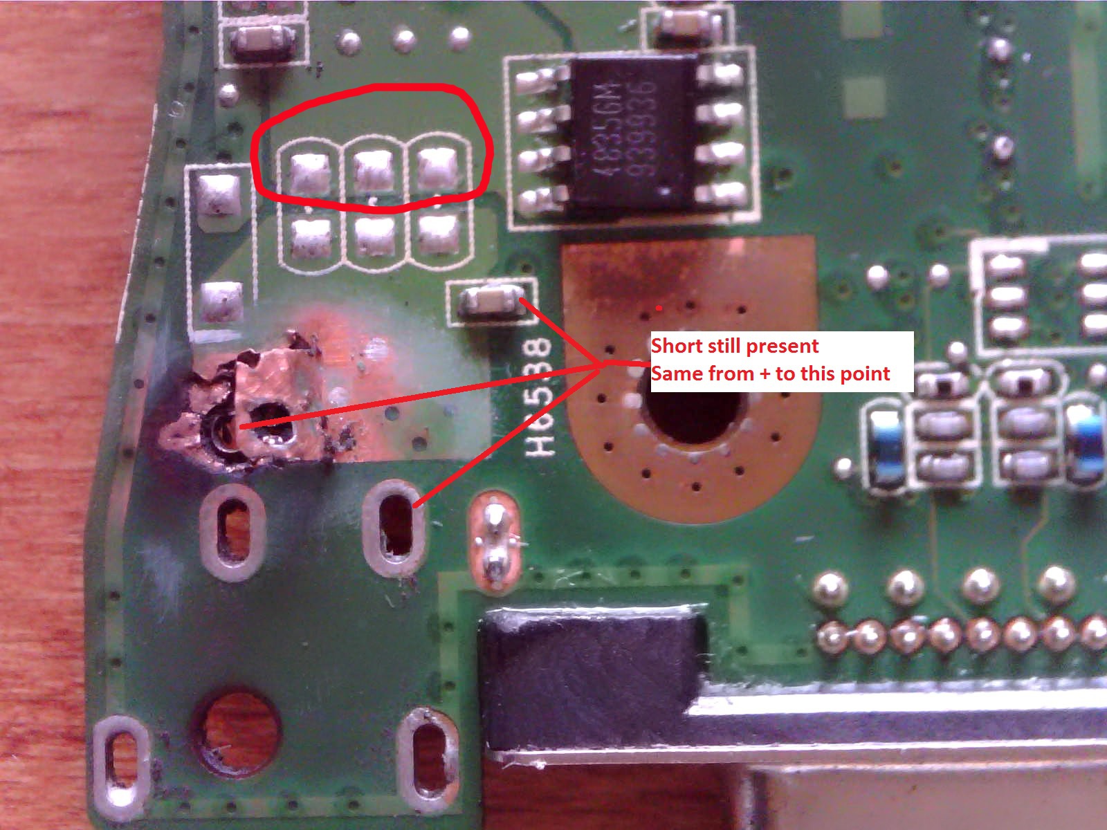

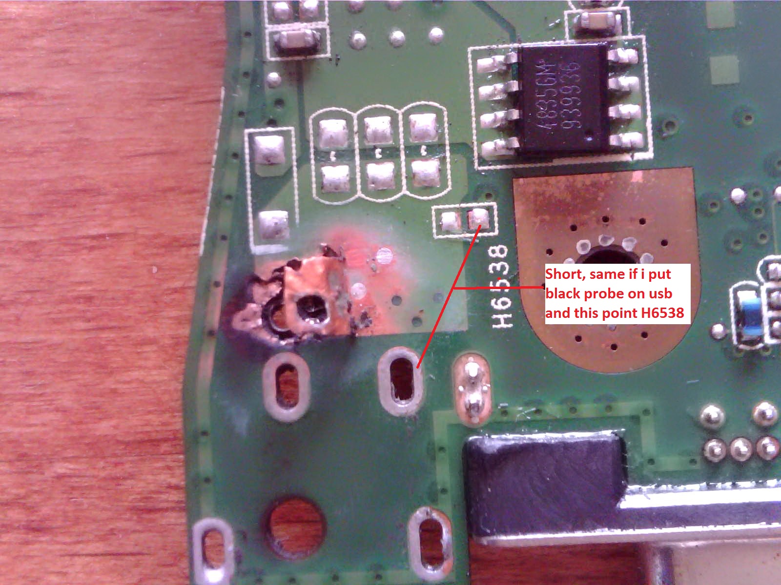

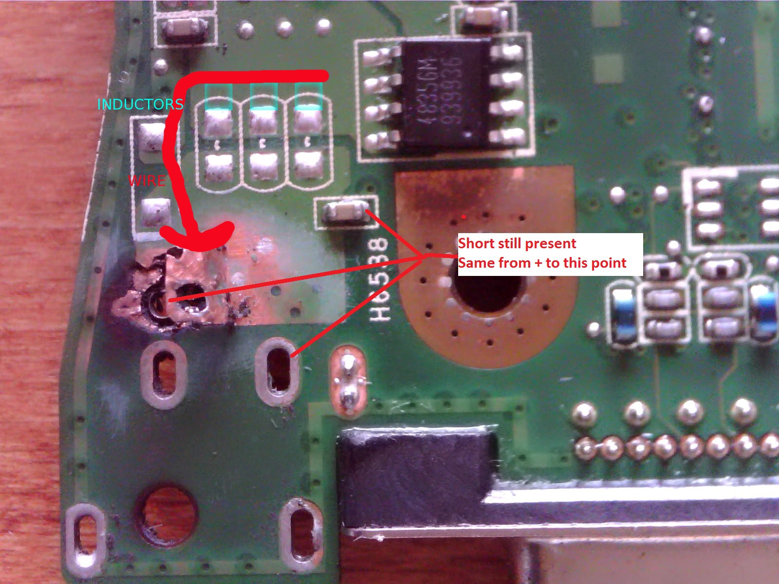

      Re: Asus N71VN burned Power Connector
      I think that i damned, i still have a short between - and the H6538 Point ...
      Normal or Not ?
        ok all is good.
        that pin probably wont bend, cut it so it wont go into the board.
        then put the connector on the board and put a thick jump wire between the back of the socket and the place the 3 inductors went to.
        then test it.
        if it works and charges, we can do it better with the inductors and cap back in use.
          Originally posted by stj
          ok all is good.
          I need to resolder the 3 inductors ?
          If Not, where should i solder +19V ?
            • 31254
            this is where you want the socket pin to connect.
            you can use a wire,
            but even better, if you can put the inductors back standing vertical with the wire across the top of them.
              • 31254
              wait - i have a better idea - making a foto now.
                • 31254
                like this:
                put the inductors back facing the other way.
                then put a wire across them.

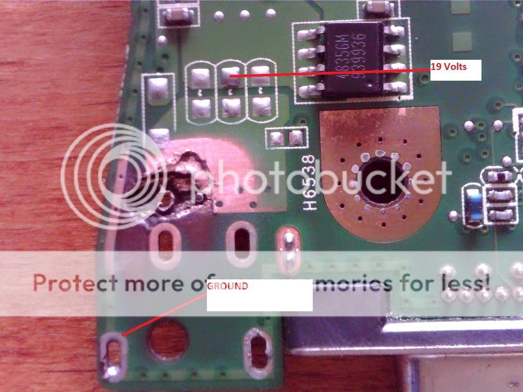

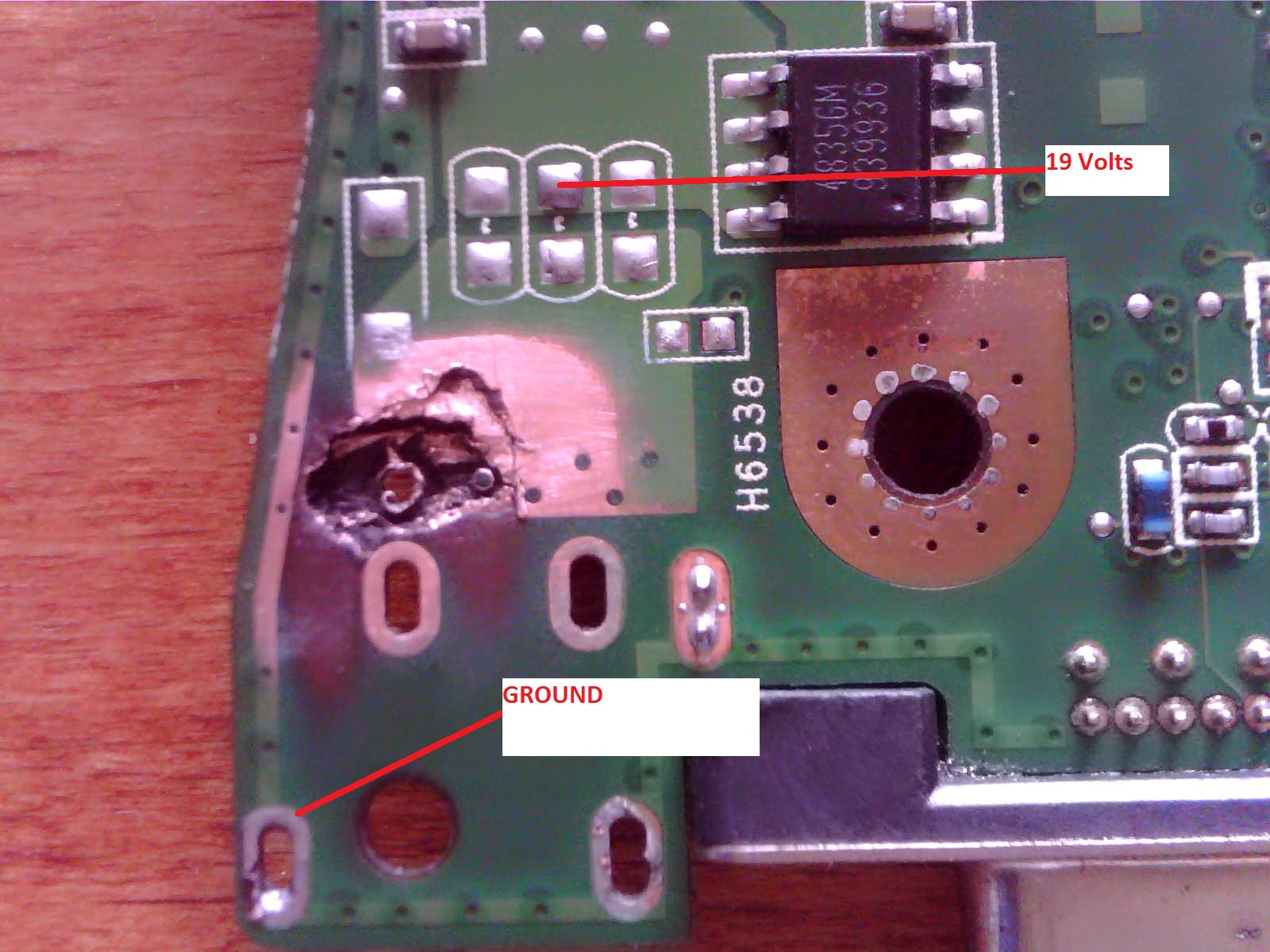

                      • France
                      #30
                      Before your Sugestion i've tried this (photo) :
                      Once i approach the Ground to any of the - Poles, i get sparks .
                      As you can see, i continue to grind/sand, and the short is still present on this area.
                      EDIT: in my humble opinion, the short is on the - ground side, then i'm ....

                        • 31254
                        #31
                        if you put 19v on the pads that connect to the fet, does it work?

                          #32
                          Can you point this pad ?
                            • 31254
                            #33
                            i did - in my foto

                              #34
                              i did - in my foto
                              This is what i've done on post 30.
                              Sparks on, when i connect the - on the short area
                                • 31254
                                #35
                                so you put - on the area for -,
                                and + on the marked area, but NOT in the original hole in the board?
                                • passete
                                  Living=Sharing
                                  • Jun 2015
                                  • 487
                                  • France
                                  #36
                                  Ok, let try to explain, see the photo posted.
                                  +19 was soldered on the midle pad
                                  Ground or - was aplied on lower left hole, like on the photo.
                                  Hope that you understand what i'm trying to explain
                                    • 31254
                                    #37
                                    o.k. where was the spark?
                                    • passete
                                      Living=Sharing
                                      • Jun 2015
                                      • 487
                                      • France
                                      #38
                                      Near the center of the black hole area, lol !
                                      On that region.

                                        #39
                                        Here a little video of the sparks
                                        Maybe it's time for the Dremel, like someone sugested previously , lol

                                          #40
                                          let it spark till it's burned away!
