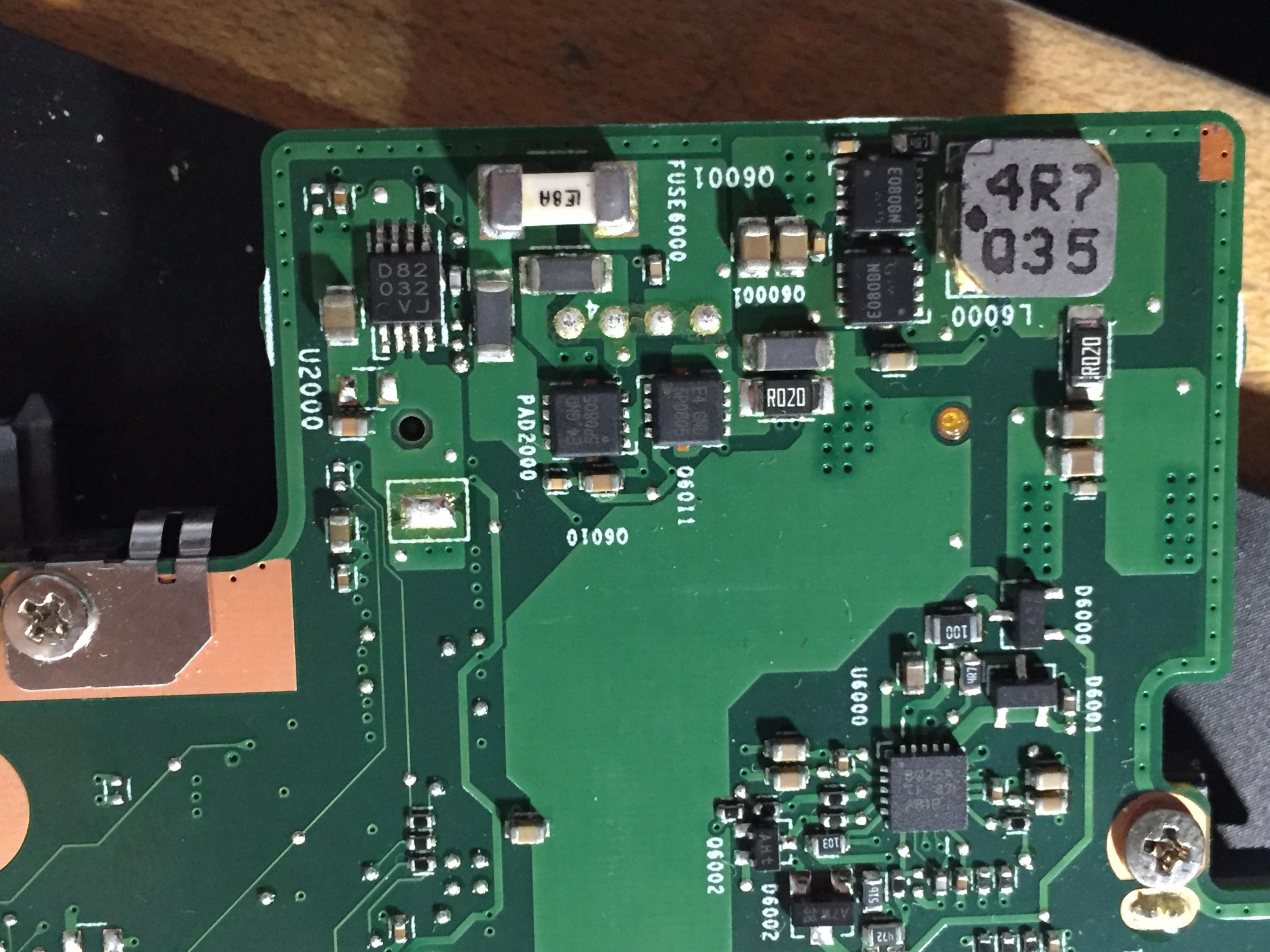

    LED indicates A/C power and Charging. OS reports plugged in and charging but device will not power up on A/C without battery nor will it charge battery (duplicated with 3 known good batteries). I'm having to charge battery in another unit to get anything to work at all.
    Fuse6050 seems good.
    Giving it stink-eye doesn't seem to help...
    Only other indicator I have is without battery when I (attempt to) turn it on, SOMETIMES something tries to jump the fan enough that I can hear it (and see it barely move) click in a rhythmic pattern, almost 1 second apart like a ticking clock.

    please check mosfet near dc jack and mosfet near battery socket.

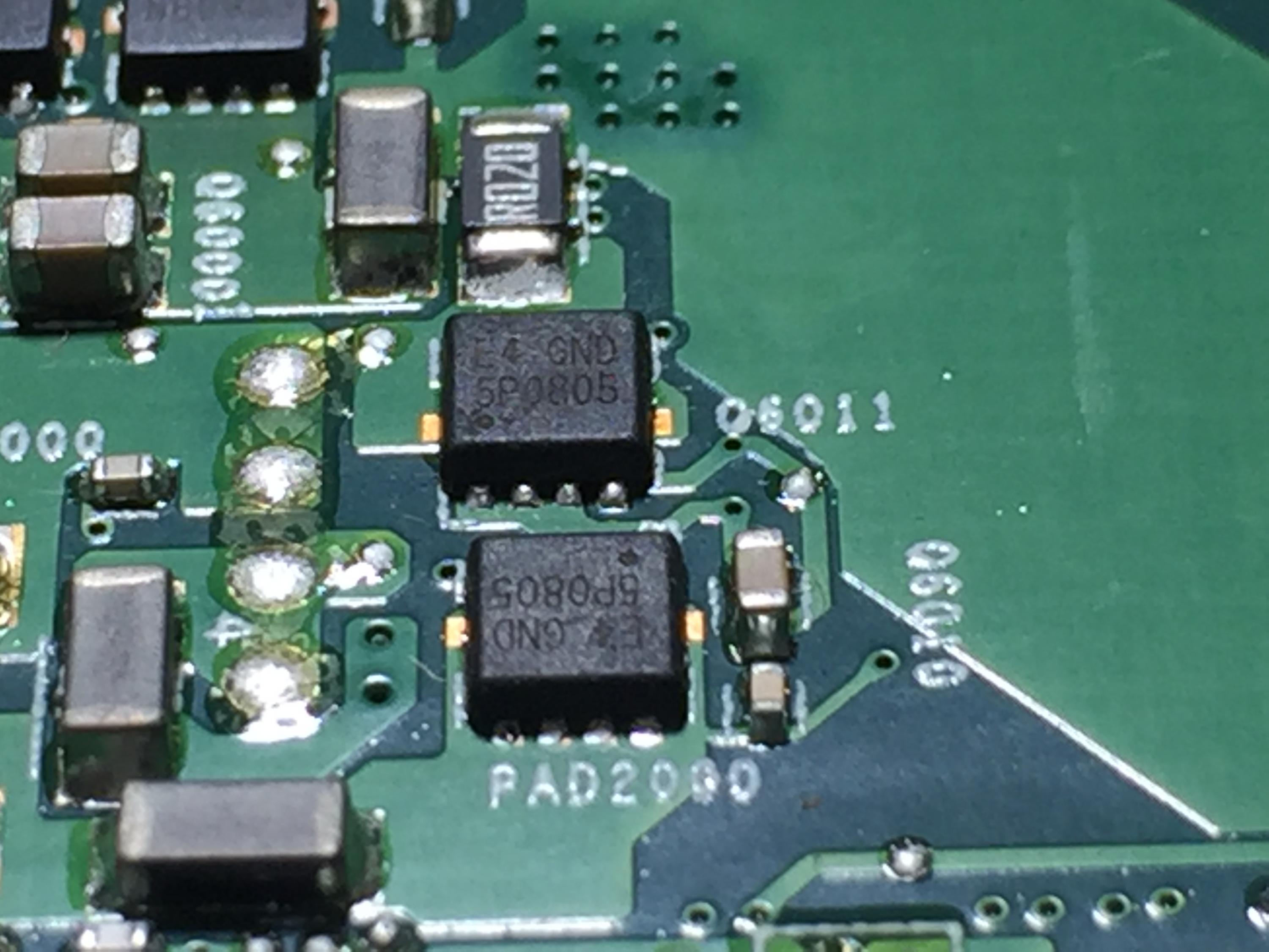

      Q6011 tests open. Q6010 tests normal. Not finding these online though. E4 GND 5P0805

        sir now solution is 1st check and confirm battery and charger then you need to tracing path of the dc chack to high power one resisitor then check upper and lover mosfet this way of the dc chack to battery confirm present 14 to 18 volt in gate of the two mosfet
