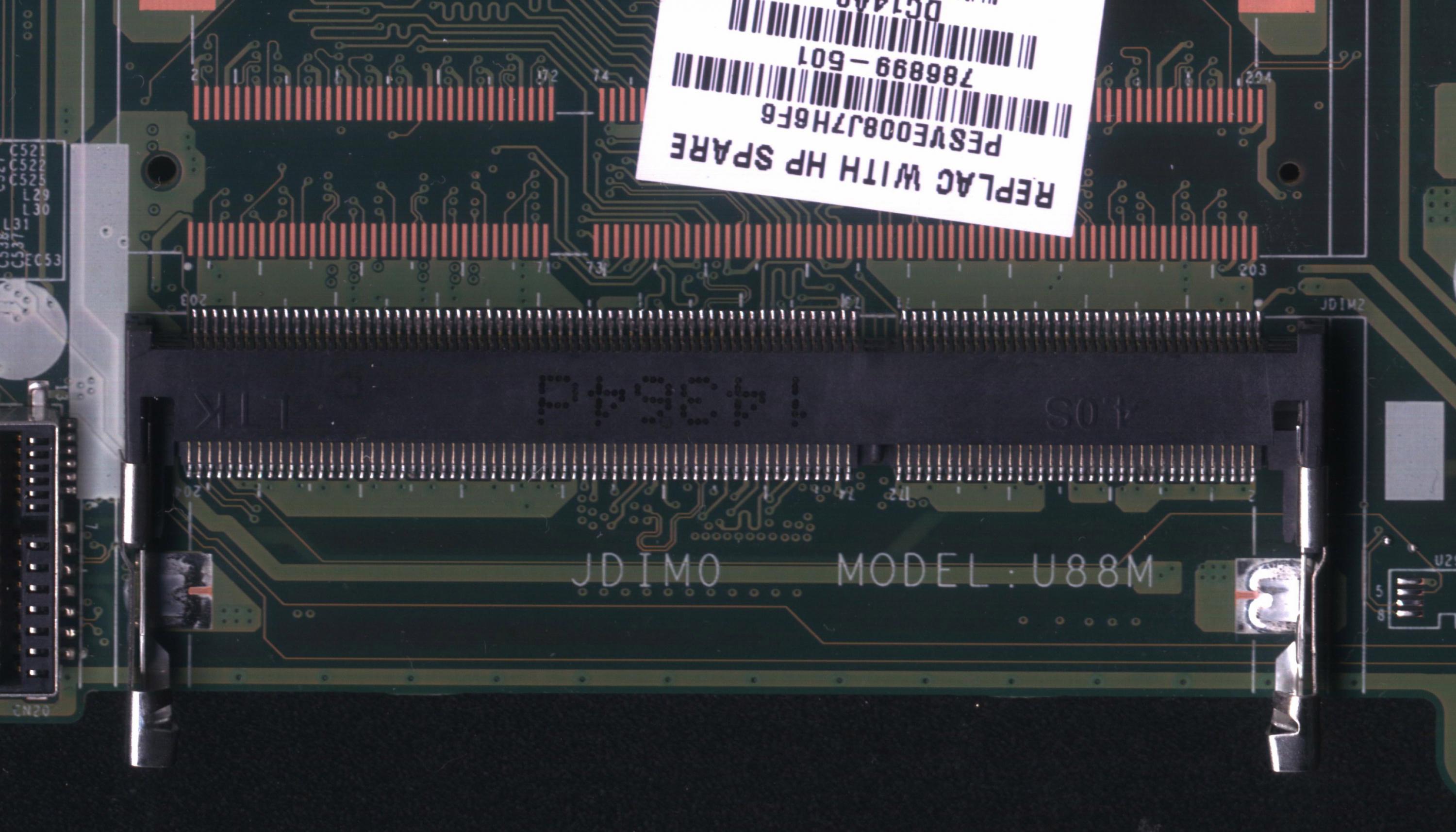

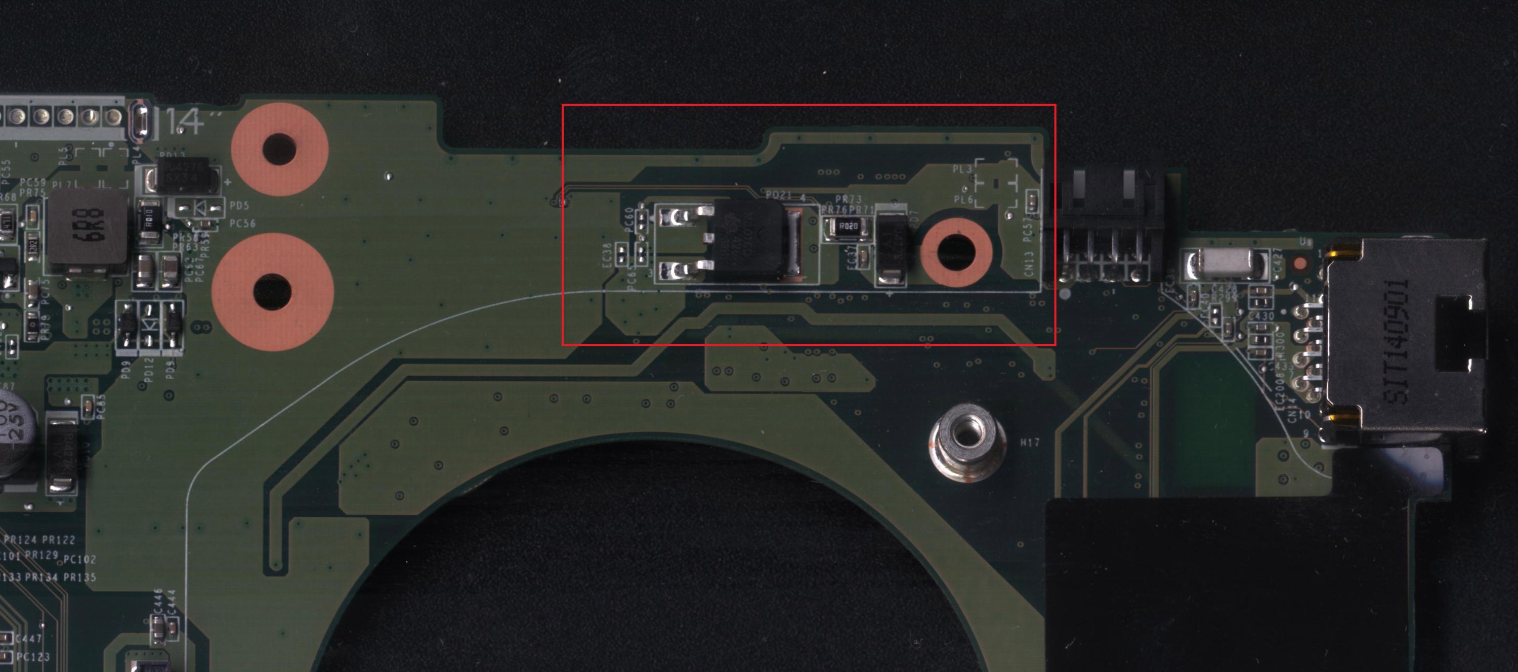

    Hp 15-F125wm power issue
    i have a hp 15-f125wm that will power on with a charged battery, but will not with a known good charger and have changed dc jack. , no light when plugged in. also meter shows a short , when tested with power voltage is low and unstable at the connector on mobo, I had 2 and used the other to charge battery and testing
    thanks
    Mike
  • meritosari
    • Oct 2010
    • 774
    • Indonesia
    Re: Hp 15-F125wm power issue
    I assume you've having quanta u88m, so schematic not available. check if PD7 and PQ21 has shorted.
    attached datasheet and photo as reference
      Many times found faulty fets near to dc jack or protection circuit

                        Re: Hp 15-F125wm
                        thanks, it helped me with a shorted board.
