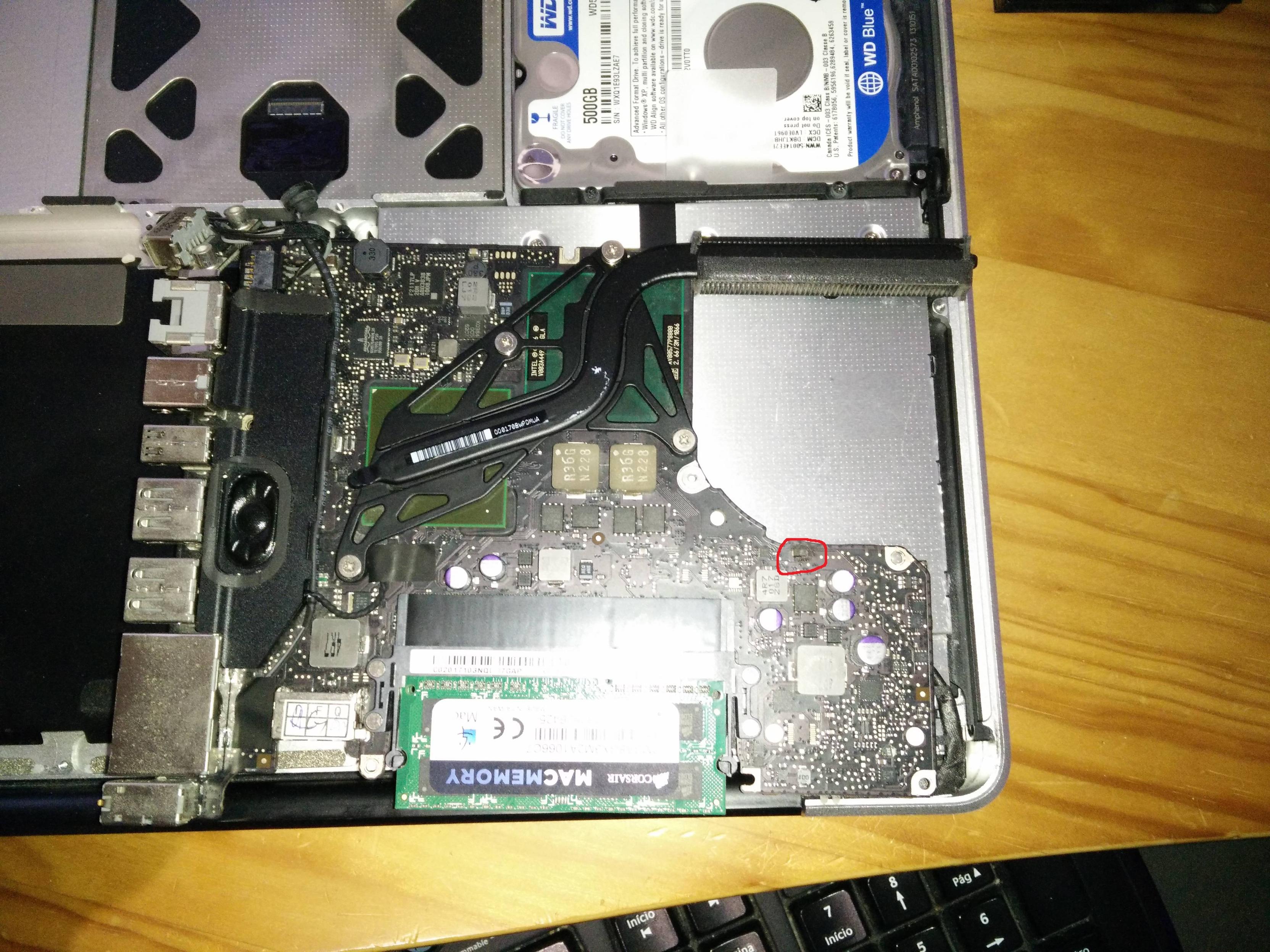

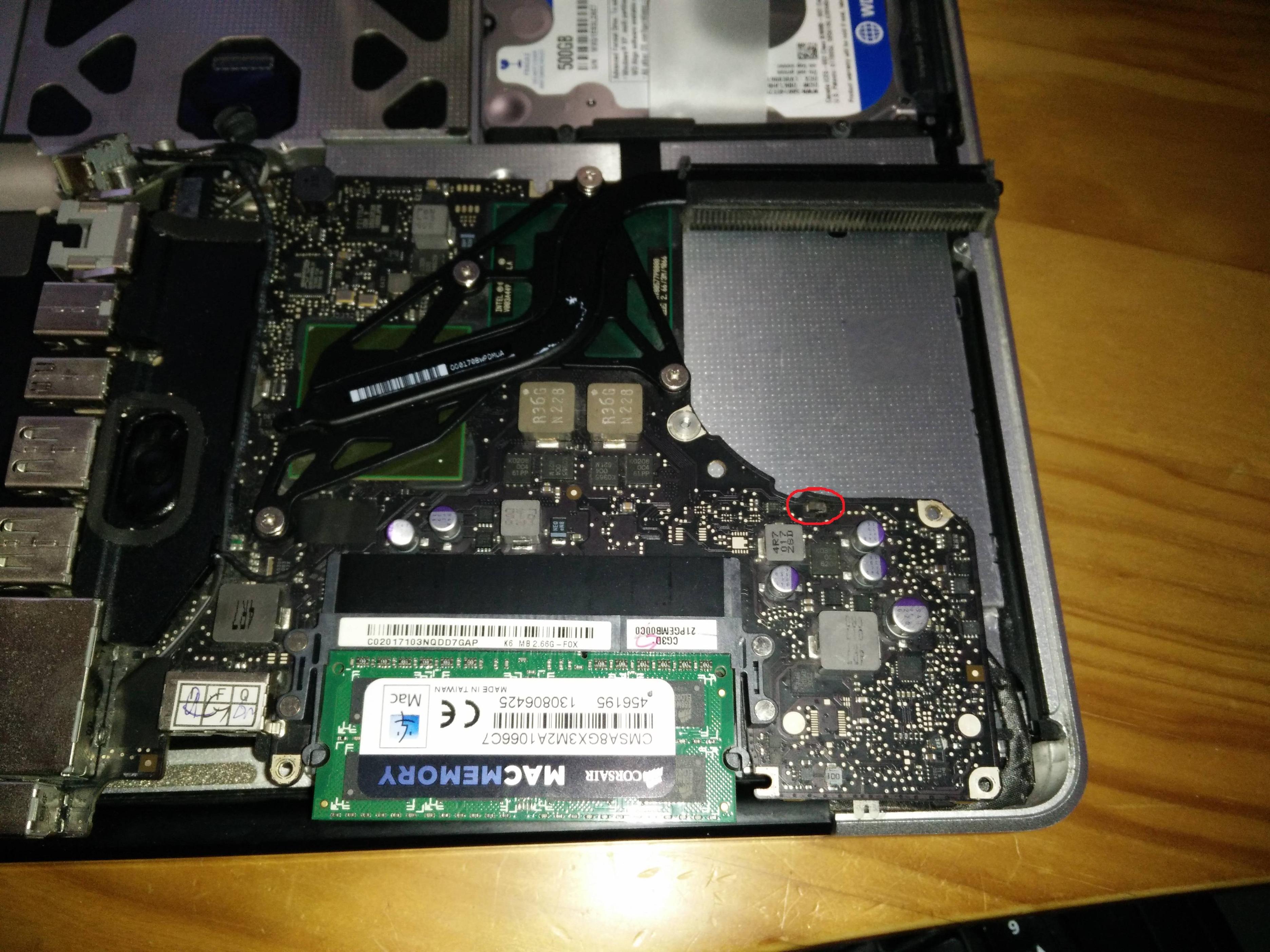

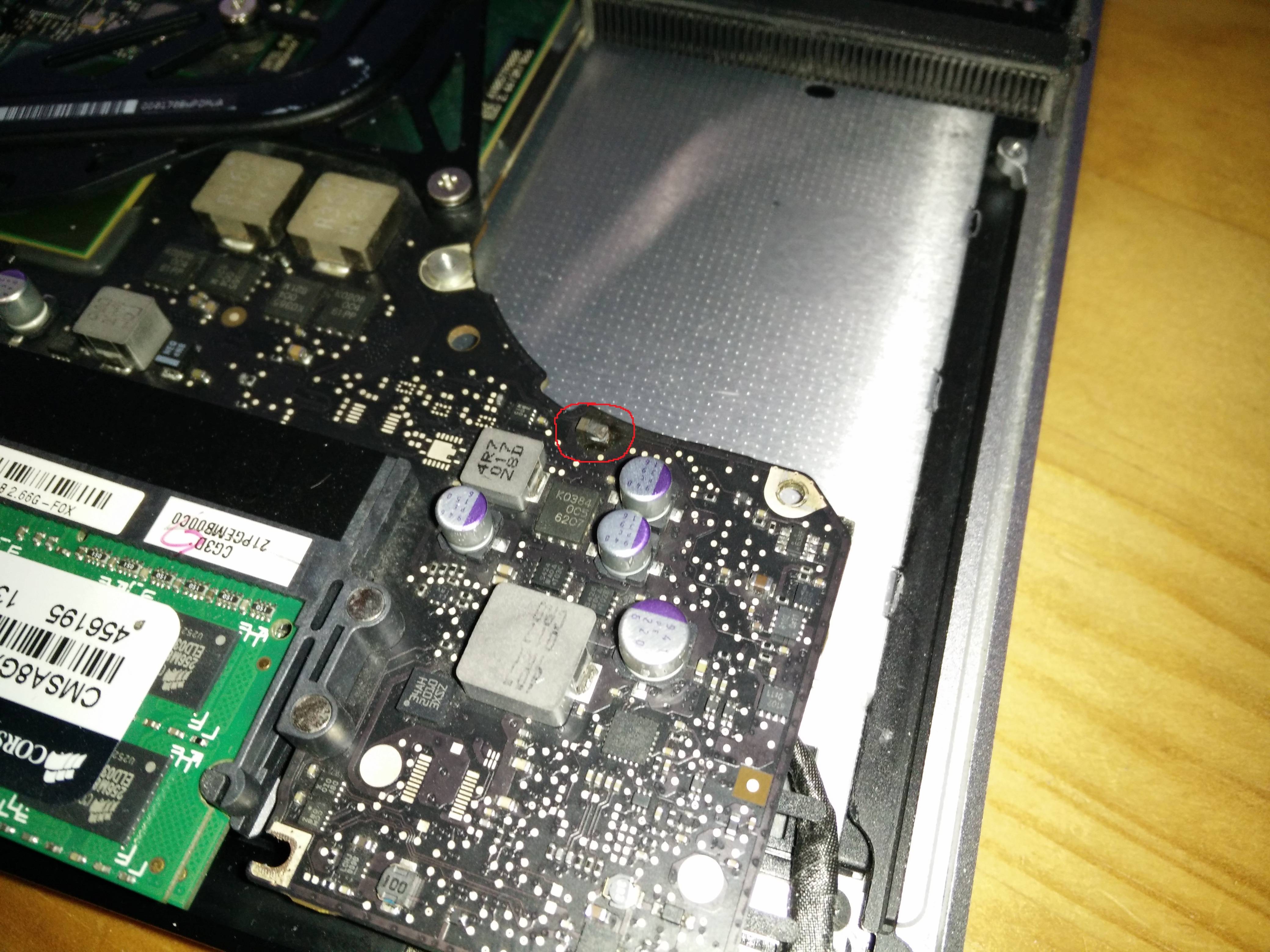

Burnt smell Macbook Pro 13' mid 2010
  • MrBalls
    • Jan 2016
    • 3
    • Portugal
    Burnt smell Macbook Pro 13' mid 2010
    Hello everyone.
    I started this thread in order to get some council on my macbook pro 13'.
    The problem started a few days ago when i booted the mac it started to get a burnt smell. I immediately stopped the machine from booting and went looking for the problem.
    Mac Specs:
    Macbook pro 13' mid 2010
    Intel Dual core 2.66GHz
    Model: MC375xx/A
    Motherboard: A1278
    I can assure you no liquids or dropped in the machine or anything harmful. The burning smell came from a electronic component shown in the following images.
    My ideia was at first identify which component it was, and replace it, although im not sure if the component burning was the cause or consequence of something else.
    Has you can see in the picture the component is too much burned to get an actual reading on the id. And i couldn't find any schematics online for the given motherboard which led me here to this forum.
    So with this thread i was looking for some council on identifying this burnt component or based on experience if this is a consequence of another damaged component and which approach should i take on the matter.
    Thanks in advance for any support
    Last edited by MrBalls; 01-30-2016, 07:27 PM. Reason: broken image links
  • goontron
    5000!
    • Dec 2011
    • 4108
    • US
    Re: Burnt smell Macbook Pro 13' mid 2010
    Its a diode
    see here: http://forums.macrumors.com/threads/...#post-15102073
    Follow the white rabbit.
    • MrBalls
      • Jan 2016
      • 3
      • Portugal
      Re: Burnt smell Macbook Pro 13' mid 2010
      Thank you for the fast reply.
      When you say diode, you are referring to mousepads comment "C6603 = 100UF 20% 6.3V Tant Case-AL1 (Speaker Amp Logic)"
      • goontron
        5000!
        • Dec 2011
        • 4108
        • US
        Re: Burnt smell Macbook Pro 13' mid 2010
        Originally posted by MrBalls
        Thank you for the fast reply.
        When you say diode, you are referring to mousepads comment "C6603 = 100UF 20% 6.3V Tant Case-AL1 (Speaker Amp Logic)"
        Yes, cap, not diode, it was 10pm when i posted that... It was a the image in post 588 that got me to that thread.
        The position on the board makes more sense for a cap too.
        Last edited by goontron; 01-31-2016, 11:30 AM.
        Follow the white rabbit.
        • mferna14
          Apple MacBook Pro A2338 820-02773-A AON Rail burnt
          by mferna14
          Hi Dear Friend., I am working on a Apple MacBook Pro A2338 820-02773-A. The history was that the AON Rail on the Trackpad connector JT400 was burnt. After I removed the burnt connector, I tested with the meter & no shorts. Connected the USB C power & all booted fine, no problems at all. I soldered a New TP connector put in the old trackpad with a brand new Flex cable. The laptop beeped in the start but no display. I removed the connector & the display was fine again. USED a known good Trackpad & a Flex cable, even with this still the same problem. I checked the connector whether...
          06-25-2025, 11:26 AM
        • envym
          MacBook Pro 2018 with Activation Lock
          by envym
          Hi everyone!
          I have a 2018 MacBook Pro (with Sequoia OS) that I've been using for years with no problem. I recently received an M2 MacBook Pro so I'm mostly using it and not the 2018 one, but since a friend of mine needs a computer, I thought I could restore my 2018 and give it brand-new-like to my friend.
          I tried using the built-in tool to restore the MacBook (Settings > General > Transfer or restore > Delete) but it got stuck when trying to remove the Find Device configuration (it asked me for the password for my old Apple ID -now I use the same account but...
          06-27-2025, 08:54 AM
          Apple MacBook Air 13'' LATE 2010 820-2838 820-2838-A 820-2838-B Boardview
          Apple MacBook Air 13'' LATE 2010 820-2838 820-2838-A 820-2838-B Boardview...
          10-22-2024, 02:37 AM
        • tobeend
          Bypass mdm macbook m2 ventura
          by tobeend
          1. RESET MACOS WITH IPSW
          a. Power off MacBook, press and hold the power button to enter Recovery
          b. Open Disk Utility, remove Macintosh HD
          c. Reboot, connect to the network to Activate Mac.
          d. Plug the C cord in the first port of the MacBook into the other Mac, then power off the MacBook
          d. Hold down the Control (L) + Option (L) + Shift (R) + Power key combination for 10 seconds
          e. Release the other keys, but keep holding the Power key for another 10 seconds
          f. MacBook is returned to DFU, open Apple Configurator 2 on the other Mac, right-click...
          05-26-2023, 07:18 AM
        • protocold
          MacBook Pro 15" 2010 820-2850 intermittent charging
          by protocold
          I would like to get some help on a 820-2850 logic board with intermittent charging problem. Sometimes the battery will charge all the way and sometimes magsafe would be cycling between green and orange.
          I have already tried replacing dc-in board, swapping good battery, swapping genuine 85w chargers. None of that helps..
          when it is not intermittent:
          PPVBAT_G3H_CHGR_R is 12.07v
          when it is intermittent:
          When the light is green, PPVBAT_G3H_CHGR_R is 12.99v
          when the light is orange, PPVBAT_G3H_CHGR_R is 11.62v
          data line on the battery...
          07-25-2025, 08:18 PM
