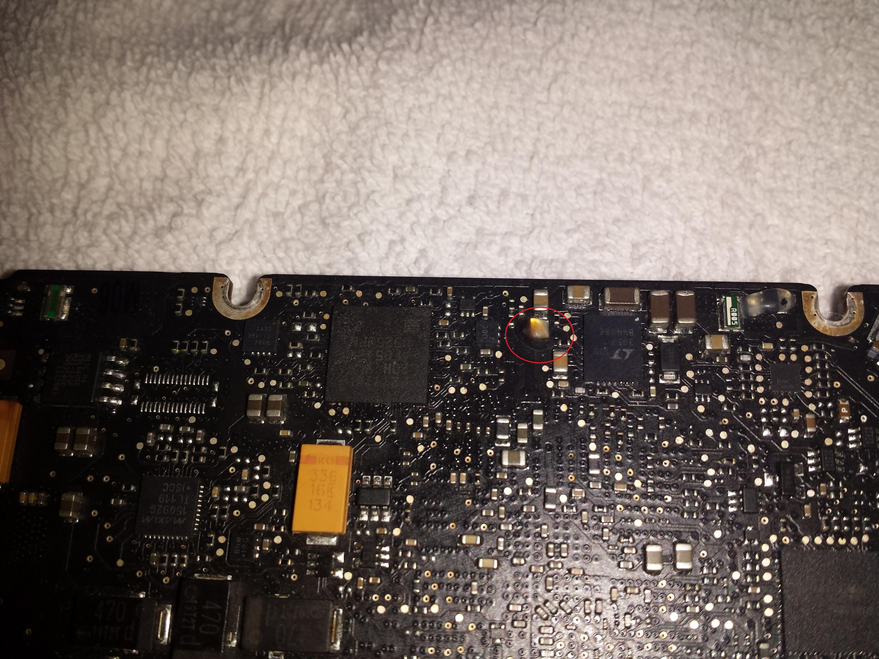

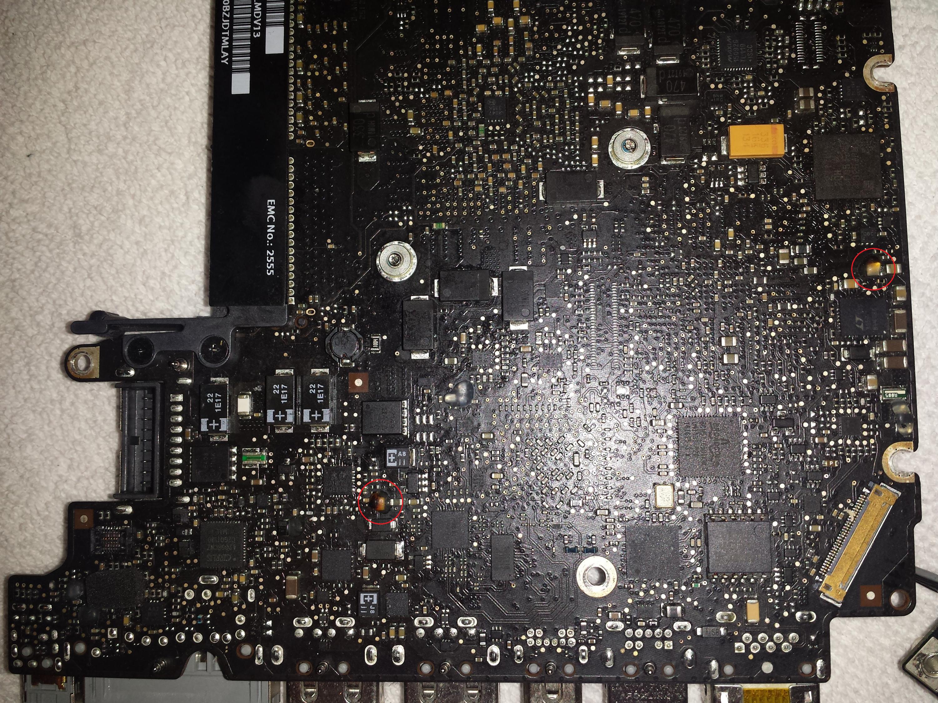

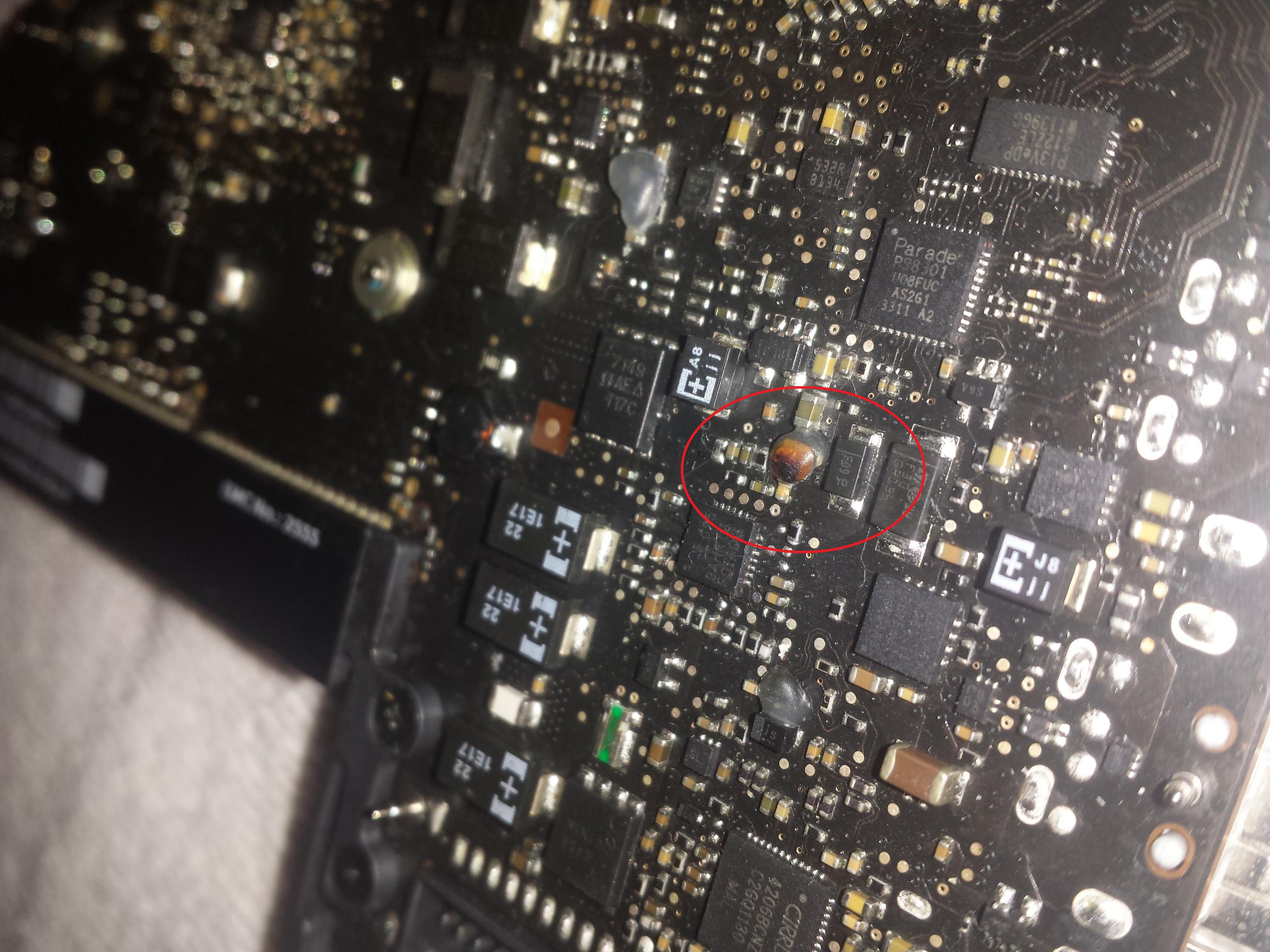

    I could need some help here. I bought a broken MBP for using a good touchpad and battery. But now i am curious what could have happen that the Book is dead. The owner told me this story -> Hy tried to change the RAM and couldnt manage to get the screw out of the case. So he tried to "open" the case with bending the metal away (yee... i don´t know why) It was the screw in the corner close to the magsafe port. Now attaching the power without battery the LED is blinking in light green and orange.. took the bord out and saw two orange components under some kind of glue.
    Please could someone tell me why this thing looks burned ?
    (guess he shorted something with the screwdriver)
    greetings

    what i already saw / heard ->
    when i power the logicboard the light is dimmed green... then after a few seconds it starts to blink when it finally switches between green and orange... the same pattern the light flickers there is a VERY VERY low clicking noise on the motherboard. Any ideas ?

      Freund er hat dich angelogen, er hat versuch diesen ISL62... chip zu ersetzten seh ich, deswegen auch diese hitzespuren am Kleber!!
      Also er hat insgesamt das board erhitzt würde sagen mit einer Heißluftpistole, gebracht hat es wahrscheinlich nichts er hat bestimmt noch mehr zerstört...

        Oh.. heißt, dass diese 2 Bauteile durch einen Kurzschluss angeschmort sind, ist eher unwahrscheinlich?
        Na wird dann wohl als Totalschaden weiterverscherbelt.. schade

          i dont understand german language, but looking the picture looks like u7000 isl6259ahrtz have been heated up. try replace it with a brand new one and see what happens.

                Diese bauteil lädt denn Akku auf, hat mit starten des Notebooks nichts am Hut!!
                Nein Kutzschluss nicht, jedoch hat er gebastelt und man weiß nie was er kaputt gemacht hat und was fehlt....

                  yes dellxps, your right,i have tell him the same as you, the board or ISL chip has been heatet or change and if there was a repair you can destry more than the board ist complett dead.....
