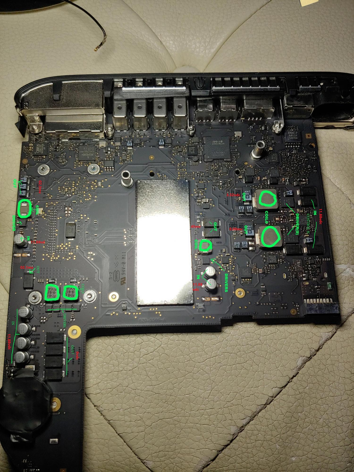

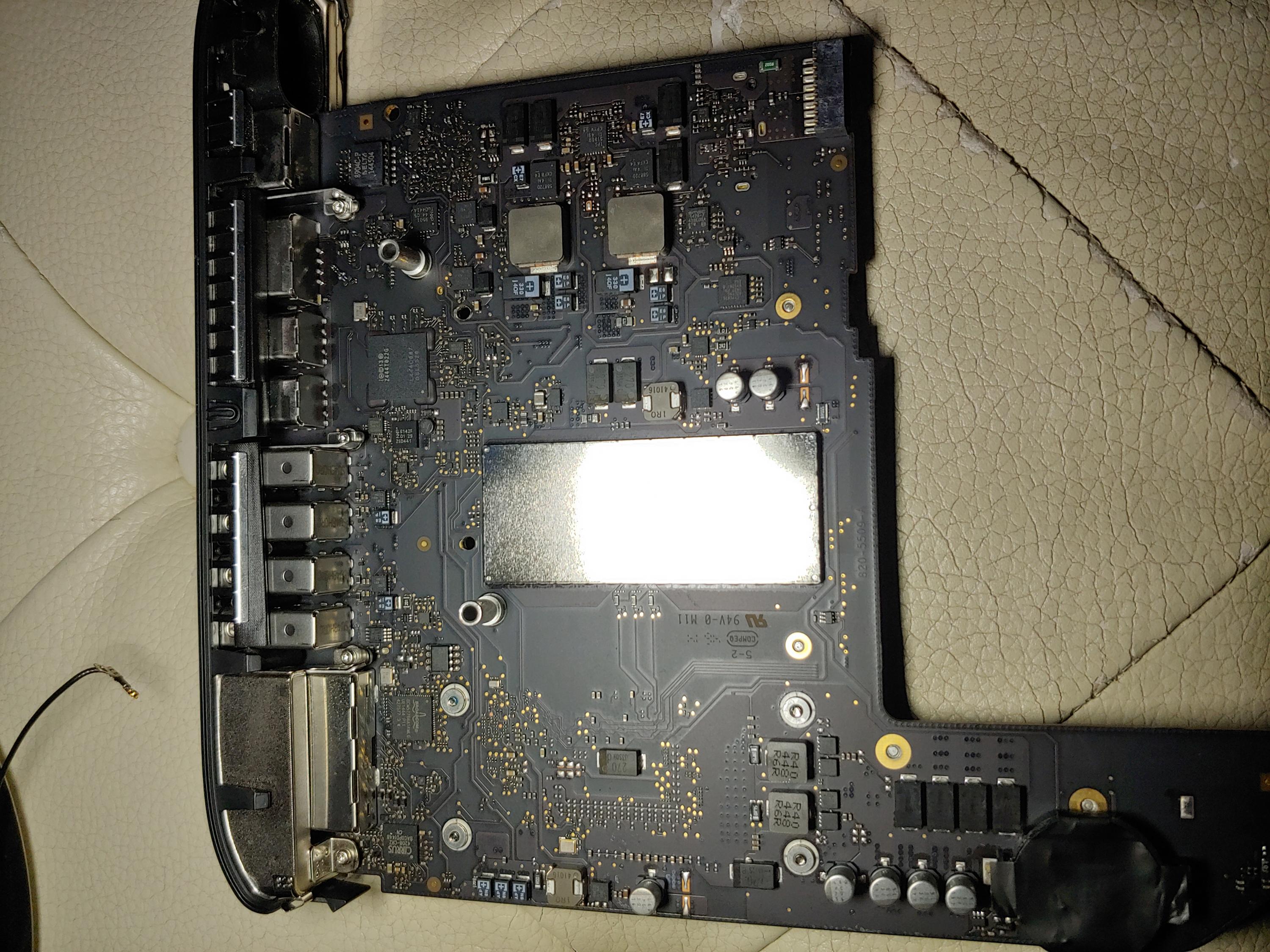

                        Hi, I finally got the mac mini open up. I really have no idea where to begin from. Does anyone has a schematic of the logic board to share. It's a 2014 mac mini.
                        I have attached the logic board photo below.

                          Re: Apple Mac Mini A1347 Late 2014 completely dead no power

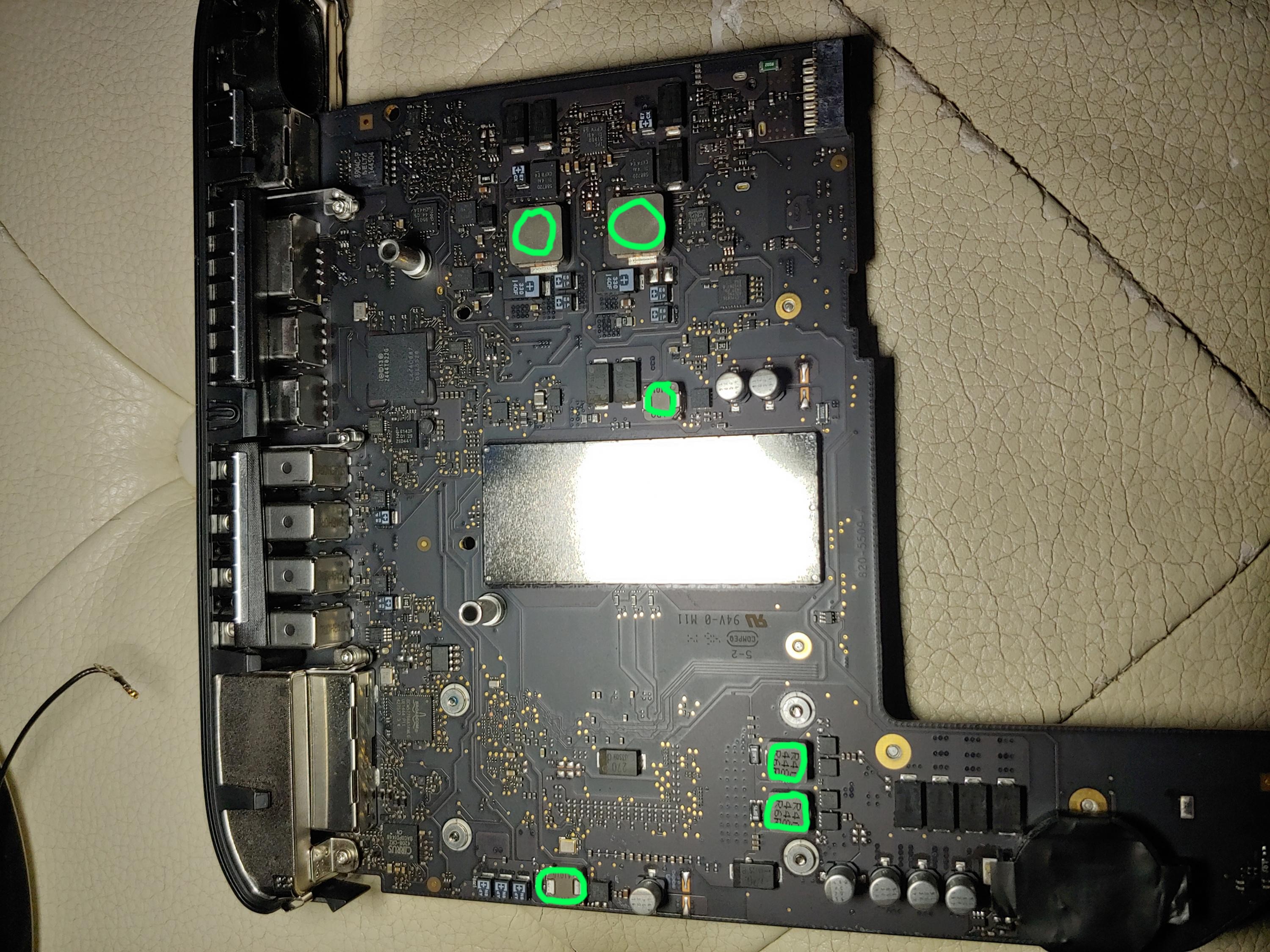

                          Well, these are the inductors (see pic) - each one will be generating a power rail. Near each one will be the power IC that drives it. Also by the inductors and power IC you should find capacitors on both sides - one will be for the input voltage rail and the other for the output voltage rail
                          I know nothing about Apples, but if this was some unknown dead board I was trying to fix, I would also check the input voltage (from the power adapter).
                          I would then check the voltage on each of those inductors to see if power rails are present. If there is no output power rail (on the inductor) I would try to determine if the input voltage rail is present near each power IC (check on the electrolytic/polymer/tantalum capacitors).
                          I would also be looking for datasheets for the power ICs as that usually has an example circuit, but at the very least would tell me which pin has the input voltage rail.
                          Have a look, and mark the voltages on the image then re-post it
                          So there are some ideas for you to start

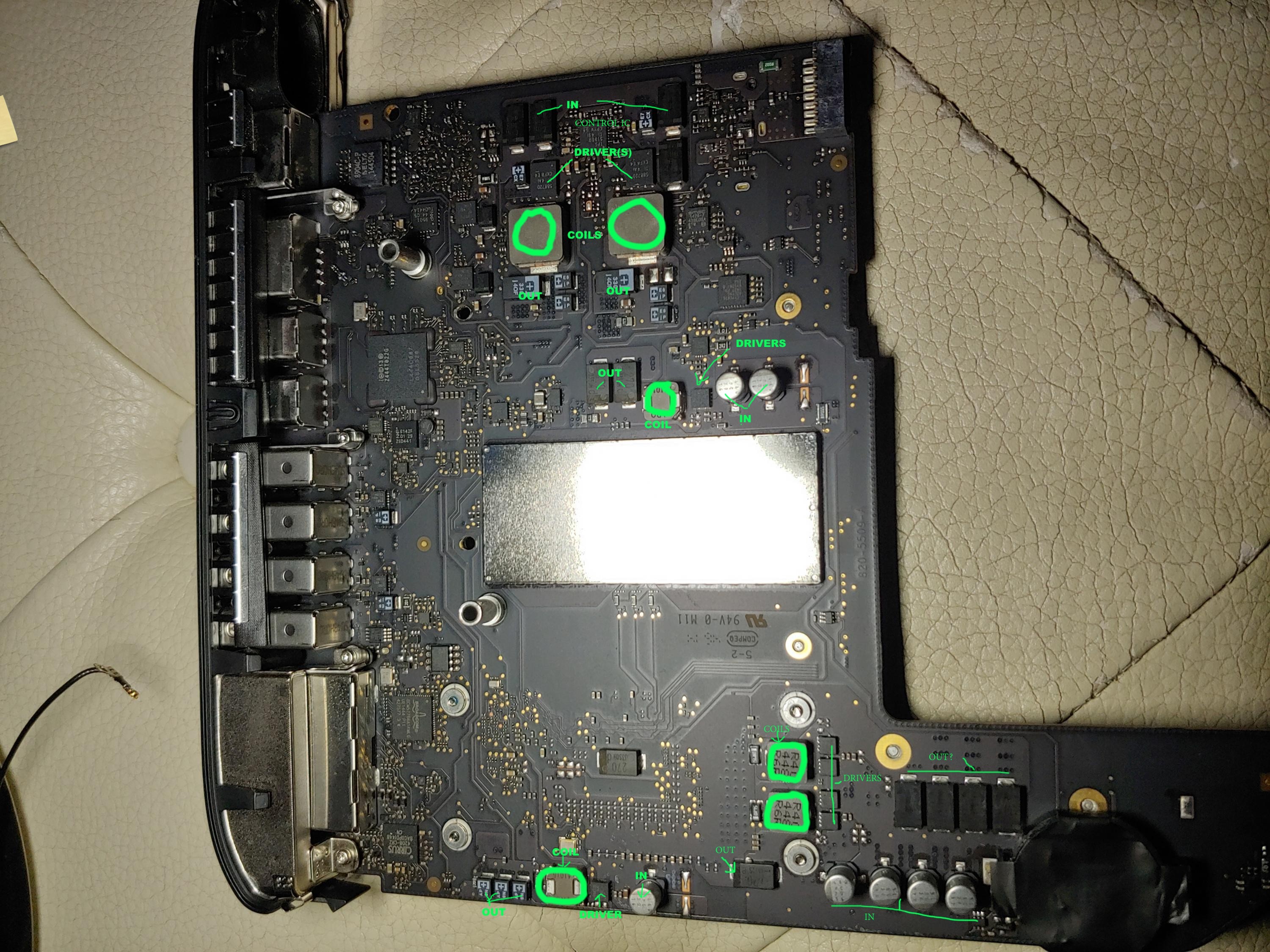

                            Here you go, this picture probably explains better what I mean. This is from a visual glance of your pic of the board only, so you need to measure voltages to be sure I am right. But this is what I see when I look at it.

                            • waakye
                              • Dec 2018
                              • 340
                              • Electronada
                              Hello dicky96,
                              Thanks for your help. I really appreciate you taking the time off your day and helping me out. I was able to take some measurements at the points that you marked on the picture. I have updated the picture with my findings.
                              I looks that I am getting 11.88VDC on the inputs voltages at all the points you marked IN. Unfortunately, the OUTPUTS are not that good. sometime I see the output measures 02.1mv and goes to 1.485v and goes back to 02.1mv. As they say a picture is worth a thousand words.
                              I have attached the picture.
                              Thanks again for your help.
                                No worries mate
                                So it looks like you have 12V going in and 3.3V but nothing else - most likely that 3.3V is the standby voltage supply, and your board is not powering up
                                The one that is going to 1.485V then back to zero, near as damn it, that sounds like it is repeatedly trying to power up then shutting down again.
                                Bear in mind some of the points I marked as OUT could be the ground end of the capacitors. Measurethe voltageat the inductors to be sure (if you didn't do that already.
                                Power off and check the resistance from each of the coils to ground. Are any of them reading zero ohms? In which case you have a short on that voltage rail stopping the board from powering on.
                                Hopefully someone with knowledge of Apple products will come along with more specific advice, I'm just trying to tackle this from a basic electronics standpoint
                                  Hi dicky96, thanks for replying.

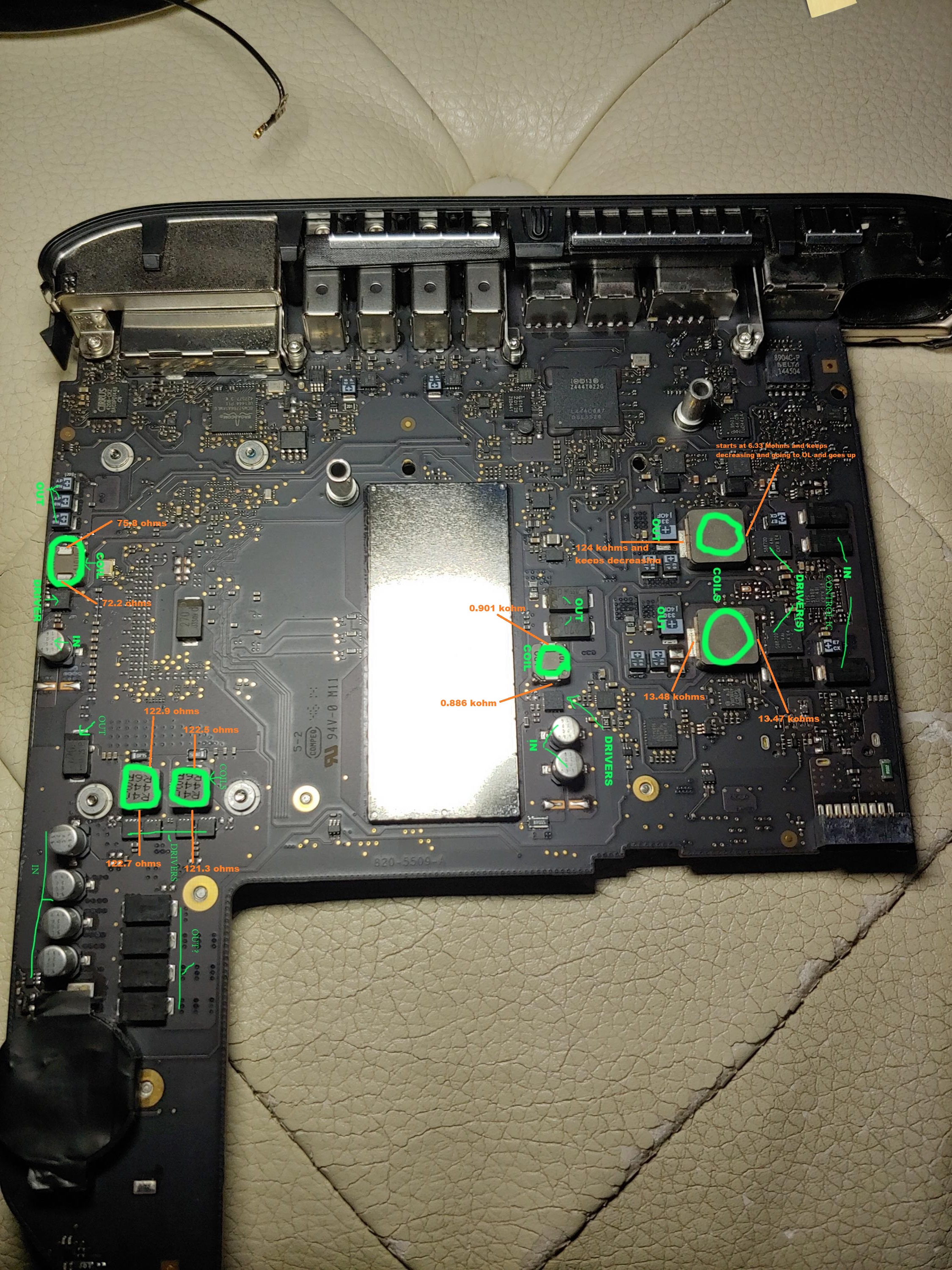

                                  I took some measurements of the Coils with power applied and also the resistance of the Coils without the power applied and below are my findings:
                                  I have attached pictures with notes on the resistance measurements of the coils and also with the voltages on the Coils points.
                                  Seems that the coil that was reading 3.32 vdc is also the coil that is reading open on the resistance.
                                  Please see the pictures with the notes.
                                    Well for sure an inductor should not be reading open circuit, but seeing as you have 3.3V on that one I can't see how it could be open circuit as that buck regulator appears to be working.
                                    If it really is open circuit then there is your problem to start with. You need to fix that first.
                                    You have no short circuit to ground on any of the power rails so it appears the board is not powering up (stuck in standby) or you do have a problem with that inductor.... but that seems illogical to me.
