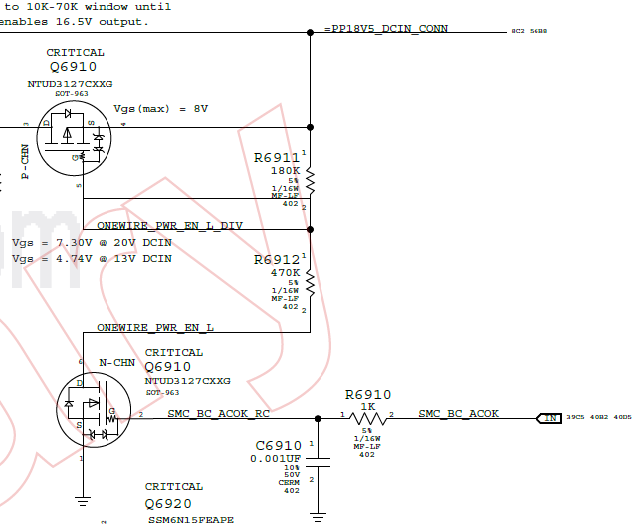

    Hi folks,
    I've been troubleshooting a new board I got. It's a 820-2327-A A1278 M97 with no power. So far I tracked down the problem to somewhere around R6911/R6912.
    Pin number 1 on R6911 reads 16.5V however the other side (pin 2) reads nothing. SMC_BC_ACOK_RC is at 3.3V. I can't figure how that voltage disappears.

        Re: A1278 Macbook no power
        Its normal that there is no voltage there. SM_ACOK_RC is 3,3V so this circuit is working. Mosfet Q6910 is pulling the voltage to ground because of the 3,3V on the gate of the mosfet. Pretty sure ur problem is not here
