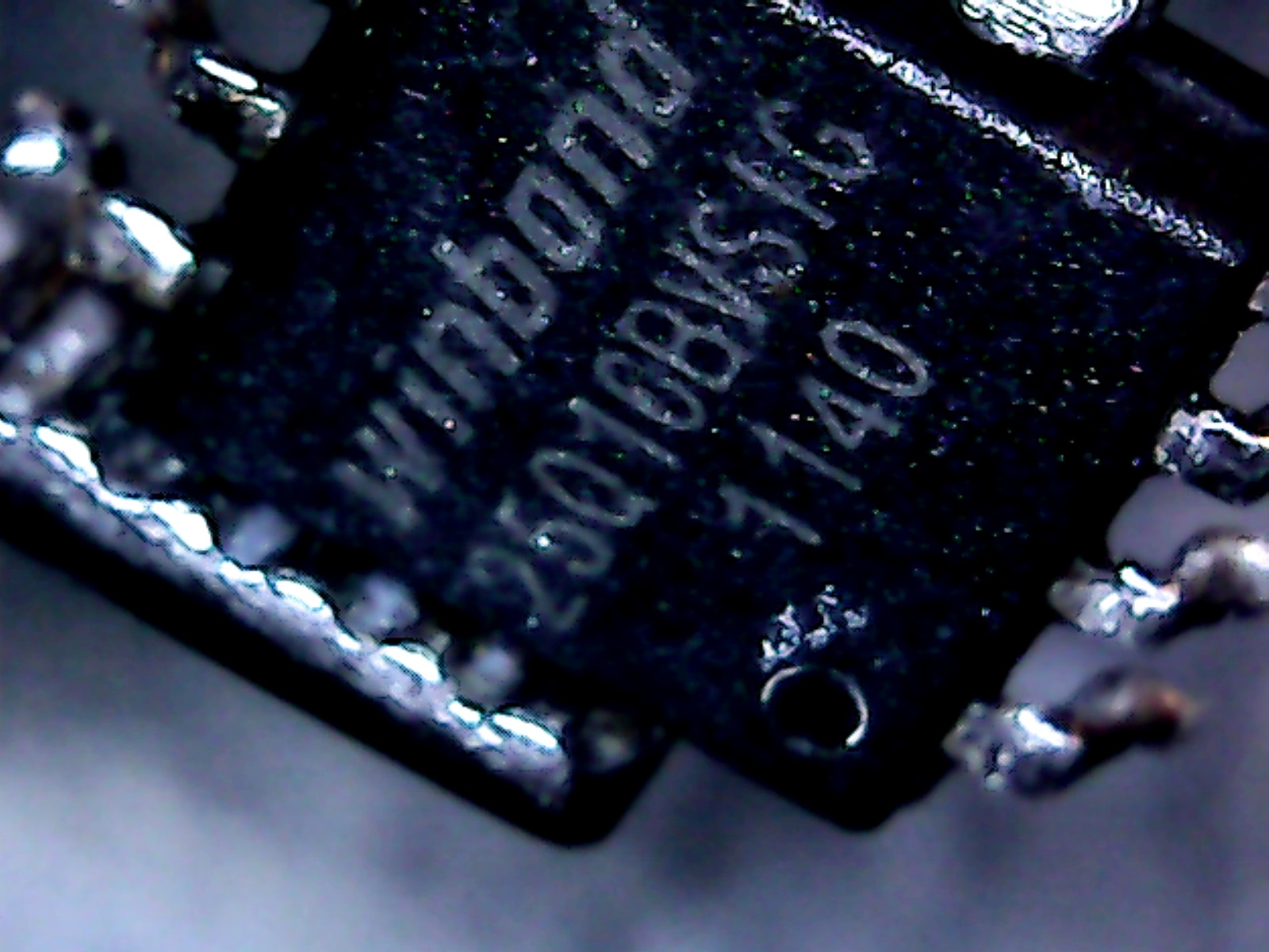

    Hello Badcaps techs!
    i come with a stupid problem.
    Not a big problem but its unknown for me.
    So let me begin.
    Yesterday i had a Hp 15 with no power nothing, no led , 0.
    I desolder the bios read it and try to write it back. Nothing.
    the ezp2010 can read every chip over 1mb but it can`t delete it.
    2mb 4mb 8mb etc. it reads the chip but it can`t delete.
    i`m installing on another notebook the device so i can take some picture and show you.
    the 1MB chip tough it can read it delete it and write it back.
    i do know the bios chips that i took down to test may be faulty but for frak sake i tested like 5 chips. i had 1 from a dv9000 with 1mb and it was ok because the board was massacre on bga chips.
    the Question is did you had any problem like this? to delete and verify it came back the data(its like it was not deleted).
    i`ll make some picture soon so i can show you.
    the time tough for deleting a chip its almost equal like writing.
    but with mine now its not even 1 sec(even lower) its like its doing a quick format not full format on a drive.

    It looks like the chip is locked like those from HP with Bios and ME section etc.
    They are also ignoring the write cycle. Does the programmer not come back with a error?
      • 31102
      Re: ezp2010
      get datasheets.
      i'm not sure about serial flash, but a lot of parallel flash you can lock the sectors.
      to unlock them you send unlock command or you put high voltage on one of the pins while erasing / writing.
      so maybe serial flash supports sector locks?

              Re: ezp2010
              so yes! all of he chips i had where dudu!
              starting from TV satellite boxes, dell M series, some hp g6 series.
              every single one i thing they are dead(can`t be delete) except for the dv9000 bios that work.
              today i manage to fix a hp envy m6 and after i finish finding the short i took down the bios just to test the ezp2010 and the bios chip its 4mb and it work normally .
              so i`m sorry for the trouble and maybe this will be a lesson for me about the bios chip even if its tv box LOL.
              i need a new stash of chips

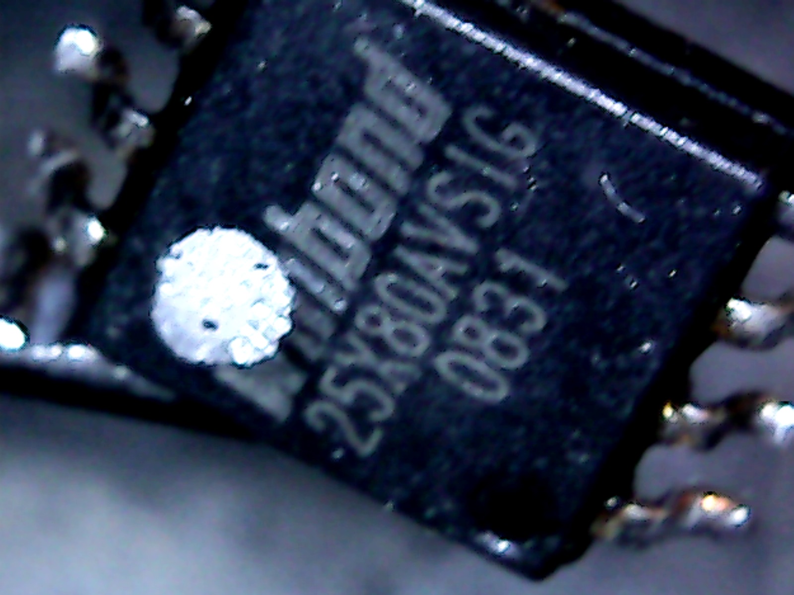

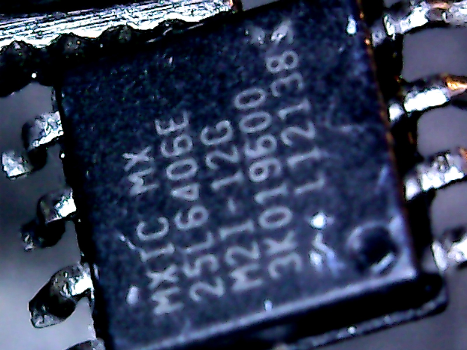

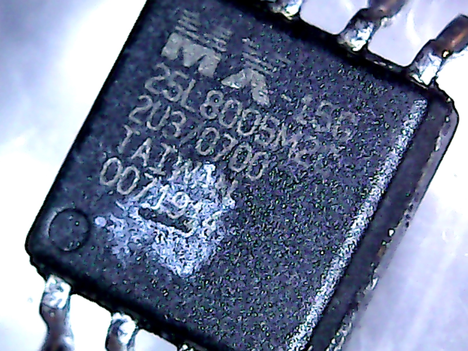

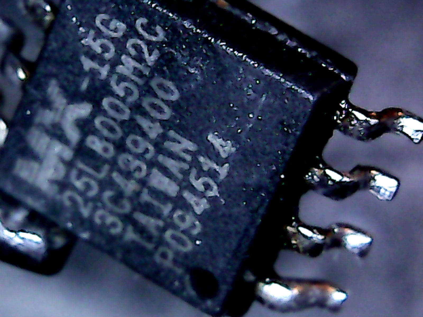

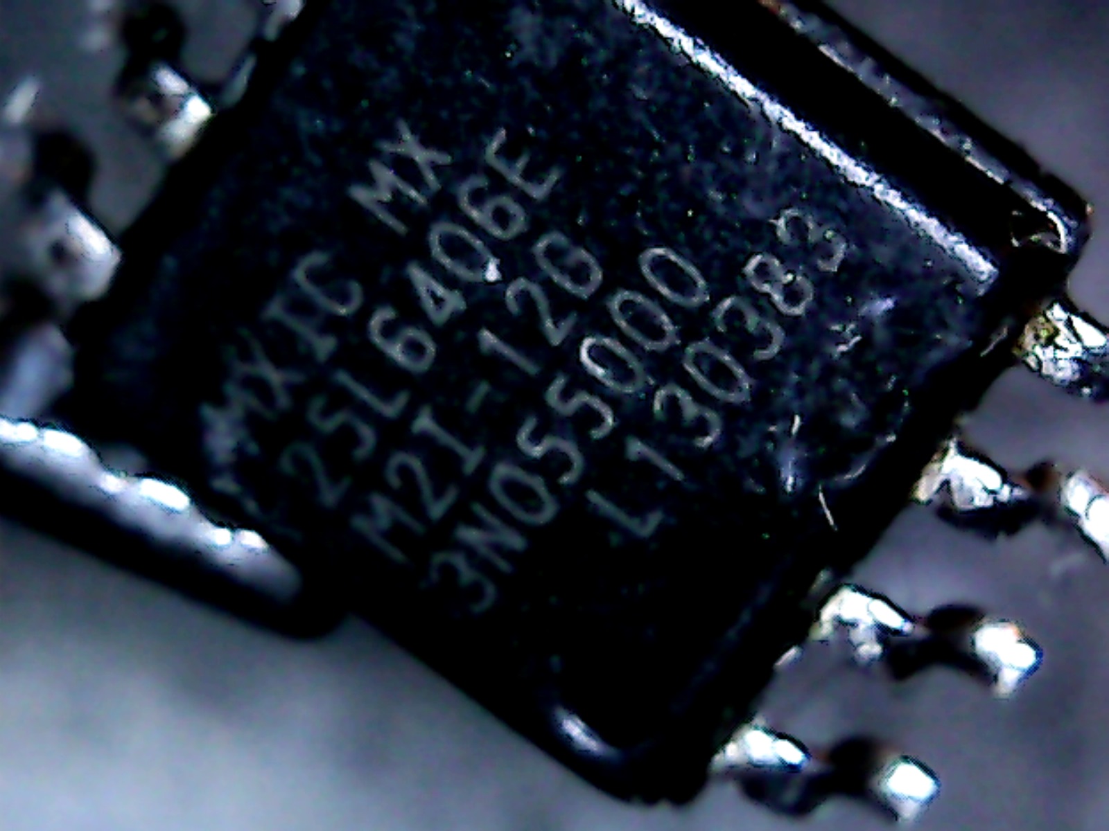

                    Re: ezp2010
                    those are all the chips i tested saturday and it made me think that the ezp its broken.
                    i can`t remember witch one its from where because it put them on a box.
                    i need to start recovering again a new stash of chips.
                    i got a lot of boards tough and i need other components to, but it takes alot of time to take them of, clean them and test them and label theeeeeeeeeeem.

                      did you use soic8 adapter? might be that was broken, and the programmer still good. try other soic8 adapter first

                        Re: ezp2010
                        I tested last night with a 4mb bios from envy m6 and it was ok
                        Maybe i was lucky with my soare stash of bios chips.
                        Bad luck maybe? And maybe thats why the boards ended up for spares.
                        Should have made some pics of the boards to see some pro techs(from london) what they did with those boards.

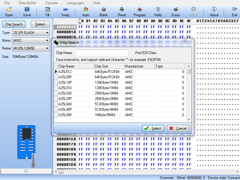

                          • 31102
                          Re: ezp2010
                          reading some datasheets, it's probably what i said.
                          look at page 11.
                          sector based "read only" protection mode.
                          • dj_ricoh
                            • Jan 2013
                            • 2073
                            • uk
                            Re: ezp2010
                            wow.
                            i`m such a fool with a big illusion that i'm progressing
                              • 31102
                              Re: ezp2010
                              your programmer probably has an option to set or clear those bits.
