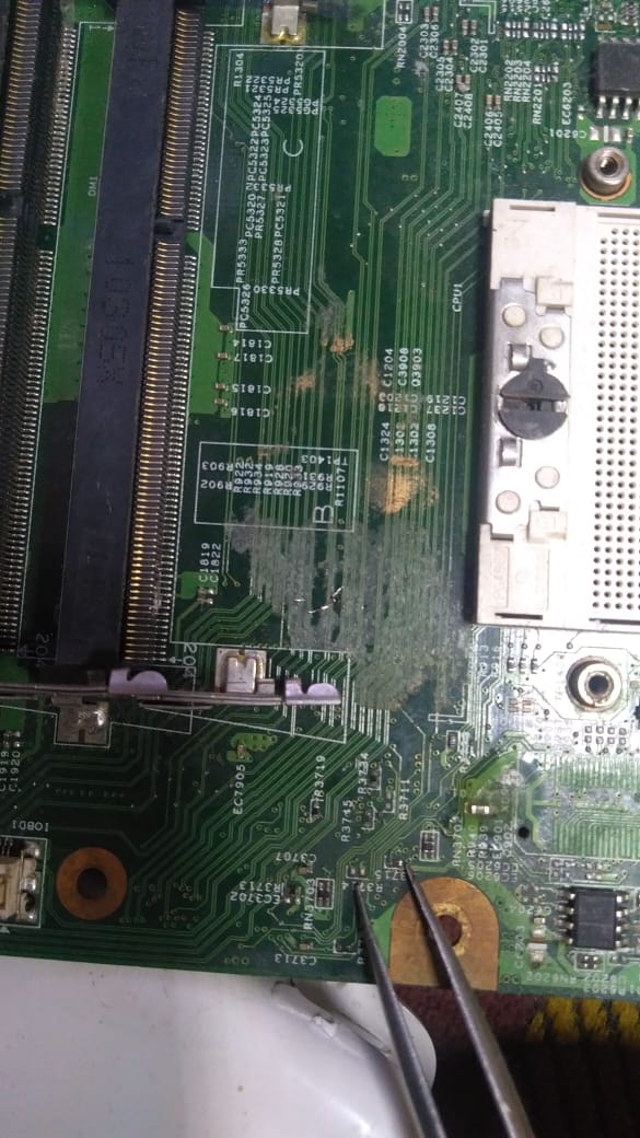

                      2-I saw in net some one converted from graphic version to non graphic but without jumper
                      if some one try such method please advice
                      best regards
                      Hello friend,
                      recently i converted an N5010 board using Dr. Bios way.
                      It works only for laptop's display, not HDMI's or VGA's outputs.
                      Now i am trying to resolve this too.
                      Check the attachment.

                                          I did the conversion according to the photos of Post#110. I double checked all the new components and they were correct.
                                          All voltage rails are present. Graphics-ralated voltage rails are provided to PCH. The Bios can detect presence/absence of RAM but it stops when it tries to start the Integrated Graphics. That is why the screen has neither data nor backlight. Then, the laptop does nothing but stays on while the fan speed is controlled properly.
                                          Compared to the time of Discrete graphics, now that PCH has the GFX_Core voltage, it gets about 20 degrees hotter.
                                          I have tested both the UMA and the Discrete versions of Bios and EC firmware in the following thread but no signal changed:
                                          https://www.badcaps.net/forum/showthread.php?t=84754
                                          Now I do not know whether the problem originates from wrong vBios or defective PCH. what is your guess?
                                          Note: I wonder why none of the successful technicians in this thread mentioned any Bios reprogramming. Maybe, the original Discrete version of Bios contain both vbios of ATI and Intel graphics. Am I wrong?
