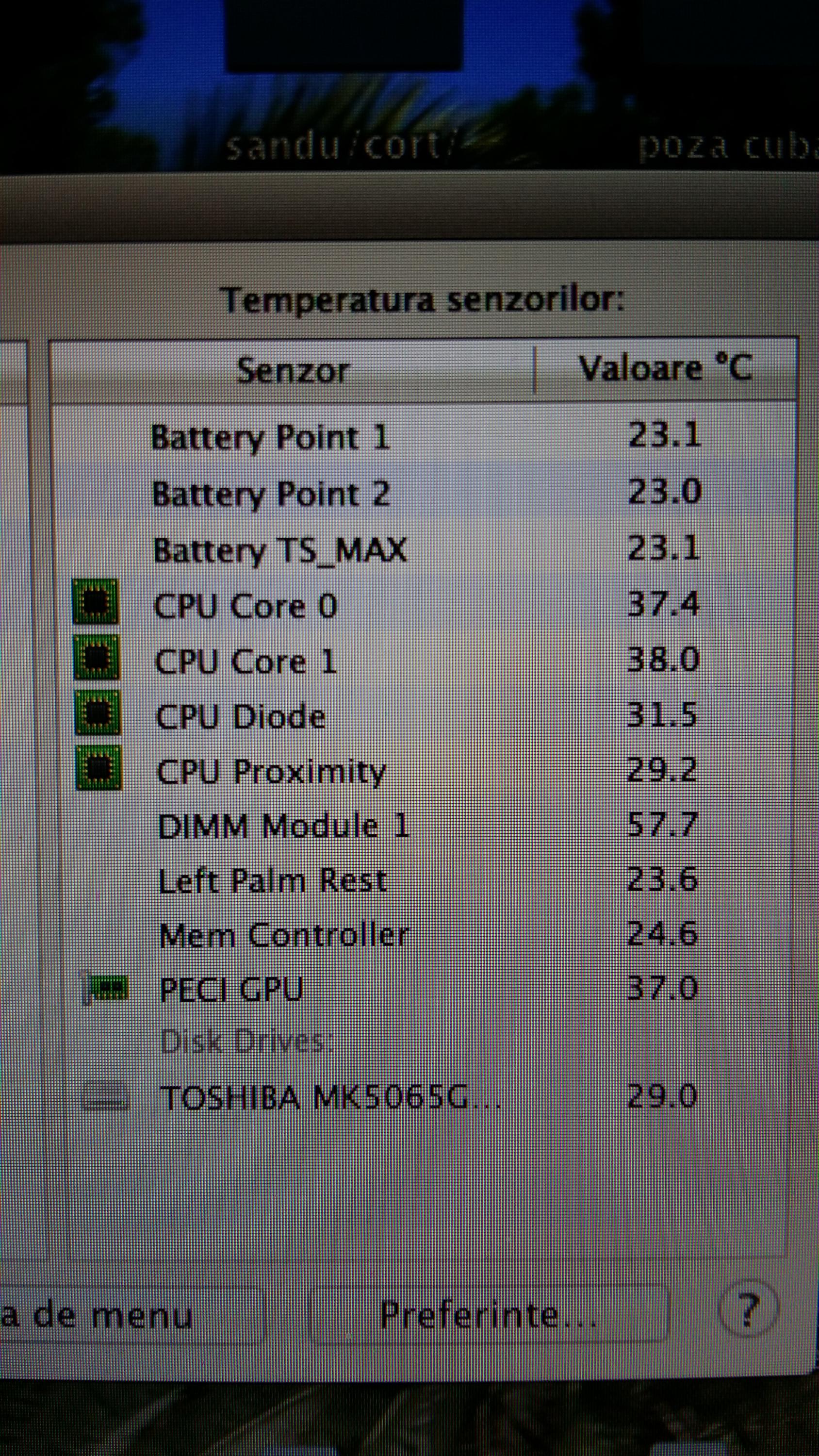

                Re: Apple Macbook pro A1286, wery slow
                here is the temperature, sistem have like a lag, and fan full speed
                can give a link for this program ?
                board is 820-2915-b
                graphic 216-0809000
                  board is 820-2915-b
                  graphic 216-0809000
                  I'm out at the moment but I'll try and remember to post when I'm back. It was a torrent if that helps at all.
                    thats seems bad gpu KTM , specially macs are week in that behaviour , usually once gpu start to fail all internally start to fade out as well , the best option you got here is to replace the gpu KTM , also make sure you insert same chip , if its 128 bit USE 128bits , or you might have future issues
                            im mad, becase before reflow, or reballing, the fan works normal.
                            or how can i modify to run only processor graphics ?
                                    fan is controlled by smc. have u done a pram reset after reflow or gpu reballing ?
                                    when a pc is slowind down generally it's intel chipset. (had an hp notebook that was slowing down and after a day it went dead. after reballing these small intel bga it went back ok to normal.
