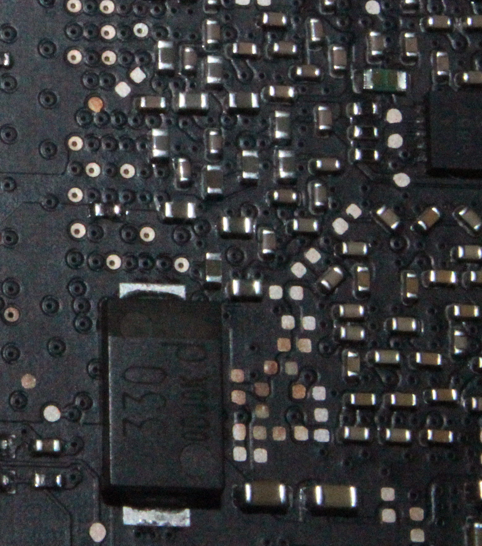

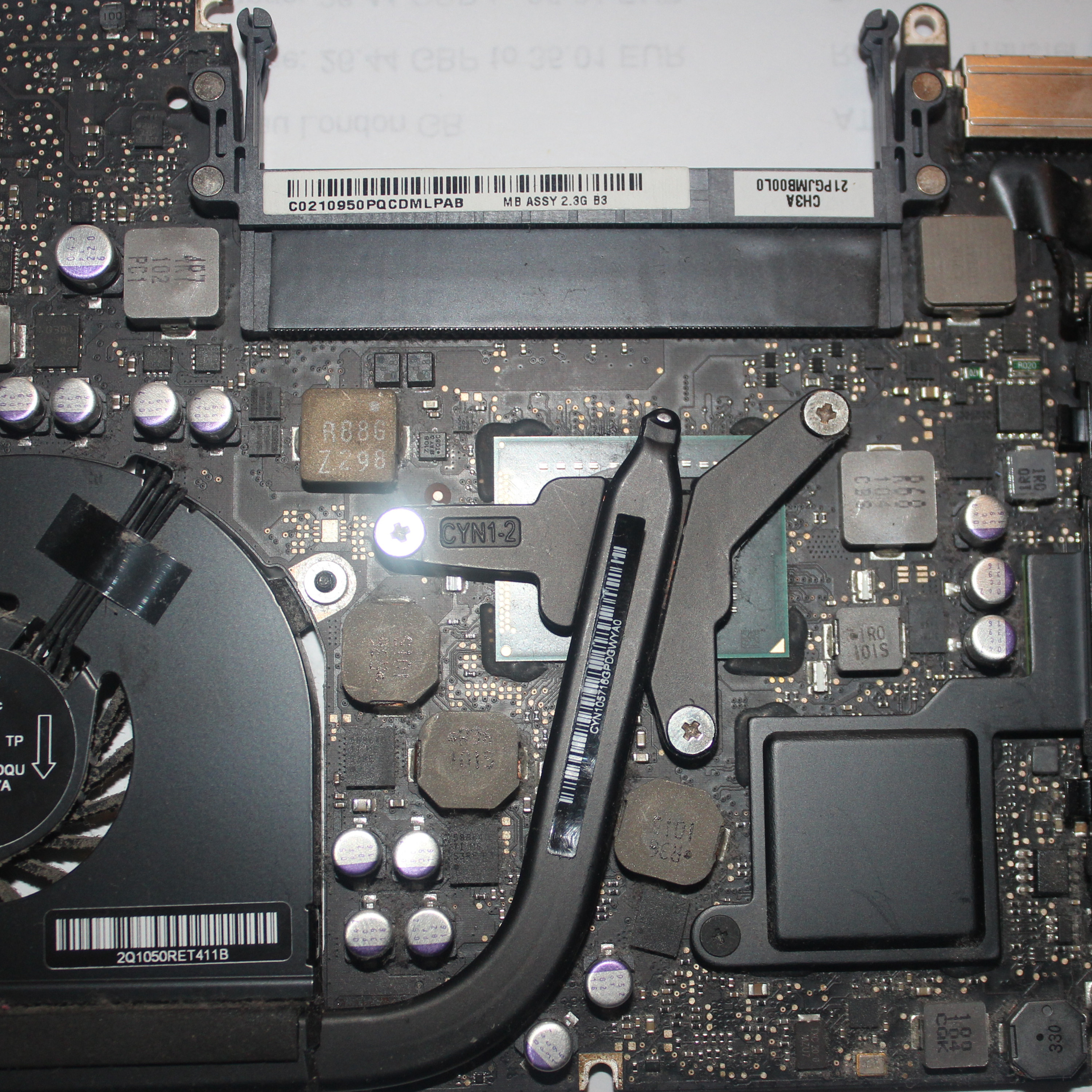

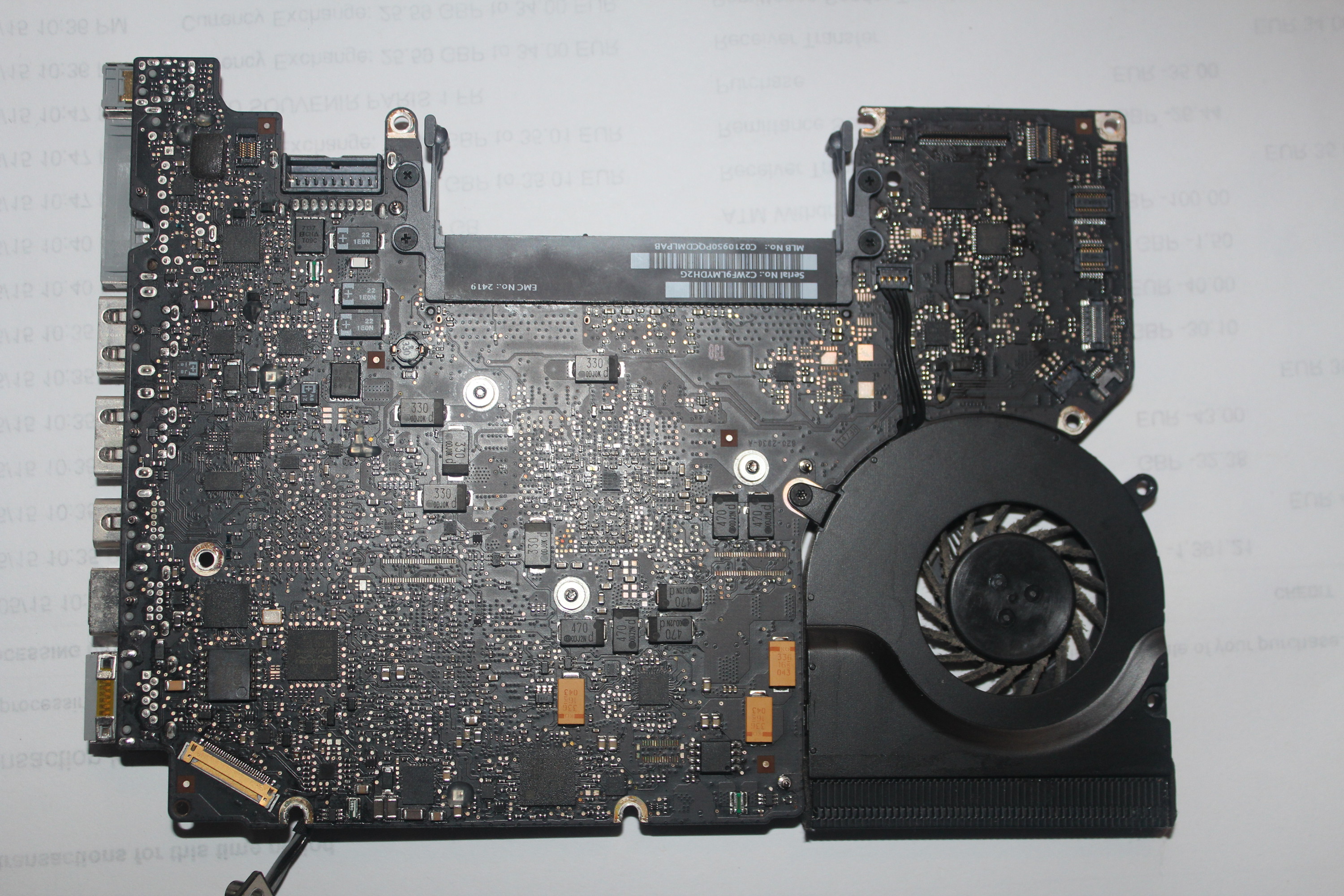

I fixed what I thought was a simple problem with the battery in a friend's A1278 (820-2936-A). Dead battery, new battery installed. Everything was working fine while I reinstalled the OS (which was corrupted), but about an hour in, the logic board died completely.
While I have the G3Hot supplies and the charging circuitry works, the other rails appear dead. What's more, there appears to be a dead short from PP1V05_S0 to GND (multimeter reads 0.5 Ohm, the same as from ground to ground). Removing the relevant inductor, it seems the short is on the CPU side, not the power side.
Furthermore, looking at the logic board there does seem to be evidence of burned out pins near the CPU (see attached).
Is there hope for recovery? Is a dead CPU more likely to show up as effectively 0 Ohms, rather than a cap? Something else in the circuit I should be looking at?
Alternatively, as this wasn't my board, is there evidence of what happened? It can't be a coincidence that the laptop died at the exact time I was testing it after a repair, but if I messed up the repair I'll make it right, but if the board was on its way out and died on my watch it would be useful to know. If it's relevant, the hidden RAM module was loose when I disassembled it further, but I didn't think this could cause a short. Do logic boards commonly burn out like this?
