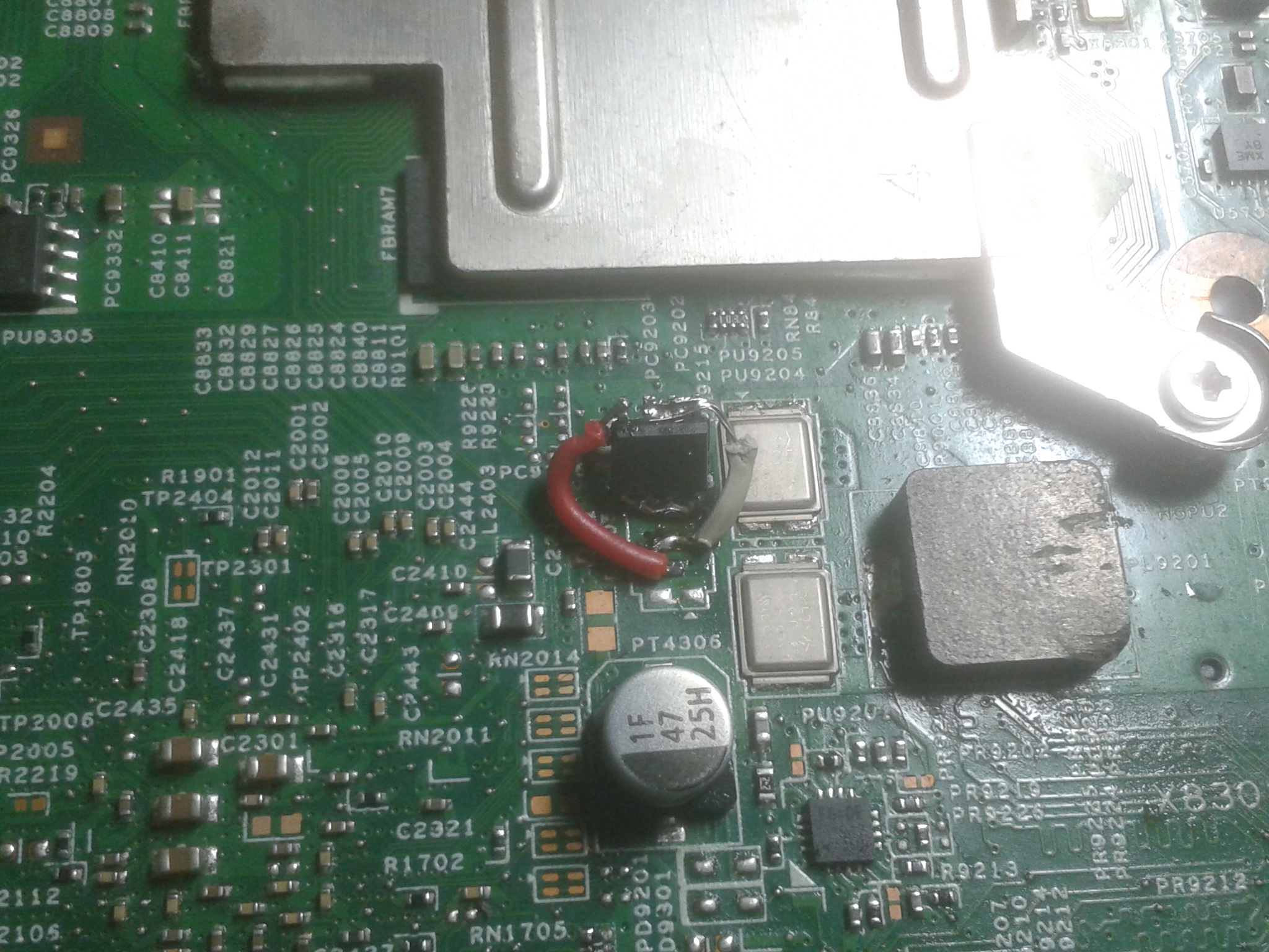

    Dell N5110 short
    As power applied by adapter ,adapter led turns off.did't find any short
    power rail at Gpu shows a 3.6 ohms at coil PL9201 .
    is this is correct or not.
    I also want to open coil and give some other kind of load &chek voltage across coil pl9201.
    Did any one did it.
    Thanks.

    Re: Dell N5110 short
    I was thinking you should check pu4002 and pu4003, as well as any high drive mosfet in each regulator first.
    do not forget dc connector should also be checked
      i have tested all mosfet. how much ohms should it show.is mine correct or abnormal
        I have disconnected gpu coil & given some load & found full board is on all coil showing power at the gpu coil showing around 18-19 volts & main board stays on .how can 18 volts come here.
              too high... maybe shorted upper fets

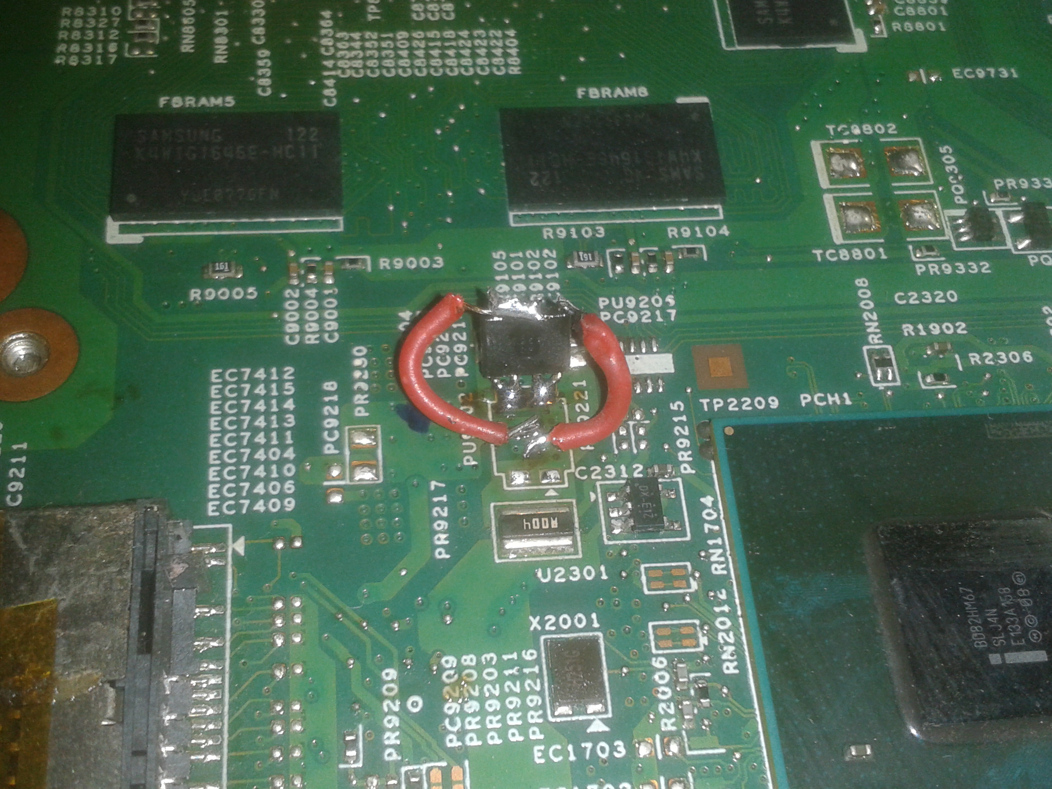

                Fddizon you are correct. Thanks
                both the fets defective .
                but i am unable to get same type & no fets
                so replaced with black fets.(FDS6676)
                which are working fine and display also comming .They are not heating also
                Is it advisable to use them .also attaching images of both sides.
                  i think they will work the same. if you can fit them without shorting that is fine...
                    NO THAT IS NOT FINE! IT LOOKS LIKE SHIT!
                    Hate this "gluers". Why dont u put in some other mosfet. its normal N-channel 30V 12A mosfet. IT IS IN EVERY NOTEBOOK w DDR2.
                        '' Lol '' ktmmotocross
                        This i have just done for testing . how much it is heating.display comming or not.
                        If you dont like it why are u saying to use other mosfet from ram area DDR2 coz that will also be glued.
                        LOL
                        • ktmmotocross
                          Boardkiller
                          • Feb 2014
                          • 3582
                          • slovakia
                          fot testing ok, not for using.
                          ddr2 ram area dont have that high current mosfets. its in cpu, vga or main power area
