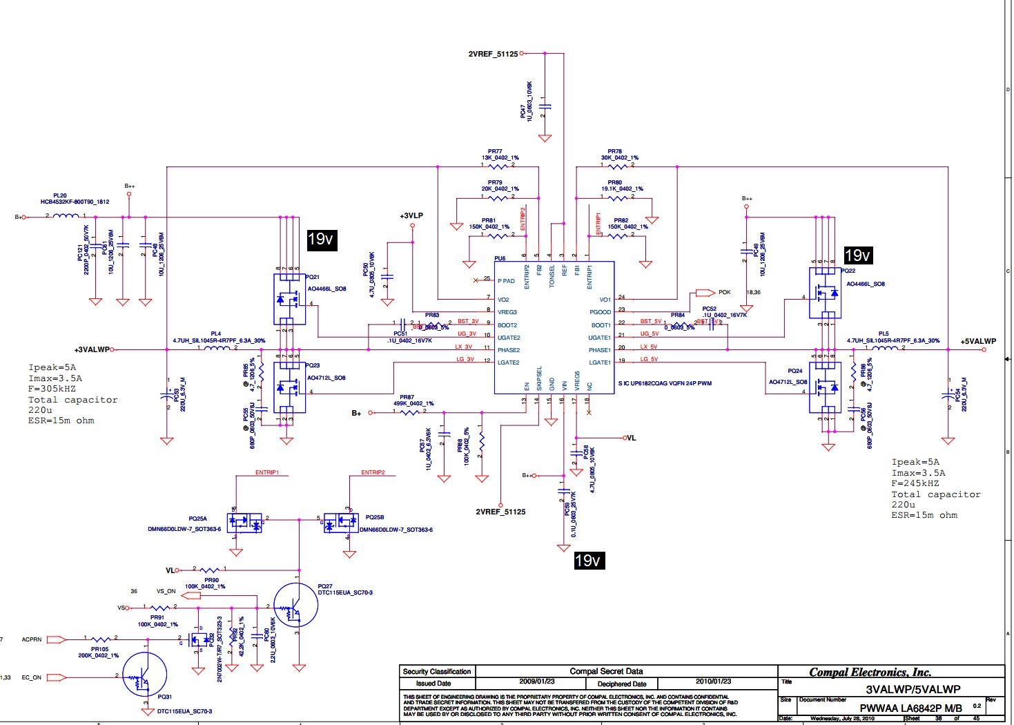

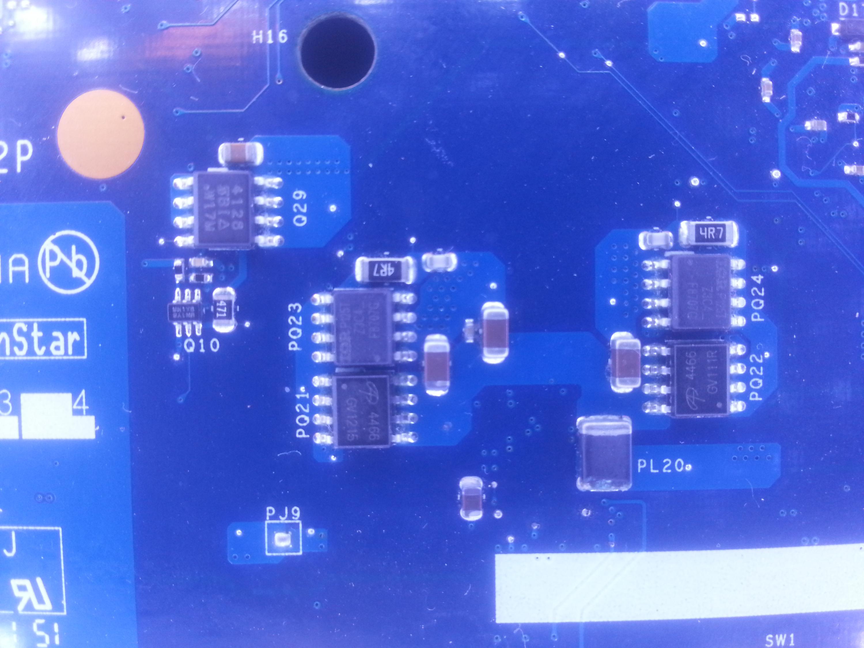

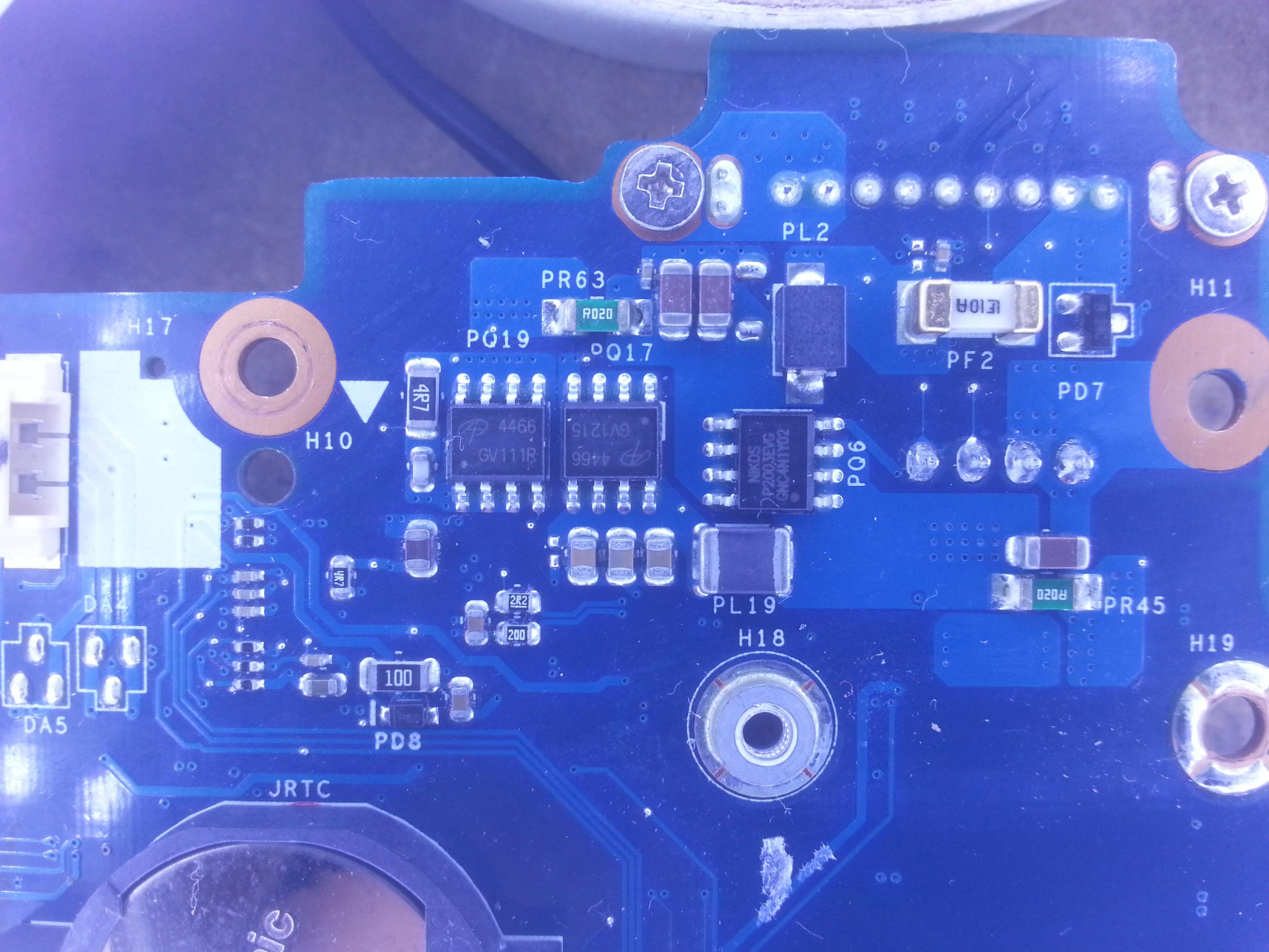

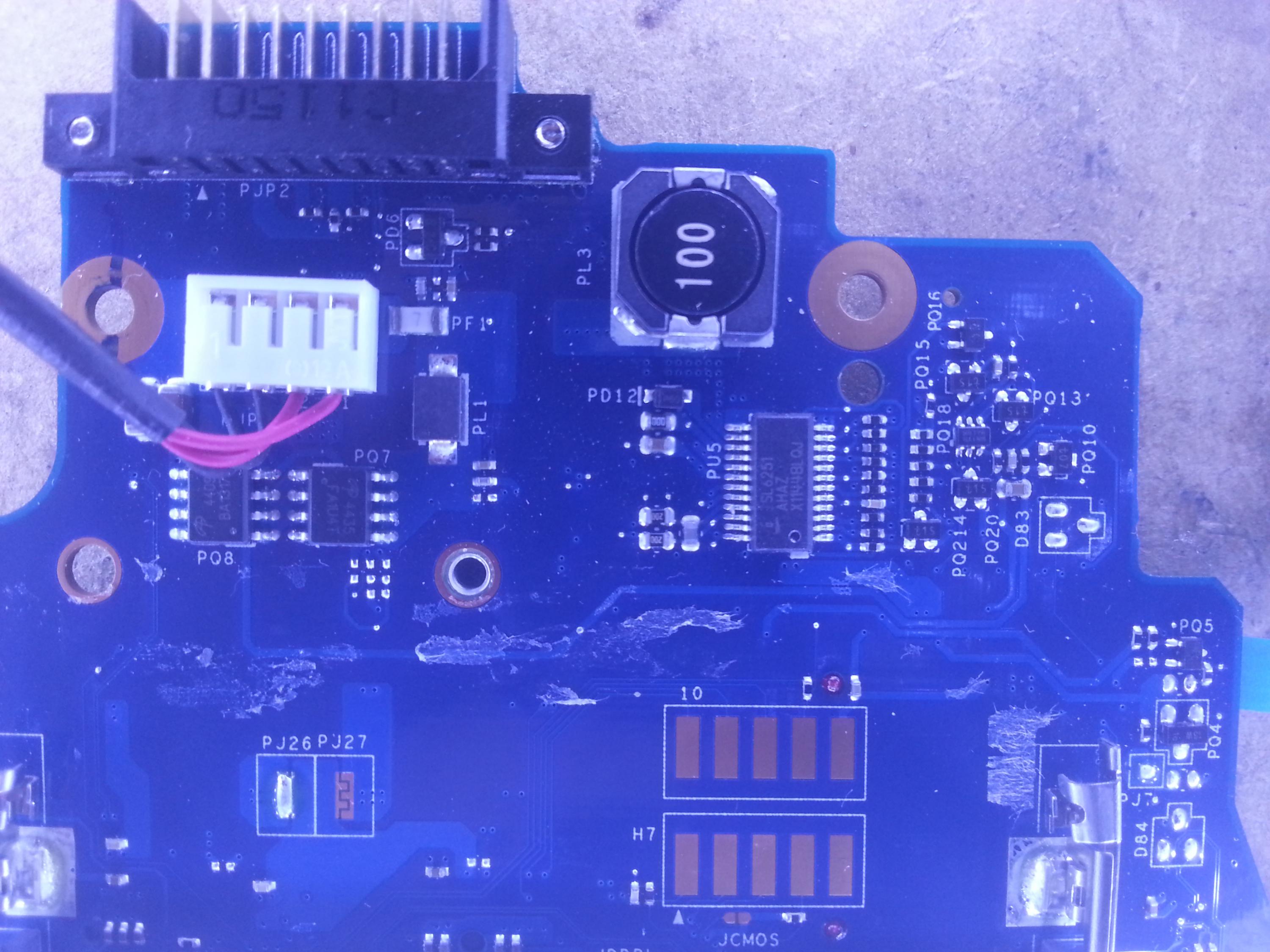

    Hello, i have a Toshiba C660 with motherboard LA-6842P.
    There's no lights or fan when i power with my bench supply.
    No voltage at the power switch, but i have tested it is working.
    I can find 18.90v around the charging section but no 3v or 5v.
    18.9v is also present at PQ21 and PQ22 but there are no other voltages.
    Is that suggesting PU6 ?
    Any other suggestions ?
    Thanks.

    Re: Toshiba C660 no power
    First check the rails for shorts to ground. PU6 could be faulty or many other things around it. Download it's data PDF to discover things to check.
    pin13 needs to see 2.4v or higher.
    Also check for any movement on the rails as you apply power. I had a fault in a Samsung that was causing the ALW5v to go higher than 5v at power on, then drop back to 0v, all in a few milliseconds. Need a CRO to catch this.

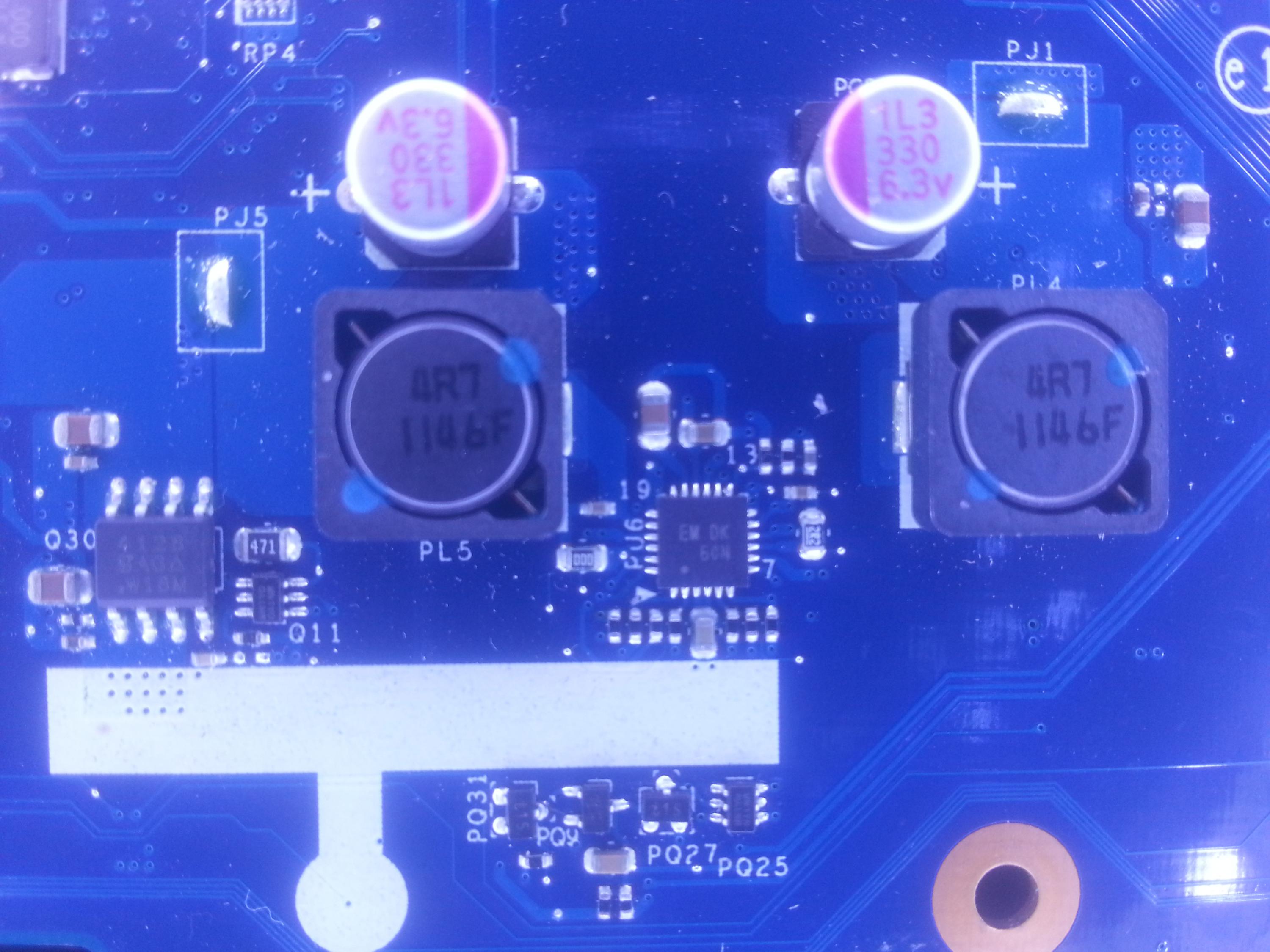

      Thanks rievax, i only get 1.7v on pin 13 of PU6.
        There could be a fault with the resistor divider. Also check for 19v on VIN pin16. avoid measuring this directly at the IC pin. If your probe shorts to an adjacent pin, you will have more trouble.
            Can you advise me where to check for 3v and 5v ? I am unsure which component/s convert the 19v down to the lower voltages.
            • rievax_60
              • May 2012
              • 897
              • australia
              Did you see the data PDF for the UP6182? There are 2 sets of regulators, linear 3.3v and 5v, and SMPS 3.3v and 5v. When power is applied and before the power button is pressed, the 2 linear regulators, pin8 and pin17 should be up. When the power button is pressed, the 2 SMPS rails are supposed to come up. These can be found at the 2 coils, PL4 and PL5.
              pin13 EN needs to see 2.4v or more before anything else can work.
                Thanks rievax, i'm fairly new to diagnosing and reading diagrams.
                I have downloaded the pdf and now understand a little better.
                I only have 1.7v on pin 13 can you tell me where that feed comes from ?

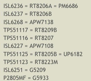

                                      I bought an identical faulty board to swap components from to try and fix this.
                                      On power PU6 gets red hot instantly so i was going to replace.
                                      It is marked 51125A although the schematic indicates a UP6182.
                                      I've done a search on here, that indicates they are compatible, is one better than the other ?
                                      • meritosari
                                        • Oct 2010
                                        • 774
                                        • Indonesia
                                        yes you can change with that. i think its same quality
