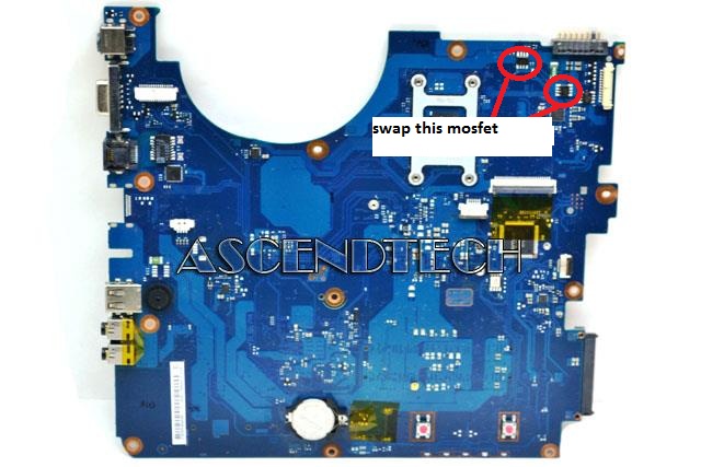

    please help, samsung np300v3a plugin fully battery charger, unplug the charger immediately die, note "the new battery

    i think the battery mosfet is bad try to change it, and try to swap the two mosfet if you are unable to buy a new one.

      even new battery can be totally dead not chargable. seen it many times.
      but i suggest u to check charger ic pins

        Change Or check Power adapter ,(using bench power supply Instead of adapter )
        Download Schematic And check Charger IC And Components (Mosfets , Caps , Fuse ,...)
        Check Voltage On Charger IC

          thank U all for your respect, I'll try to replace the first mosfet,

            why replace? u must check if is bad. do u want to replacing all parts on board until u find one bad?

              it's easy to change one mosfet, but it's difficult to change charging ic, my answer was based on my proper experience, because i have repaired two laptop with the same problem (platform scal 2 and scala 3)

                its easiest than check it for error?

                  Your problem is one of the components

                    thank you this is very helpful, I replaced all like the ones in this picture and the problem is complete, hehe, I am still in the learning stage repair laptop world, so my knowledge is still very low on a more detailed examination of each of each component, with the help of the master here I say a thousand thanks
                    thank you all
