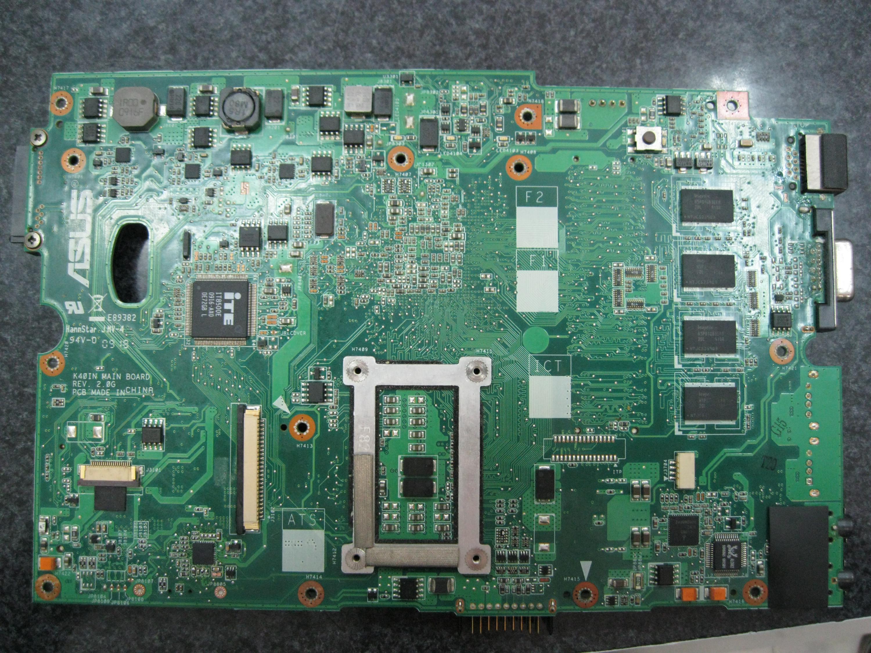

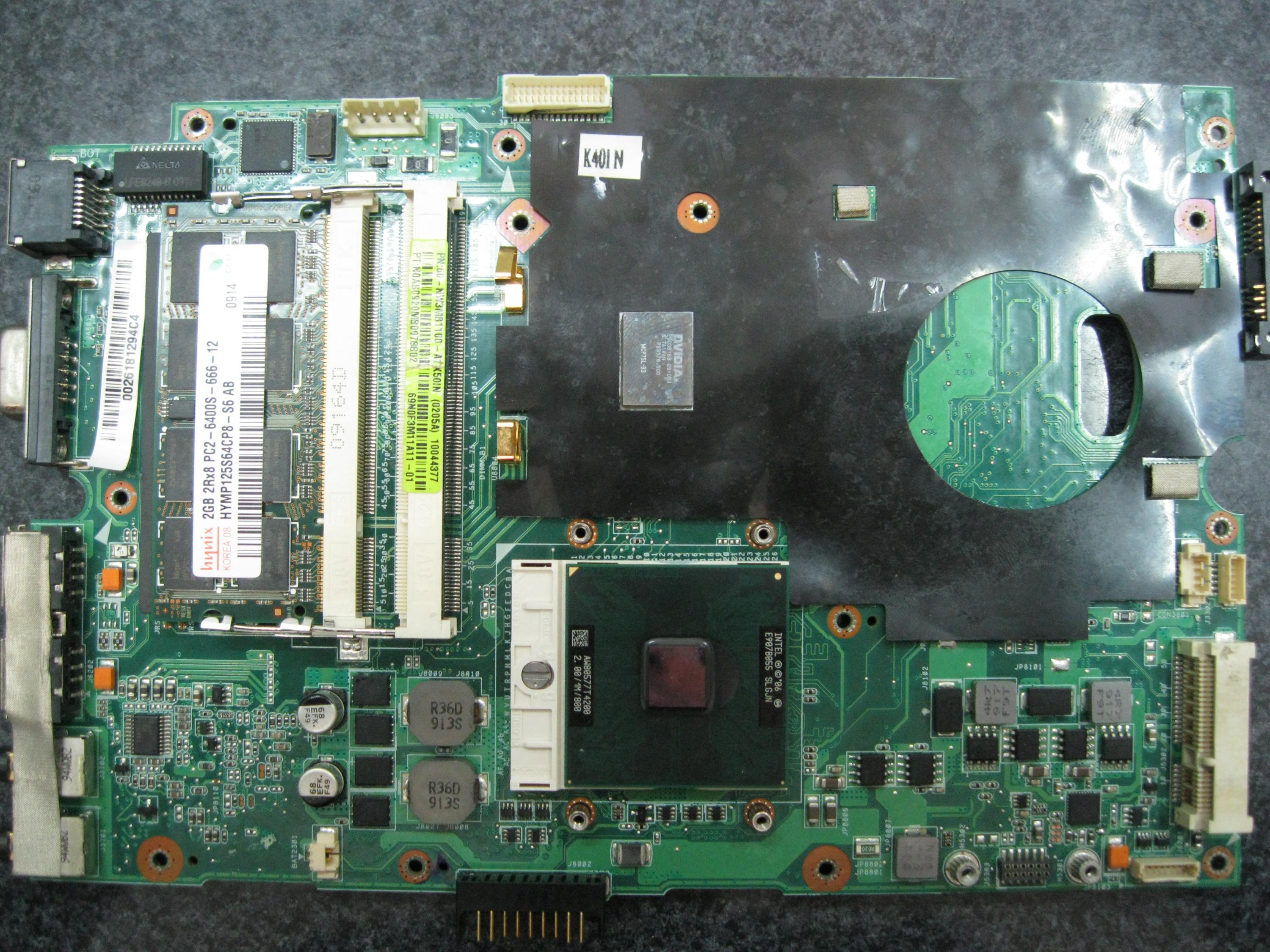

    Well received this board , sayng it was not charging they had changed few times system charger since they had some used ones .. until they damaged the Core line for bath making 19volts line fucked up , fix the 19 volts line , and i've got in back alive again .
    So i got for pin 1 and 2 12.95v . pin 3 and 4 GND , 5 and 6 - 3.30volts . pin 7 i got 0.17 volts online . all the outher are GND ..
    i've been trying to follow schematic but ... unfortunetly there is no ID on board to follow easy , shouldn't pin 7 higher ?
    i'm gonna add here the schematic , page 60 is for bat terminal ..
    any taughts will be welcome
    cheers

      ops forgot the schematic . tomorrow once i arrive to work i will add the schematic and pictures of both sizes of the PCB .

        well like promised here it is the pictures and schematic ,

              there are a few zinner and a main bridge but all values are ok on pin 5 6 and 7 without battery , when battery is inserted pin 7 drop to a very low value . this voltage come from KBC

                fixed , there was a problem, on small component on the main voltage rail

                    Re: k40in not charging
                    one of the 2 fets on the main charger system , they are 2 near a tantalum capacitor and near the coil . you can see on the pictures i've posted
                          i tough could be that bridge , but was ok after testing it . in the end there was a leak on the mosfet for charger line , and also system charger was getting more hot that usual , a possible fault caused to the outher store , replaced and have done something with the board since it was in total short when came to my store . but working and charging now thk anyway guys
                            cyberhack and it was diferente , BAT_IN_OC , was total oposite , high value without bat and low value with bat
                              but also would be not easy fiding does components since this board have no ID at all , ad not seenabl were the trace goes frmo the bus lines to see where were the Diode and bridge section
